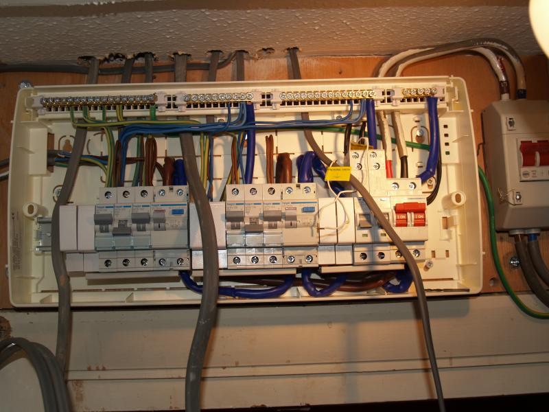

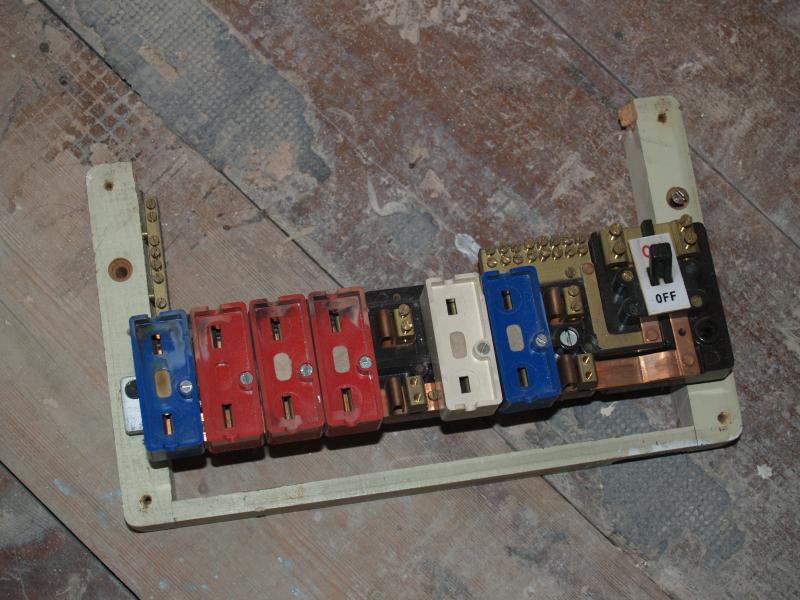

Well - since I finally achieved hot water, we decided to move in despite it still being a bit of a construction site. So it was time to go out with the old...
And in with the new. Here's work in progress...
Look OK? Still a few more circuits to wire in and a list of other things that need sorting...
1. Still using the old 16mm (I assume) tails, though main fuse is still 60A so not too big an issue I don't think.
2. CU earth is currently some 10mm left over from main bonding, so needs to be done in 16mm.
3. Stupid too short RCBO functional earths need extending.
4. Labelling etc, though not sure how well labels for the terminal bars will stick over the existing relief plastic numbering. Wish it had a flat panel like the Wylex they're touting in Screwfix.
I do have another little question: On pictures here and elsewhere, I've seen RCBO functional earths either sharing the earth terminal bar position with the circuit CPC, or in a seperate terminal dedicated to the functional earths. Any reason for going one way or the other?
Cheers,
Liam
I tend to put functional earth wires in the same terminal as the corresponding CPC. This makes it easier to remove one RCBO at a time. Doubt it makes much difference though.
those blue neutrals look rather mangled.. what have you been doing to them?
couldn't you muster some 2 x 2 plastic trunking to fit above the board? or some large mini-trunking?
Do you mean the neutral link wires (I hope you dont think my circuit neutrals look mangled :oops: )? If so, those are tri-rated cable (apparently) with a loose fitting silicone sleeve. They dont hold a bend so are a bugger to get looking neat. Whatever you do do to them, the loose sleeving wrinkles up like slack socks. Might just have to live with it, unless you've any suggestions?
Liam
Don't worry about it.
Any reason why the meter tails are in new colours, but the tails between the isolators are in old colours?
I had N-power out to swap the old mechanical meter, upgrade the meter tails to 25mm and fit an isolator (all free of charge :) ). He fit the old cu tails into the isolator and I'm currently still using those with the new CU.
Hmmm some trunking might have been nice for those cables at the top, although I'm still probably going to cupboard over the whole lot to cover the old cut out etc. If I dont (and maybe even if I do) I'll definately cover those cables up somehow. Still, doh that it's too late to simply use some mini trunking.
