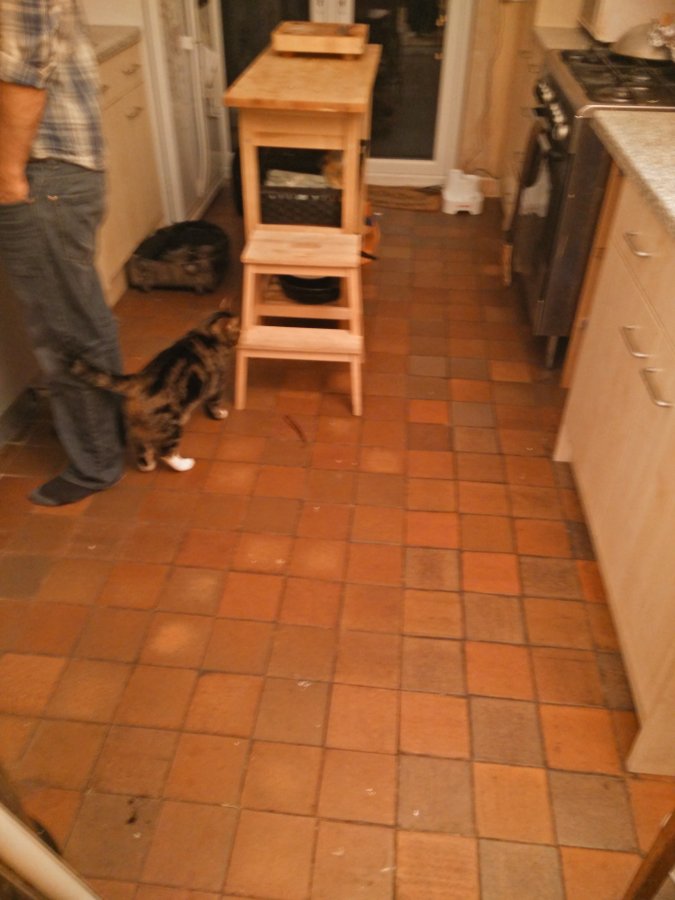

The floor as a whole:

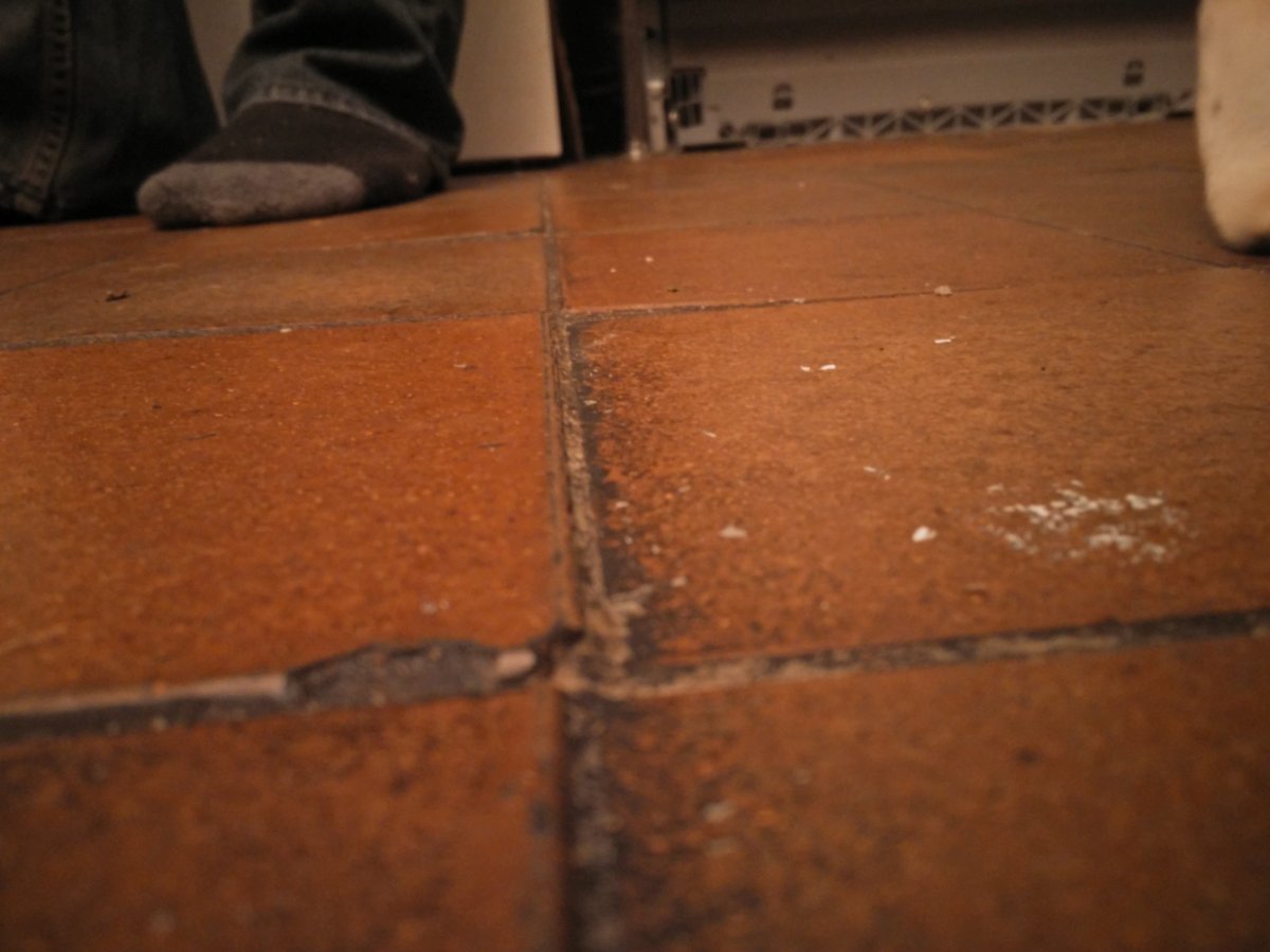

A close up of how uneven some of the tiles are in relation to one another (this is a few mm) (there are also some loose tiles that I didn't photograph)

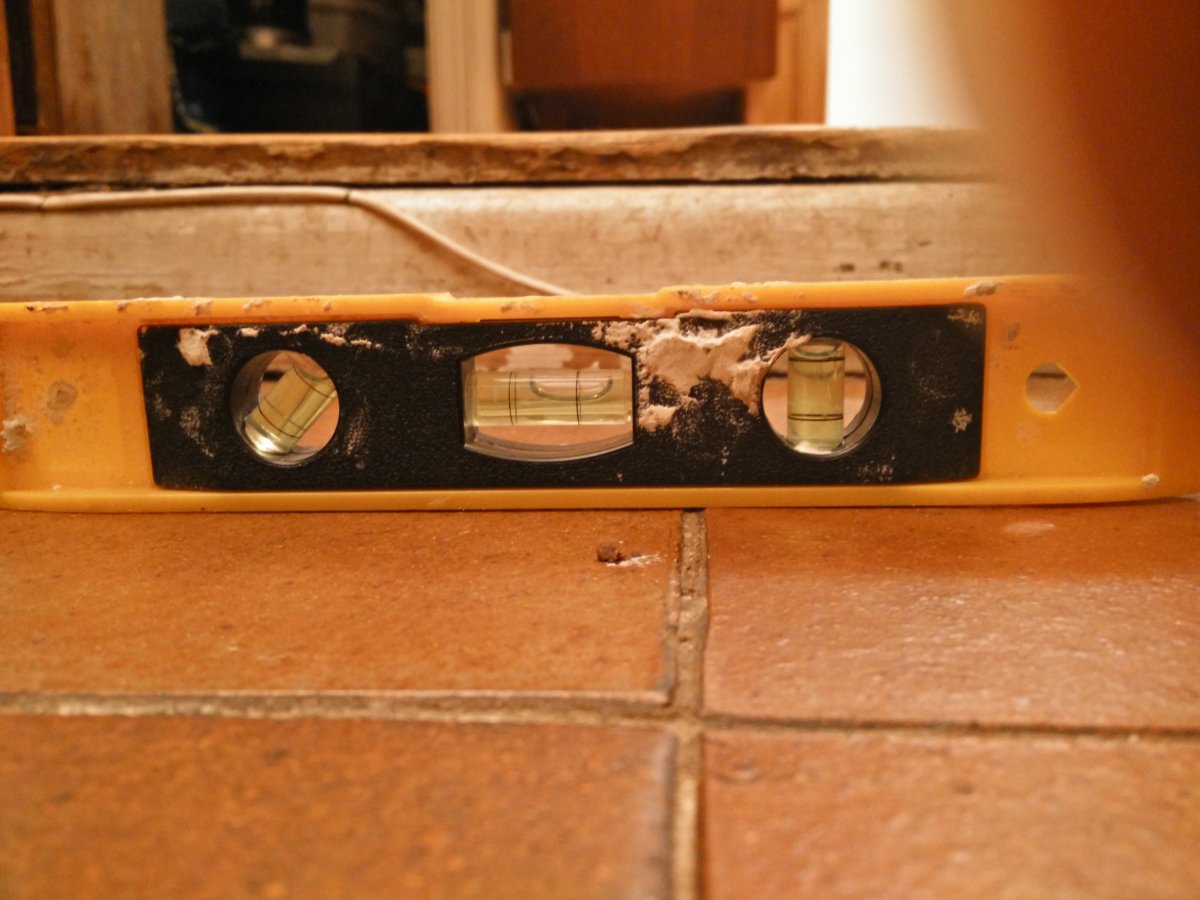

Spirit level by the door (this part appears quite level)

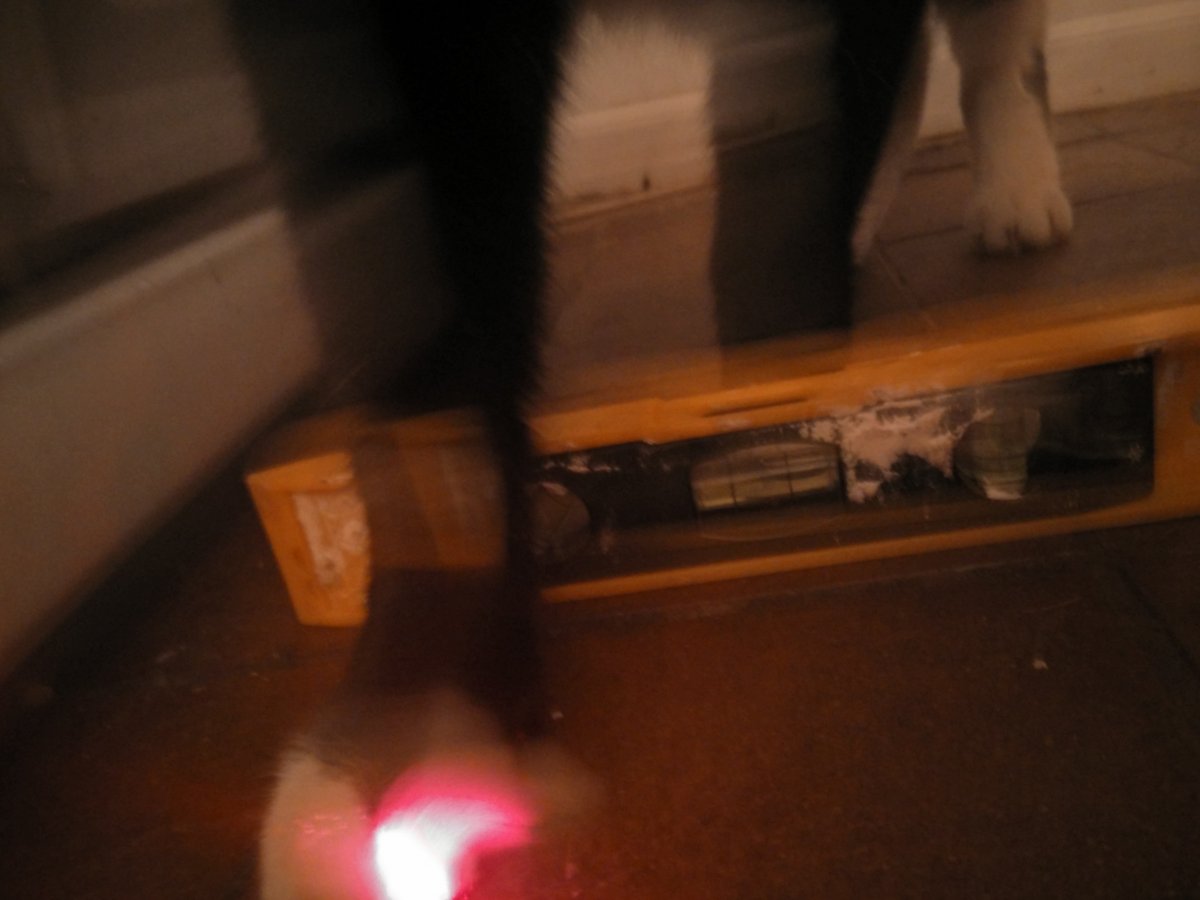

This is the slopiest section, where the old door was (cat for scale) - this drops by about 3 centimetres in total over the course of 1.5metres or so, although it continues sloping beneath the fridge for another metre or so (this is at the lower left-hand side of the first picture, by the double doors):

I'd say the surface isn't too bad and you'll get away with fibreboard underlay. Obviously it'll follow the existing slope unless you do some levelling.
