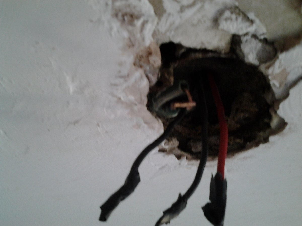

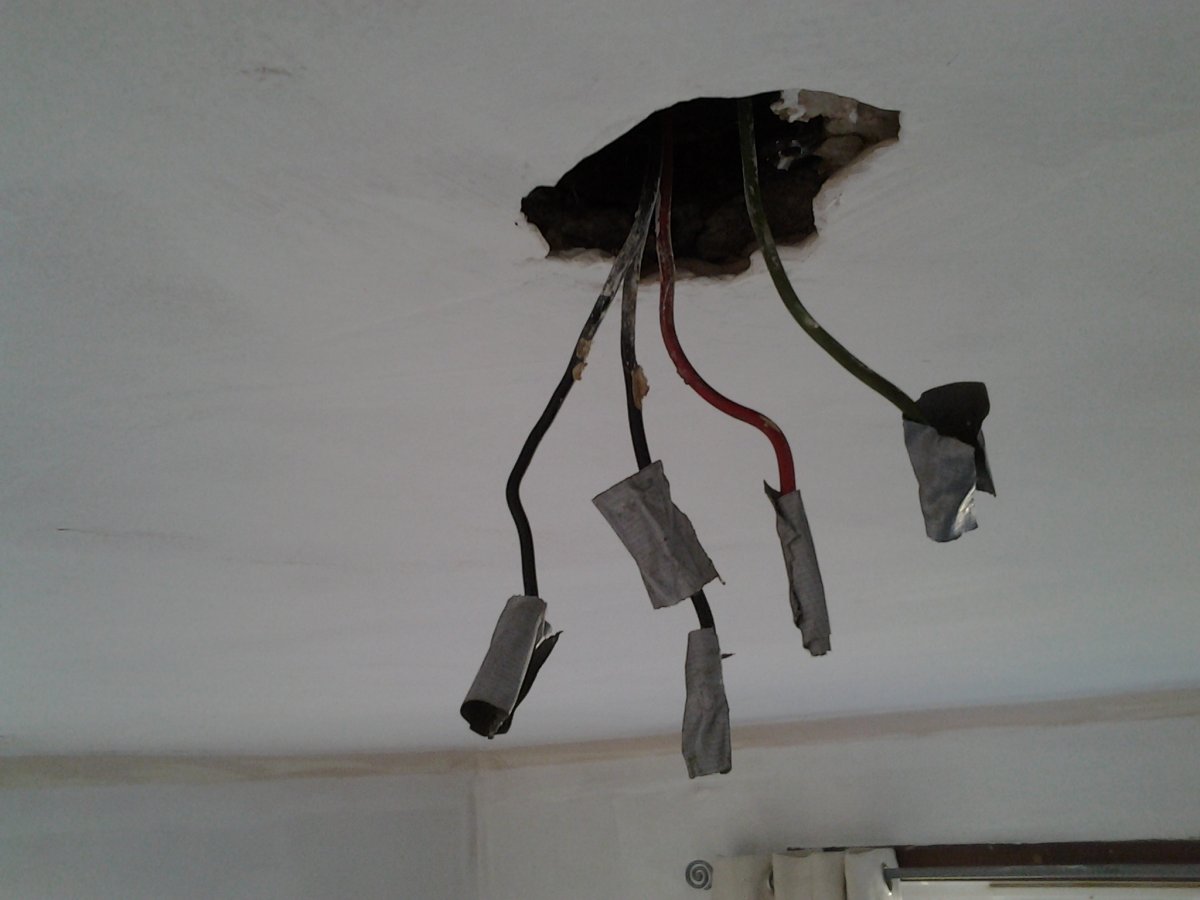

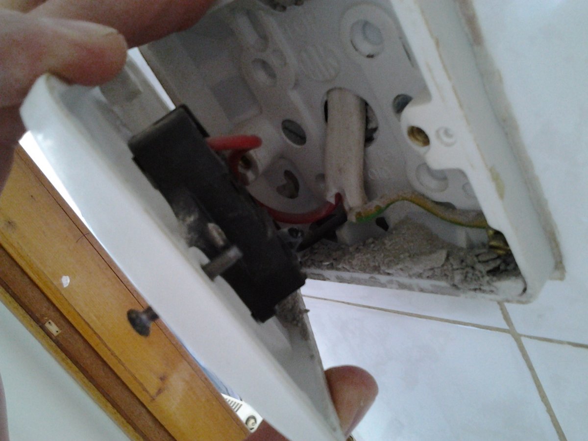

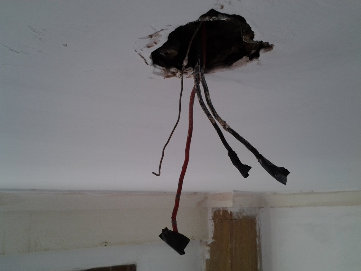

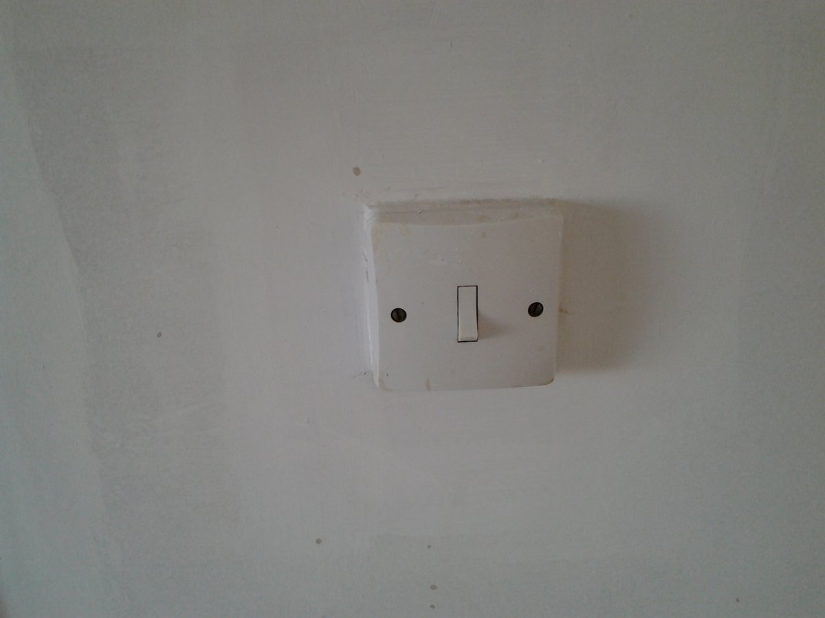

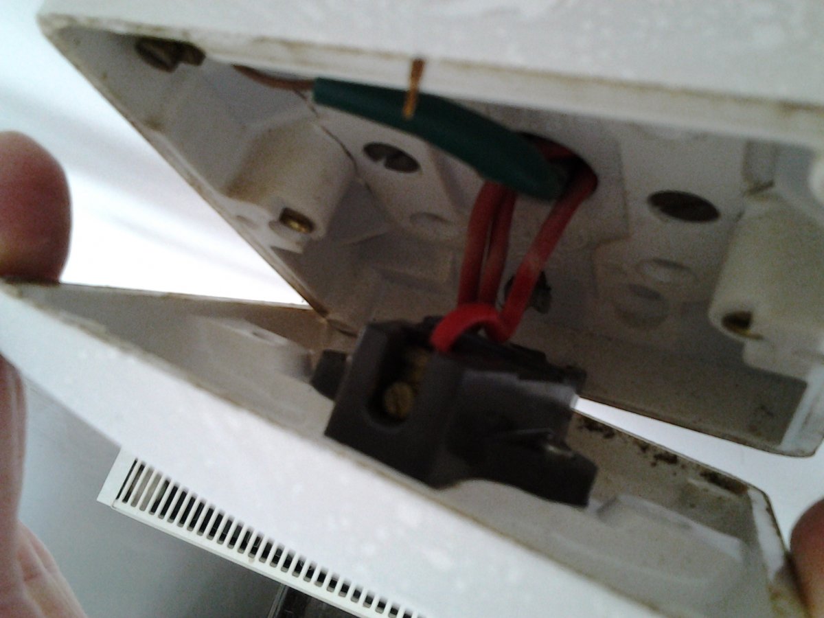

20151017_113338.jpg 20151017_113300.jpg 20151017_105550.jpg 20151017_105516.jpg 20151017_105632.jpg 20151017_105644.jpg Here are pictures of living room, dining room and kitchen ceiling wiring. I also add a picture of the single switch boxes which power each and behind this I have checked behind these and the kitchen one has 3 wires coming into it, a red, black and earth. The dining room and living room switches have 4 wires coming in three red and 1 earth, two of the reds going into the same connector at the back.

It would be so much easier if you could label each picture, so we know which light is operated by each switch.
It appears you have conduit wiring. Typically this would consist of a group of neutrals and a switch live at each light fitting.
However, there is no reason why your lighting may not consist of different wiring methods - it would be foolish to assume.
The earth is provided by the metal conduit.
That light switch which I ASSUME is the kitchen with the red and black - I wonder if this is a later addition or alteration. It is wired in flat cable rather than single core cables.
That switch suggests there is another joint somewhere. Does it seem possible that switch has been moved at some stage over the years?
