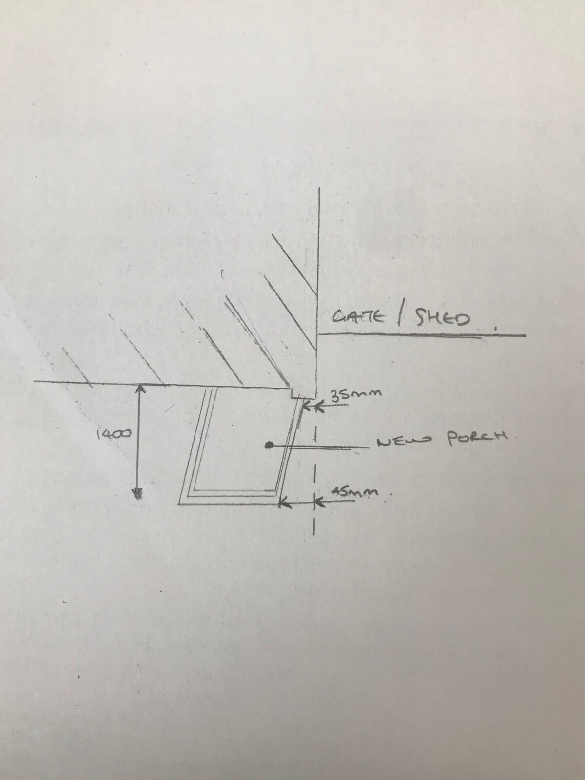

Hi,
So i got a bit carried away and decided to build myself a DIY porch (no planing or building regs required).
I found porch was difficult to set out due to the corner of the building protruding past the building line.
Anyway, I have now learned a few lessons and have discovered that my porch is built square but 10mm out of square to the existing property. Please see attached sketch.
The deviation occurs over 1.4m so im about 0.7% out. However the building regs stipulate an 8mm deviation for lengths up to 5m.
The porch is engineering brick below DPC and rendered above. I'm now at 2 blocks above DPC and have also cast the 100mm floor slab to the internal leaf.
The deviation is not hugely noticeable, but it is to me because i know its there.
My question is;
What is the best way to lessen the impact, do I
  • Take down / break out and start again.
  • Float out the render say 5mm an live with a 5mm deviation.
  • Build the blockwork out 10mm so that the render is consistent thickness (and thus wont impacts of the window reveals.
What are the other aspects I should consider if I do one of the above / continue to build such as the roof members / guttering etc.
Thanks for any input.
EDIT: sketch revised.

10mm out even over that short length shouldn’t really be noticeable, your sketch is exaggerated. I’d just crack on, or if it’s being rendered you could hatch the blockwork out a bit over a few courses and use render to cover a multitude of sins. Personally I wouldn’t bother knocking down what you’ve already done

Hatch? Do you mean stagger out?
To be honest I realized the mistake prior to casting the slab but managed to get convinced it would be OK.
I'm now thinking about the impact this will have on the roof structure. The rafters would still be cut to a consistent overhang and so this may exaggerate the problem..
As its rendered you're in luck. 10mm is nothing
Either bring the corner out and square things up now before you go any further. The bell cast will hide it at DPC level. Or split the difference and take one corner in and the other out.
Yes stagger out. Or as woody says just oversail the next course by 10mm. It won’t impact the roof.
I've seen new buildings out by a lot more and it's not noticeable.
You're right that when you build the roof you will have some sort of slight non square line, but it's very minor.
Just follow the porch wall lines with the roof rafters.
You'll be ok, don't knock it down.

What do you think about the following;
continue the build 10mm off and inline with what's already built.
Thicken the render up by 5 or 10mm on the one side to try and bring the building line back to square up.
