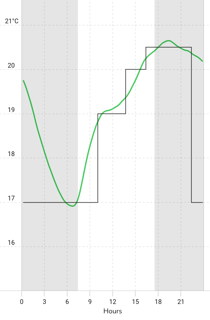

That's interesting. Have you measured the impact in any way? For example, whether it reduces the amount of time that it takes to increase the room temperature by 1 degree?
I tested the SpeedComfort (dual fan version), and found that there was no improvement in this respect. I have a smart thermostat which reports temperature changes, and my heating comes on at the same time every morning (on at 08:45, off at 10:30). I measured the temperature increase over the same 1 hour period on 2 consecutive days - the first day without the Speedcomfort fitted. and the second day with it installed. The outside temperature was the same on both days (give or take 0.5 degrees). The radiator is behind the sofa in the lounge (a 5x4m room), underneath a window. The thermostat was placed on the coffee table in front of the sofa.The results:
- on day 1 (without the Speedcomfort) the temperature increased 0.76 degrees from 09:30 to 10:30
- on day 2 (WITH the Speedcomfort) the temperature increased 0.75 degrees from 09:30 to 10:30
At that point I put the Speedcomfort back in its box and returned it!

Interesting. In my case the room neither felt warmer nor did the thermostat show it as being warmer (and we sit literally 12 inches from the radiator). I really didn't understand the point of it :0(

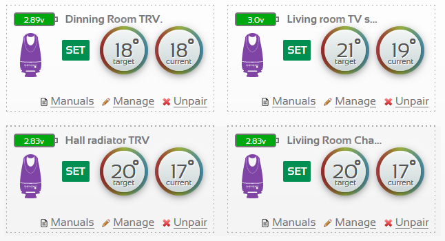

To get more energy out of the radiator, it needs to have a lower return temperature from the radiator. This is controlled with a standard radiator with no fan by the lock shield valve, which is a little multi-function.
So, mother house, I set the lock shield valve by looking at the TRV report. 4 TRVs-1.jpgThe valve was opened if the target was above the current, and vice versa.
For this to work, the boiler must run, so during the set-up, the wall thermostat was set high, so it did not switch off, but this then means if left like that, during the summer, the boiler would continue to cycle. So it is important to know what the wall thermostat is registering, this 84067_P.jpgwas a bit useless, in spite of being a good thermostat, as one it used a mark/space system to stop overshoot, which messed up the modulating boiler, and two no idea of what temperature it is seeing, this Bacteria Prevention.jpg does show both current and target, so much better, however since it will not link to TRV heads, still not what is really needed, the Wiser
does show target and current, and will connect to TRV heads, and if you have linked TRV heads, then likely each room will reach spot on the temperature set, so what will a fan do?
The answer is speed, the fan can speed up how long it takes, but the lock shield valve also controls speed. So back to basics, the fan assisted radiator does not have a lock shield valve, and was designed to be used with a non modulating boiler, if used with a modulating boiler, that modulates to gain the latent heat, then unless just one of many radiators like the odd kick space radiator in the kitchen, they need to be in series, not parallel.
So, mother house, I set the lock shield valve by looking at the TRV report. View attachment 373337The valve was opened if the target was above the current, and vice versa.
For this to work, the boiler must run, so during the set-up, the wall thermostat was set high, so it did not switch off, but this then means if left like that, during the summer, the boiler would continue to cycle. So it is important to know what the wall thermostat is registering, this View attachment 373339was a bit useless, in spite of being a good thermostat, as one it used a mark/space system to stop overshoot, which messed up the modulating boiler, and two no idea of what temperature it is seeing, this View attachment 373340 does show both current and target, so much better, however since it will not link to TRV heads, still not what is really needed, the Wiser View attachment 373341does show target and current, and will connect to TRV heads, and if you have linked TRV heads, then likely each room will reach spot on the temperature set, so what will a fan do?
So can't really see how the radiator fan is really going to work.

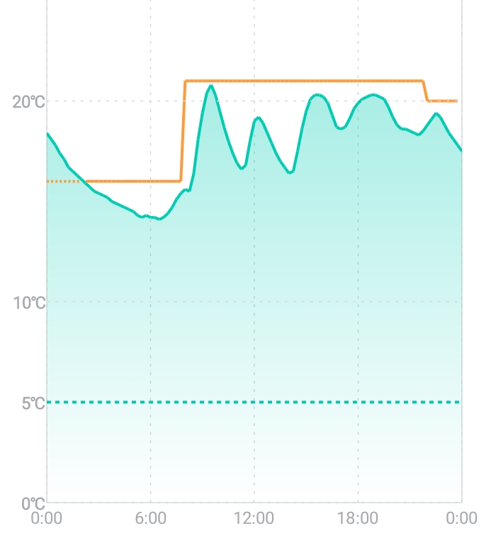

It seems you have carefully measured the temperature raise, and I have also looked at the idea of faster recovery of key rooms. My boiler (oil) has a fixed output of 20 kW, if I have not used 20 kW the boiler will start to cycle off/on, but with a gas boiler it is not a fixed output, typical gas boiler can modulate between say 8 and 28 kW, I tried in my late mother's house to find a way to know the output of the boiler, and failed.
The boiler was set to start at 7:00 am, so the house was warm at 8:00 am when the carers arrived to shower mother, the rooms would be warm, but we found it 10 am approx before the room was warm. So instead of 17ºC overnight and 20ºC at 7 am, tried setting at 22ºC at 7 am then down to 20ºC at 8 am. This worked, it seems the anti hysteresis software in the TRV heads were OTT.
So it was lifting the room 3ºC in an hour, against you 0.76ºC, but move to this house with micro-bore and the temperature raise is a lot less, easy enough to read as the TRV head records it. 1739843771273.pngalso the wall thermostat 1739843946711.png as you can see they don't seem to match, but same day in the same room, 17th Feb 2025 my living room. The TRV is a Kasa and the wall thermostat Wiser. The Nest Gen 3 is not so helpful
