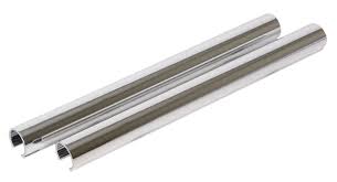

If you are happier with plastic you can fit it all the way to the radiator then fit pipe covers.
