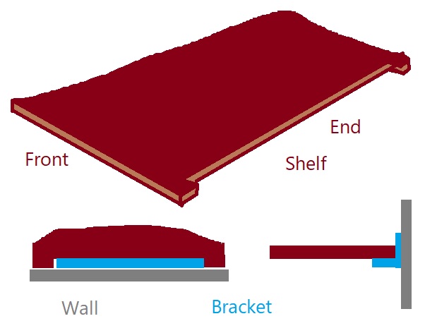

I am looking at making some shelf brackets, something similar to this:

Shelves will be made from scaffold board, no more than 1000mm long, and have kids books/toys on. My plan was to cut to length and then drill holes and spray black. If not can anyone recommend another product which may suit?
Just buy the angle iron(£15 for 3m length) and cut to size .Ali will not give the same appearance .
if you are talking angle iron on the back edge and 9" scaffold boards supported on that forget that it will lever off with little more than the board weight
If the brackets are semi concealed then the material used need not have perfect appearance

What's wrong with running a strap of wood along the wall and resting the shelf on that?
If you can be accurate enough you can do it with screws alone. Drill and plug 2 screws at the ends and maybe 3/4 along the back, gently tap down the shelf, mark screws and cut small 'notches' at each screw head and replace the shelf. Fixings will be invisible.
I think OP is looking for industrial look, visible brackets .?
