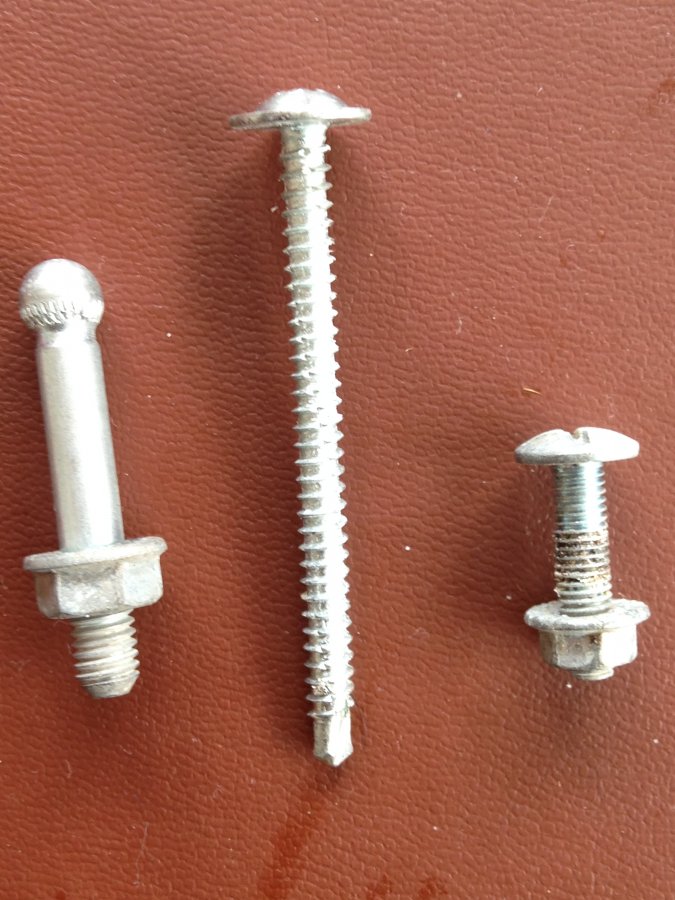

Got hold of a cheap one from ebay that is roughly spot on regarding size. It is an Edwardian and has box gutter and an old type, glass "pointy" roof. Bit of a nightmare trying to piece the roof back together as it was dismantled ages ago by a builder, who yanked at a few spots and threw/lost some of the fixings. Anyone help me with identifying and locating a few each of these: (The middle one is stainless steel and looks to be upvc window related, the first one slides in a roof channel that holds small beams and the smallest looks aluminium bolt type.)
