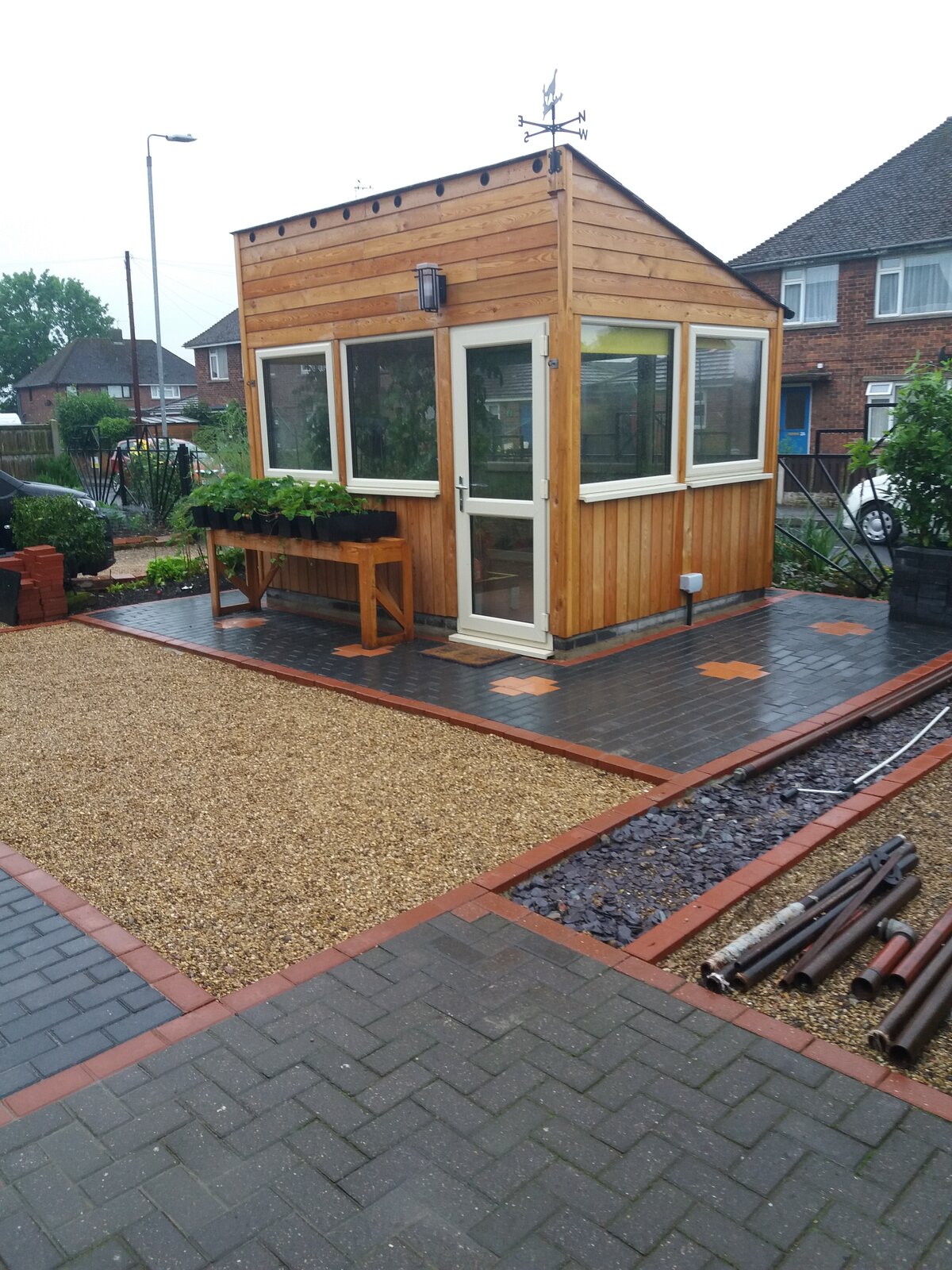

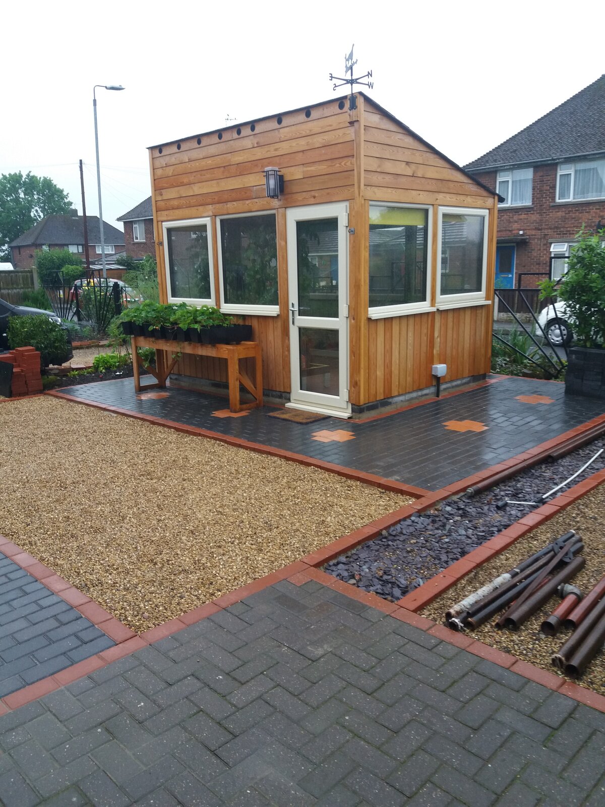

As above I did that with second hand windows CLS frame and polycarbonate second hand roof lasted for years.
Pic is its replacement same sort of idea but with larch cladding fully insulated to current underfloor heating and quarry tile floor.
