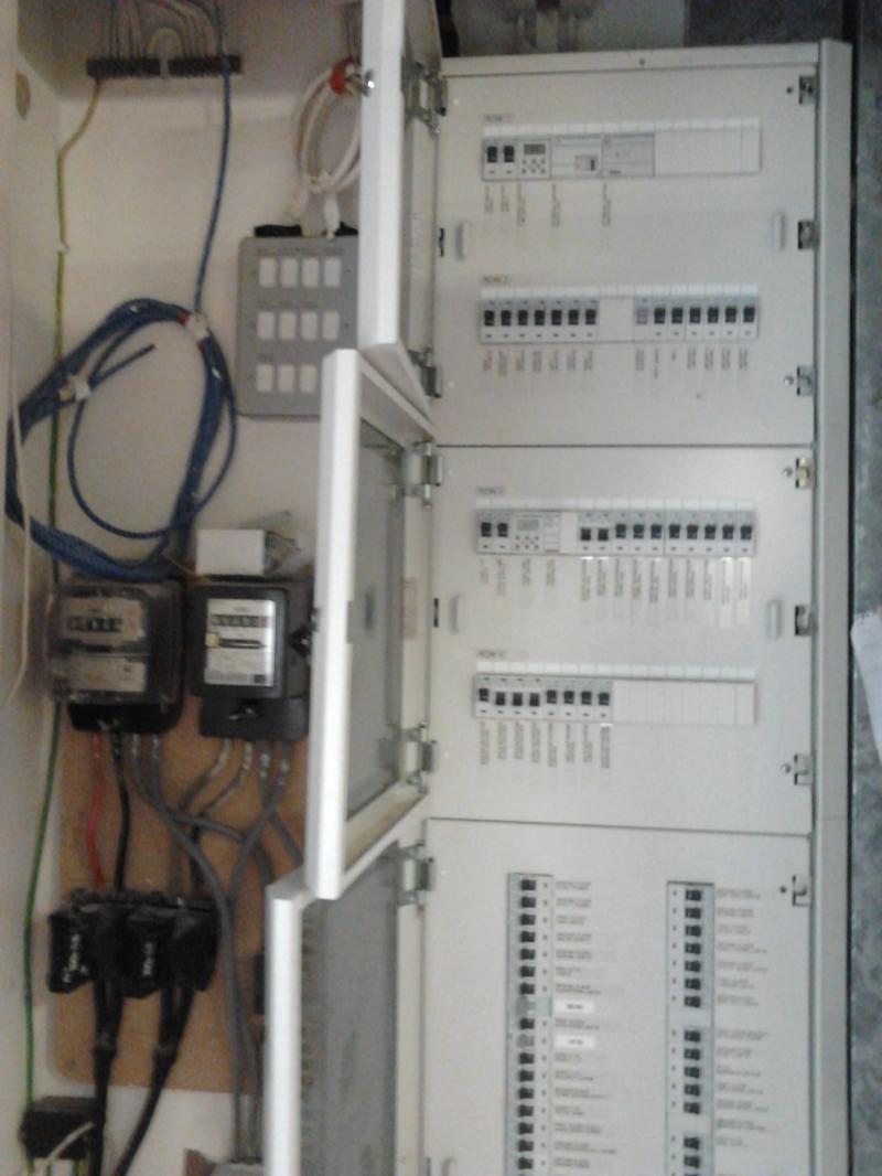

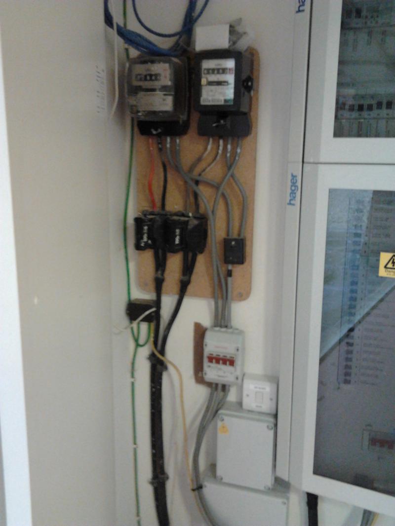

I've been doing some (non-electrical) odd jobs at a large country house nearby.
Recently, they had to call out the DNO as there was smoke and arcing sounds coming from inside the CU cupboard. The DNO cleared a slug from the RCD box - However, they have replaced the RCD with a isolation switch.
Should the DNO have replaced the RCD with another RCD?
All the bathrooms and outside circuits are protected by RCBOs but there is now no RCD protection on any other sockets.
The DNO cleared a slug from the RCD box - However, they have replaced the RCD with a isolation switch. ... Should the DNO have replaced the RCD with another RCD? ... All the bathrooms and outside circuits are protected by RCBOs but there is now no RCD protection on any other sockets.
If, per the title of this thread, it is really is a TT system then, as your surmise, every circuit must have RCD (or RCBO) protection - so, no, if there are final circuits with no such protection,then that up-front (probably 100mA, time delayed) RCD should not have been removed (or should have been replaced with another).
Under current regs, nearly all sockets (and some other things) should have 30mA RCD/RCBO protection, but that's a different matter, and does not apply retrospectively. However, the need for at least 100mA RCD protection on all circuits is essential for a TT system.

I believe it is a TT system as it is a rural property with overhead conductors. Also there is an earth spike connected to the earth connection going to the bottom LH corner.
I'm presuming this is hazardous as without knowing the earth impedance you cannot guarantee that the MCB will trip on a L-E fault.
I will tell the owners to get the DNO back in as a matter of urgency.
As an aside - can anyone tell me why there are two live conductors into the isolator but only one neutral?

Many thanks for your quick replies I believe it is a TT system as it is a rural property with overhead conductors. Also there is an earth spike connected to the earth connection going to the bottom LH corner.
Fair enough - and, as I've said, your photos certainly seem to confirm that it's TT.
Worse that that ... unless it's a very unusually low TT earth impedance, you can almost guarantee that MCBs will not trip in the event of and L-E fault. A typical 'fairly good' TT earth would have an impedance of, say, 50Ω - that means that even a zero impedance L-E fault would only result in a fault current of about 4.6A - not enough to trip even a B6 lighting MCB (ever, let alone within the required disconnection time), let alone 32A MCBs on a sockets etc. circuit.
There are only two Ls going into that property (only two main fuses) - either two phases of a 3-phase supply or, possibly, a 'split-phase' (sort-of 2-phase) supply. ... which leads me to something else I was going to suggest. It could be better to get the DNO/electrician to put separate 2-pole RCDs into each of those two live feeds (rather than a 4-pole one serving both) - so that the entire installation will not be taken out if the RCD trips.
I've just realised that I didn't read the question properly! Whether it's a 3-phase or 'split-phase' supply, there will be only one neutral, common to all the live 'phases'. A 3-phase supply is 3 phases (lines) plus (usually) one neutral - not three phases and three neutrals. Such is the nature of a 3-phase supply!

I was assuming the DNO owned the RCD but I could be wrong. I have a TT system at my own house but here the RCD is fitted between the main fuse and the meter so this would be DNO property.
They probably fitted the isolator as they didn't have a 4 pole RCD in the van -
but they should have notified the owner of the consequences.
It may be easier and quicker and less hassle to get an electrician in and fit 1 or 2 RCDs after the isolator/cut out
I'll take your word about the RCBOs (pictures too blurred for me to see them), but it does not look to me as if those DBs were installed by a numpty DI - it all looks too professional. Is there anything there to say when it was done?

The house was refurbished about 15 years ago
The electrical system is overkill - each room has it own circuit for power and lighting - each bathroom has a separate RCBO for UFH, heated towel rail and spa bath and an MCB for lighting.
