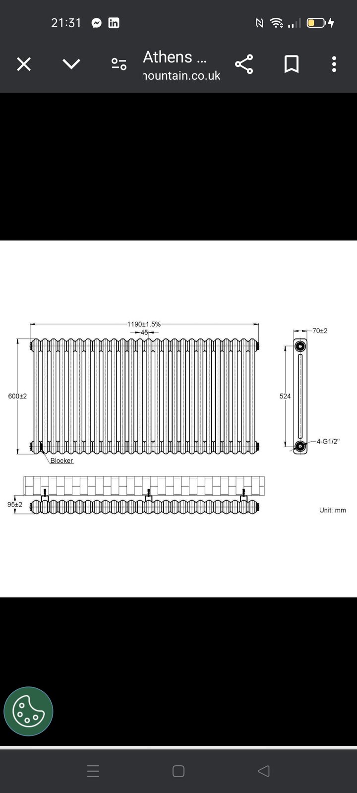

Do all column radiators have blockers in
Thanks of they do they usually have arrows on showing flow direction?
Those that dont that should. It maybe harder to get the rad. Evenly hot?
That's what is says about the blocker does flow go to the side were the blocker is?

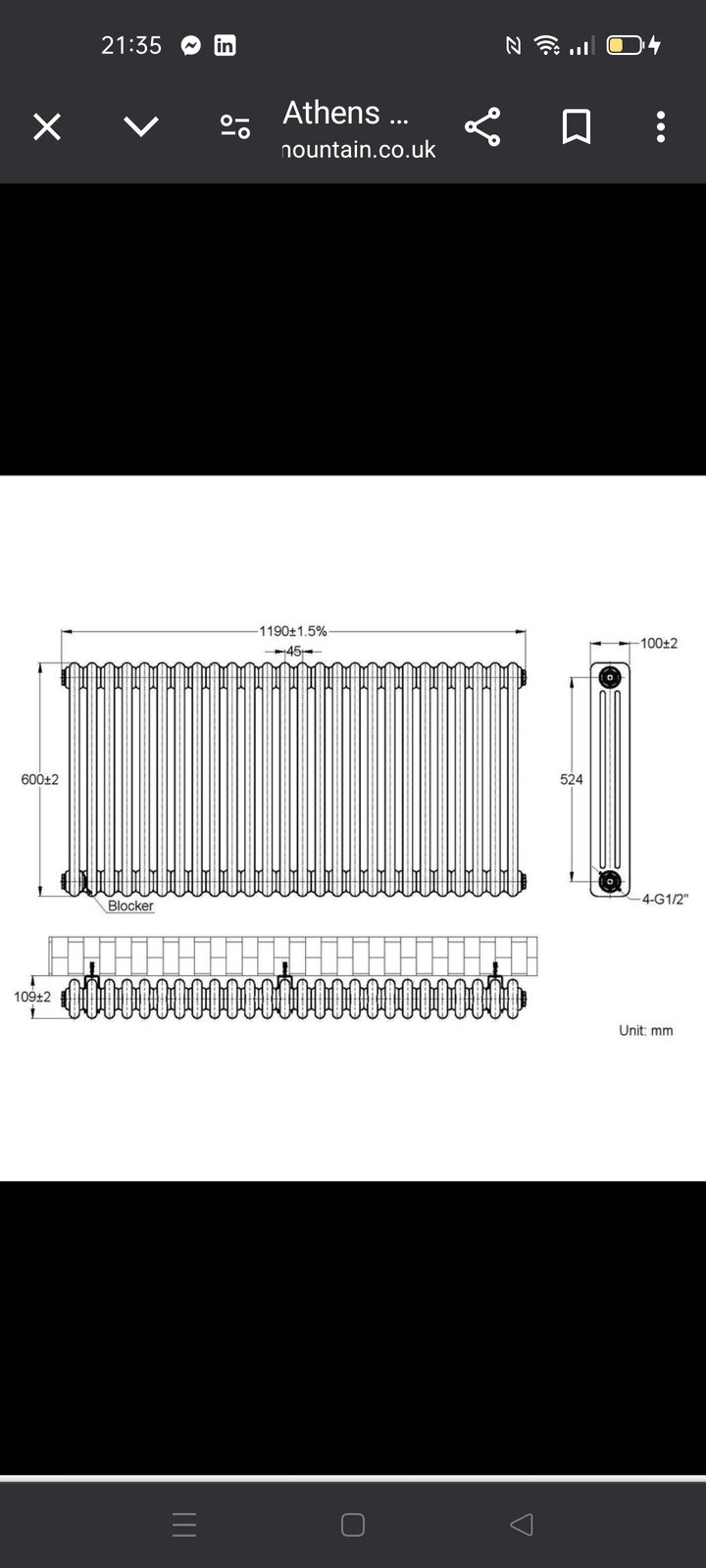

It's that one triple column. Would that be ok hung with the 4 hooks that they come with on a solid wall. Or would legs be needed?
