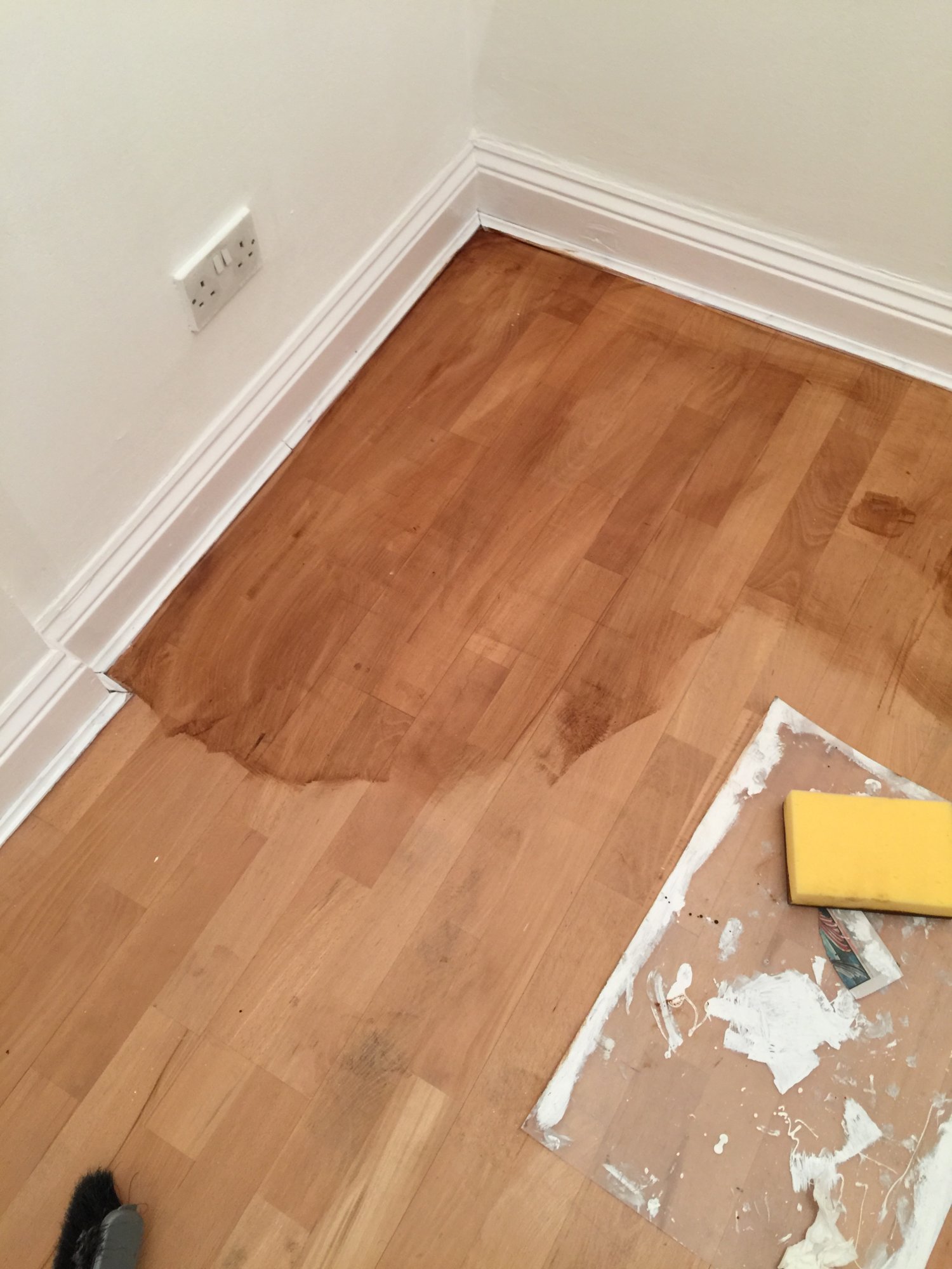

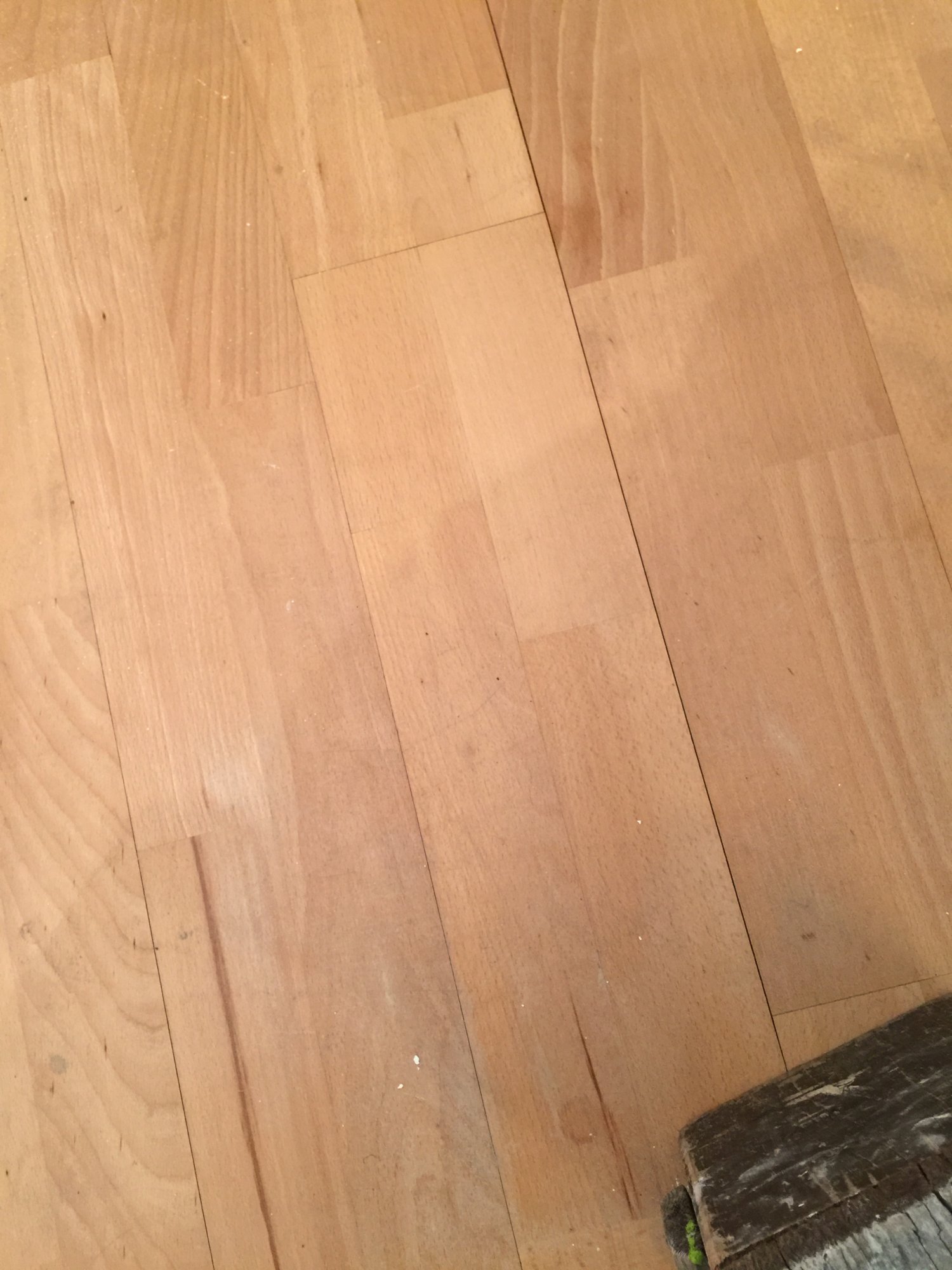

Do I have laminate or wood floor

Probably laminate- which is an image of wood, stuck onto a base layer
Try looking for easy to identify features and repeats. Most people don't mix the packs that well
It does not look like laminate to me. It has no shiny surface and it feels quite woody
Is there any test I can do to confirm
See if you can lift the bar under the door, and that might let you see the construction of it. Alternatively, find a patch that won't be seen, and try lightly rubbing it with sandpaper. It's possible that it's engineered wood, and has an oiled finish on it, and that would stop the stain taking; if that's the case, it'd need sanding down before it could be stained, or panted.
If it's laminate, you could use a multi surface paint on it, but I'm not sure how long it's wear.
