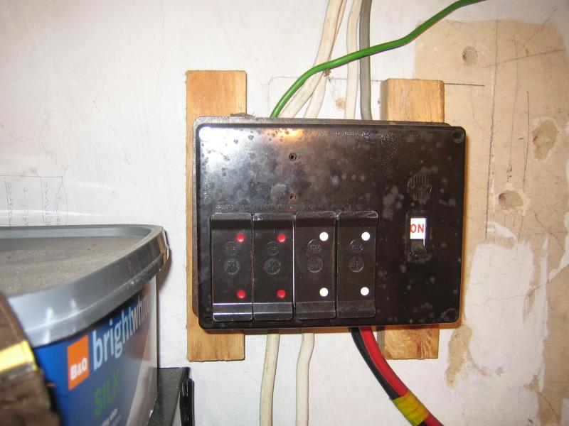

Hey all,
Have been lurking for a while and have been getting some useful info. Just about to buy my first house with my girlfriend and we are starting to work out a plan for getting some repairs done as we are buying a house that has been rented for the last few years and needs a bit of tidying up.
I have no clue when it comes to electrics and our survey has shown that the electrics are at least 20 years old. My question is are we lloking at a full rewire or just a new consumer unit at the moment. I have included a picture of the consumer unit which shows the wires going in and out, and I think I just need to replace the fuse box with a newer style unit. Can you tell from lloking at the wires if they are the older unsafe TSR versions?
Any help would be appreciated. Thanks :D

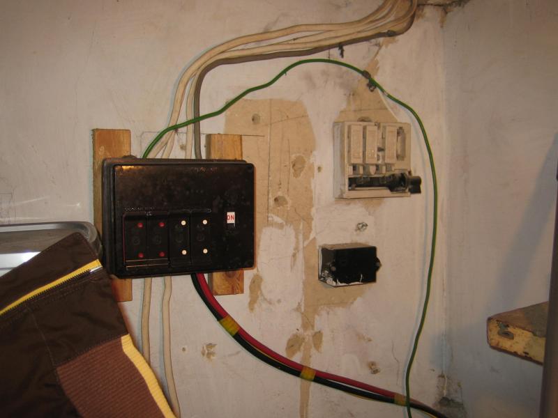

The ceramic unit on the right, is that redundant, and never got removed or is it still doing something?
A pic of the service incommer with meter would be of use.
Are all the wires coming in and out of that brown wylex visable in that pic, or are some of them buieid inside walls and then come into the back of the unit?
It looks like PVC wires from the outside - how far they go is another matter. The CU looks like an old wooden backed one which it is advisable to have replaced. You only have 4 circuits, not that many for todays needs. No RCD protection etc.
One option is to have a periodic inspection report carried out - this is advisable at change of occupancy anyway. This should highlight any necessary remedial works you need to have carried out on the installation - it will cost you but may give you a better idea as to wether or not a full rewire is more cost effective.
It certainly is an olde installation, and some modificatians are required.
Are there many sockets in the house?

From a quick glance, you have no RCD protection, your PEBs appear to be missing, and your main earth is too small, and your meter tails probably are too.
It looks partly grim. I begin to have concerns when I see white PVC cable (not lsf cable) as it looks like DIY.

That needs sorting, it does work and will continue to do so, but it won't cope.
1st house means that you are likely to buy somewhere that needs remedial work. You may want electric showers, ceramic hobs, dish washers and the general array of electrical kit a modern living standard seems to require. Your pictures indicate that the property hasn't got the basic electrical standard to offer that.
Get the main incomer modernised, get a sparks to provide a new board, sort the earthing, tails and test the existing circuits service.
Then as an interim measure you have the heart of a new electrical system and can add to it as you revamp the property.
