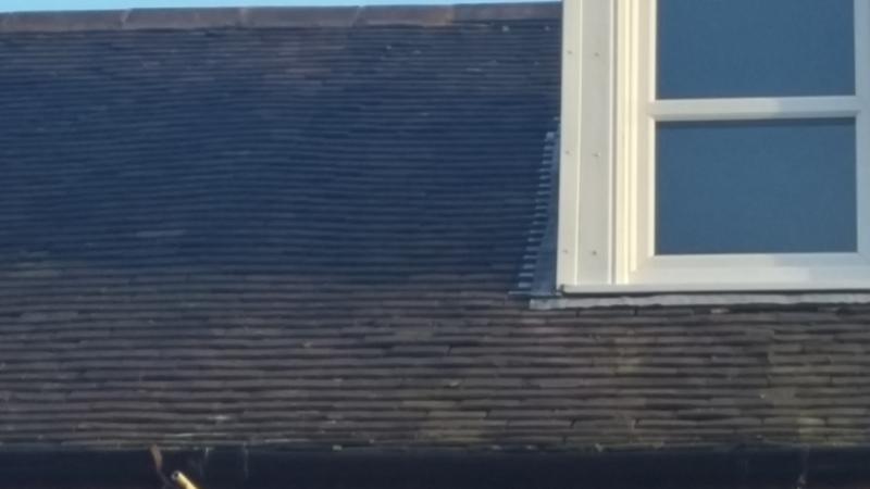

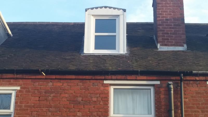

These pics are from the rear, the front is in a similar condition.
We are currently remortgaging on a ten year fix, and if we need any major work wanted to add the cash now to the mortgage as it will be difficult afterwards.
Do we need a new roof, or should we just get someone to give it a good repair? And what are the approximate costs? We are in Worcestershire.

It doesn't look too bad.
A decent overhaul will see it last another good few years.
I'd be more concerned about the brickwork mortar.

Hard to say from photos.
If the tiles are as good as they look and solid then not very much to repair.
The lead work and ridge tiles will be the pricey bit if needing attention, replacing broken tiles is the easy bit.

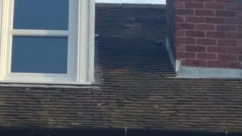

The lead work around the window is quite recent as we sorted that. There is a velux on the other side which doesn't seem to be a problem. The edge of the chimney lead work is where I think the ceiling problems in the top bedroom stem from, so that probably needs looking at.
As I say some of the actual tiles are missing and some are split.

Its hard to tell but there appears to be a "something" popping out from behind the c/stack at the back gutter position - what is it?
The side flashing to the dormer is wrong - it should have been installed like the stack flashing, soakers and stepped flashing.
Is the bedroom damp showing at the front of the c/breast or at the back?
Do you mean the not at the top left of the chimney as it attaches to the roof? I see what you mean. I haven't noticed anything but will have a look when its light.

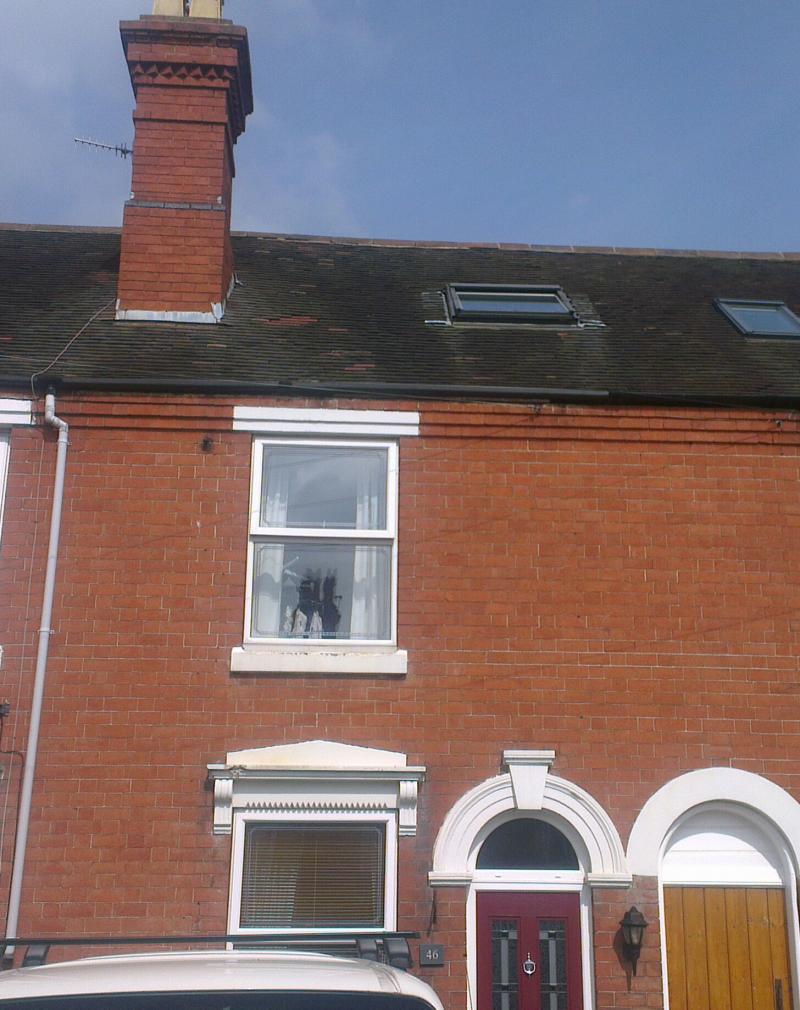

The peeling ceiling paper in the top bedroom actually comes from the front chimney I think. Here's the front of the house.....
As for the side flashing to the former. Is that something we should have changed? It hasn't caused any problems like it is. Bit if we are having things sorted then we can get that sorted if that's even possible?

From what we can see there is no need for a new roof.
Replace any broken or missing tiles, and locating the leak at the rear chimney stack seems to be whats needed. This doesn't require a scaffold.
Simply by lifting the lead flashing or back gutter at the stack will often reveal leak penetrations.

They have all suggested the flashing around the front chimney needs changing ( I can see gaps) and the flashing around the velux needs work. They also agreed with above that the flashing at the bottom of the former needs correcting and the ridge tiles need repointing.
