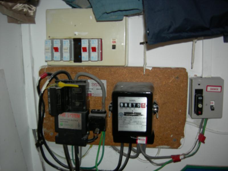

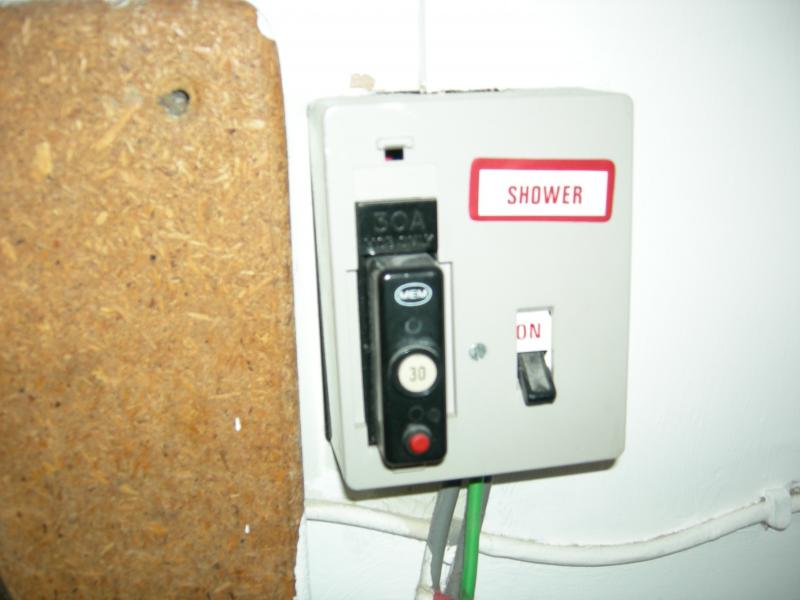

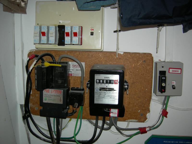

Hi Forum, I would be grateful for some advice. I intend to change my 7kw shower for a 7.5 Shower. The reason I am not going any bigger is that I don't want to change the 6mm Twin and Earth cable. The cable is less that 10 metres long and travels through a plastic trunking and under floorboards on its own. The shower is protected by it's own 30a MCB in it's own consumer unit placed next to the main consumer unit. The main consumer unit is an old WYLEC, but I have replaced the wired fuses with plugin MCB's. Do I need to change the shower's consumer unit with a RCD? The one I have seen is a 63A 30mA RCD with a 50A MCB. Is this too big? Also can someone tell me the difference between a RCD, a RCCB and a RCBO. Thanks,

Could you provide a picture of your meter, service fuse, and all consumer units? If you do that we might be able to offer you further advice that will be more suited to your specific installation rather than going into autopilot and giving you advice that might not be suitable.

My Main fuse is 60A. The shower consumer unit is fed directly from the consumer side of the Meter. This consumer unit was fitted by the Electricity Board years ago and has an isolating switch and a 30A MCB. I assume I would change this CU to a RCD or a RCBO. Thanks,Bob

Unless we know what type of consumer unit the shower is connected to we can't really help you much because it could be the case that you will not get a RCD/RCBO for the CU and you will need to fit a modern replacement.
If the shower CU is fed directly from the meter then before you are going to be able to carry out any work you are going to need to get the DNO to fit an isolator between the meter and the CU as I'm guessing the isolator you talk of is actually within or a fitted part of the consumer unit?
Also, you can't change a CU (consumer unit) for a RCD as you need the consumer unit to actually house the RCD/MCB/RCBO etc. I'm sure you know that already though and you have just got your acronyms muddled up :p
If you can supply a picture it would really help to get you the most effective responses.

I have taken the photos but can't find out how to attach them! Sorry to mess you about, you must think "what a fool!"
