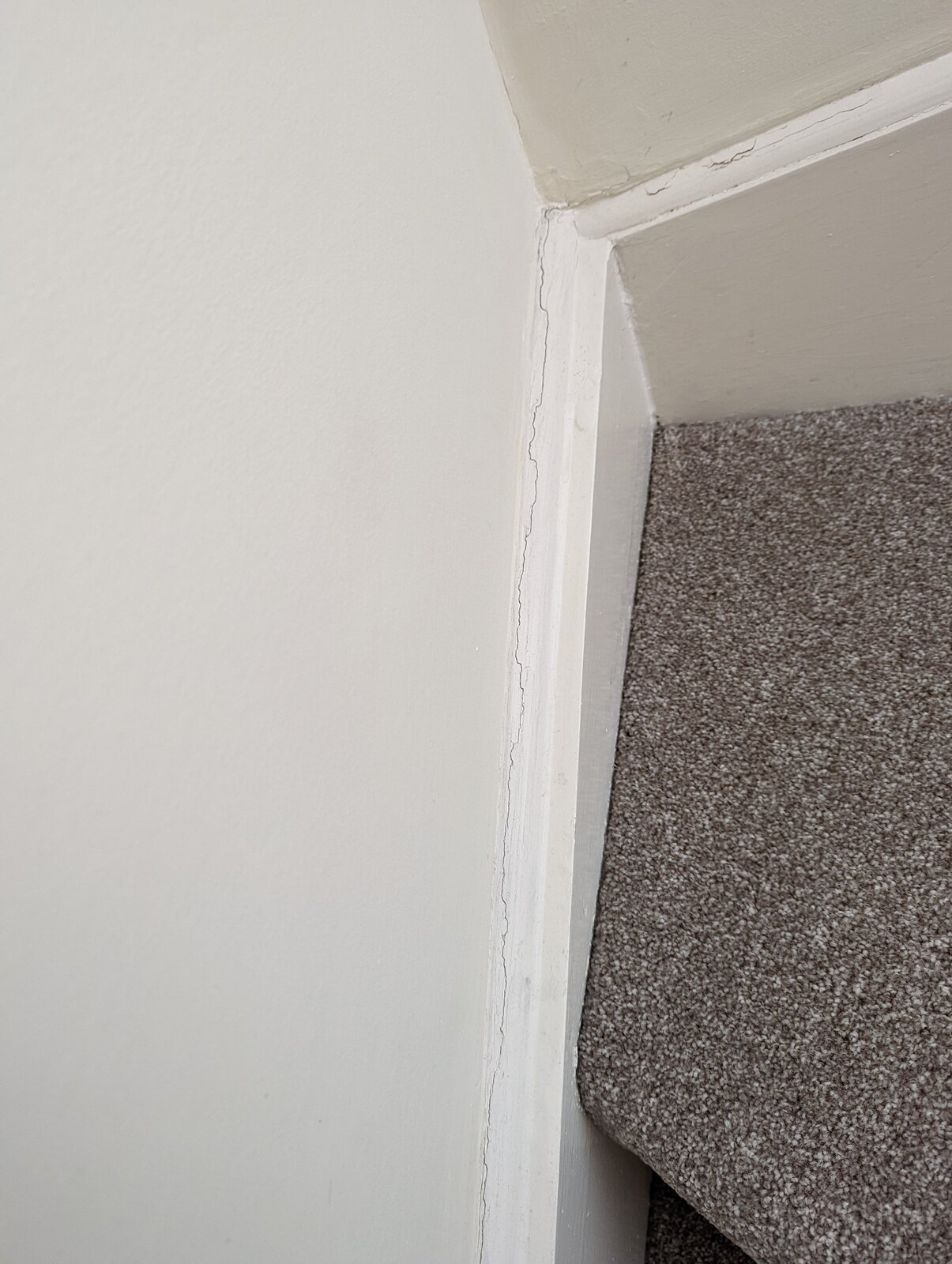

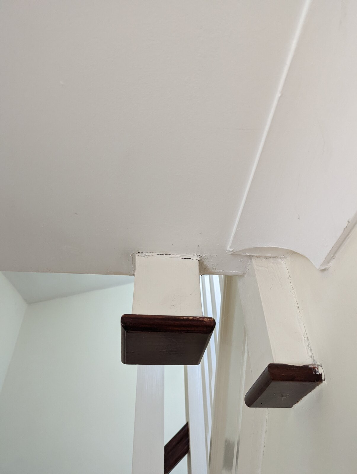

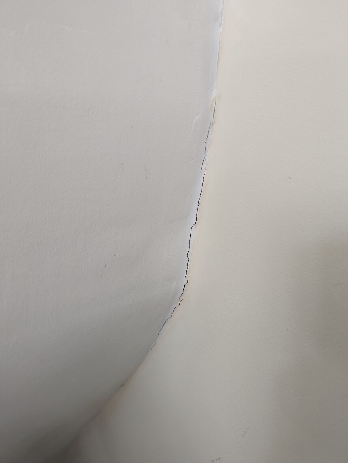

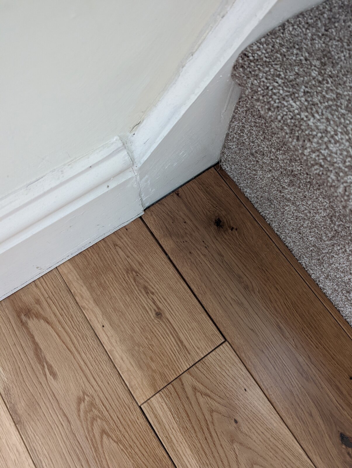

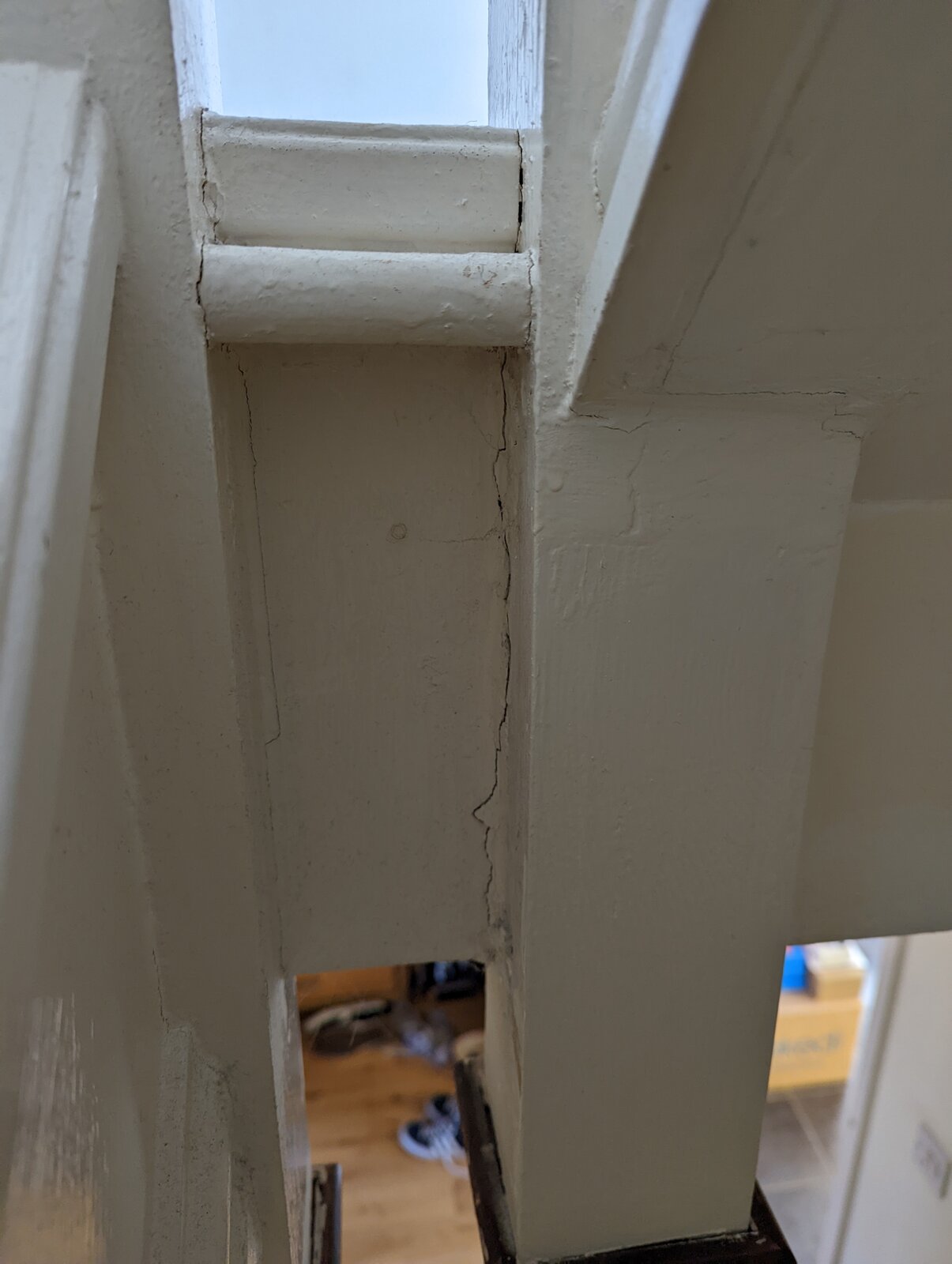

After some advice about the movement of a staircase which is causing cracks and twisting. Also pressure seems to be pushing laminate flooring slightly apart. Crack also showing in blocks directly under the staircase in the garage.
Does anybody know what might be causing this and what needs doing to rectify? Or if I need a survey to determine that?

A lot of those cracks seem fairly minor movement cracks caused by settlement and drying out. Whoever decorated should perhaps have used a flexible decorators caulk instead of a hard filler like Polyfilla, who knows? Or they may just be the result of a heavy move where stuff was bumped up and down the stairs. Bear in mind that wood is not inert and moves (swells and shrinks, especially with the changing seasons) all the time
Does the staircase creak when used? Can you feel the staircase actually moving when in use? How old is the building? (Looks maybe 1910s to 1940s to me) How old is the staircase? When was the blockwork put in? What is the work which has been done in the vicinity of the staircase?

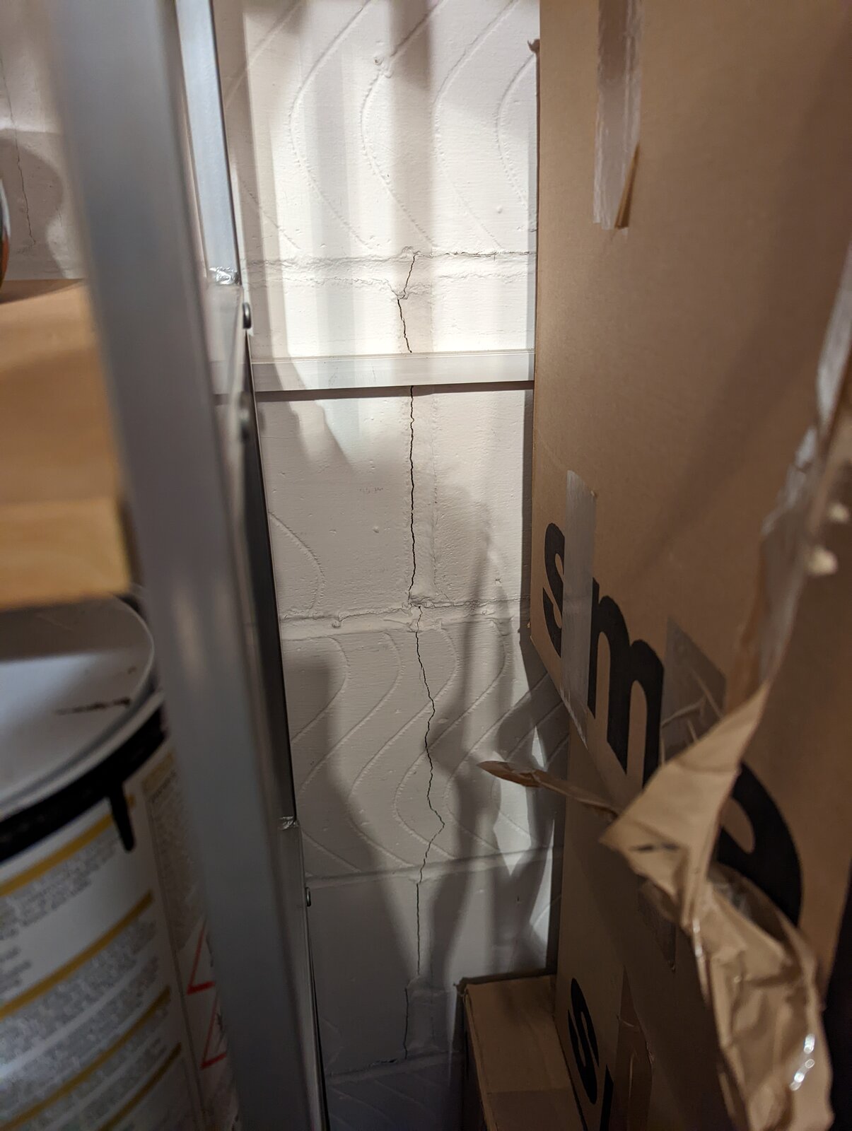

The only photo which concerns me slightly is this one:
and I'd rather defer someone with far more masonry experience then myself, such as @^woody^ for an opinion about what is going on there

The staircase has started to creak recently in the part which is over the crack in the blocks (these are blocks in the garage that the staircase is part located over. They're part of the garage from the ground floor).

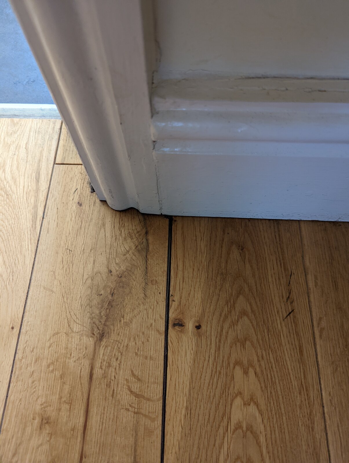

Laminate cannot be pushed apart, if it’s opening up it may be poor quality, poor fitting or both .

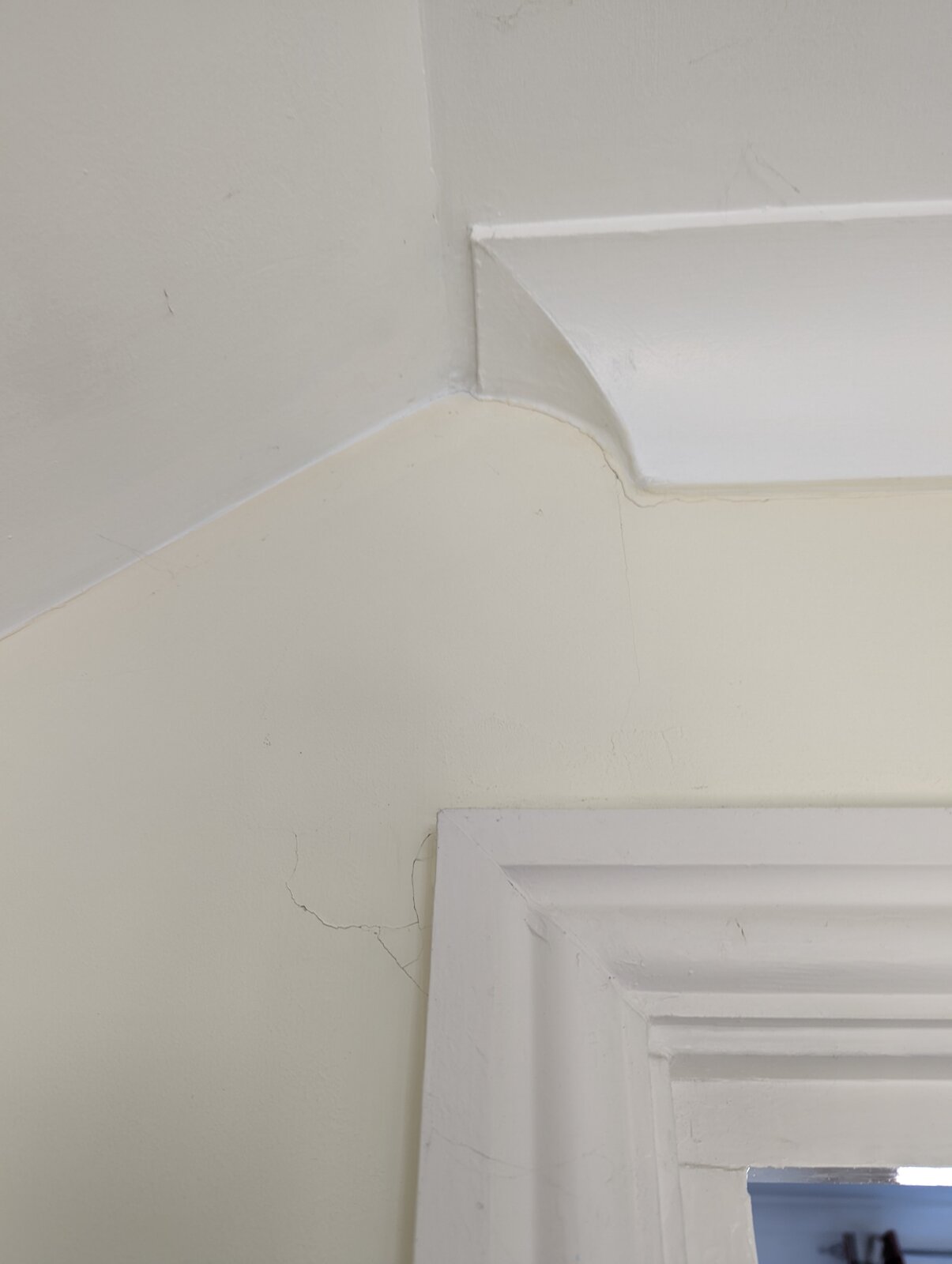

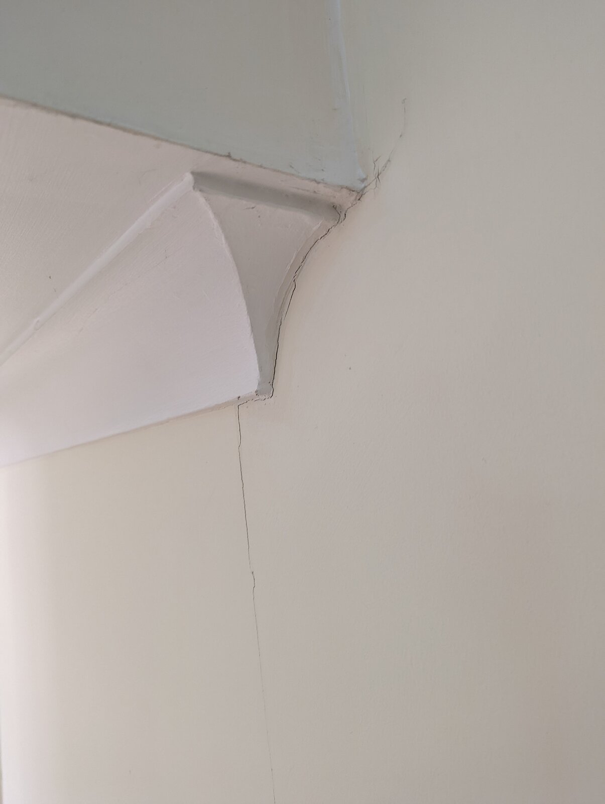

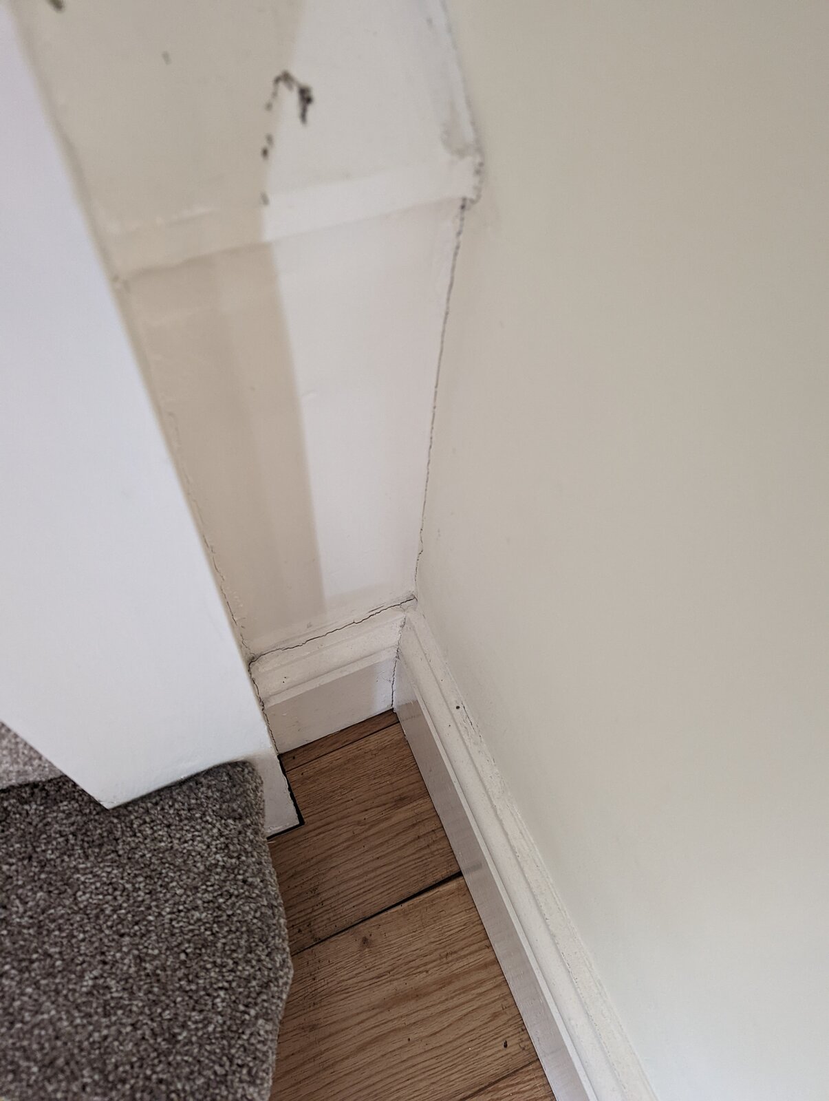

At 22 years old the majority of those are just caused by the plaster drying out and require a small bit of work with some crack filler, e.g Toupret before you next decorate (photos 5, 6, 8 - vertical crack in corner and 9) or might need a but of flexible decorators caulk in the joints next time you decorate (photos 2, 4, 8 - horizontal crack at top of skirting and 10). These would automatically be fixed by any half decent decorator as the preparation part of his job (i.e before getting his brushes and rollers out)
On closer inspection the laminate (photos 3, 7 and 8 has clearly got some installation issues with pin holes visible in photo 8 showing that the last two trapped pieces of laminate were pinned in place - something you shouldn't do when installing do natural movement of a floating laminate floor will potentially pull the floor apart (as it has done). Photo 3 seems to be movement again, possibly because the clearance cut in one of the pieces by the door jamb wasn't big enough whilst in photo 7 you may have the same sort of clearance issue at work. All relatively simple to sort out (basically a cat's paw pry bar, hammer and saw job), if a little time consuming.
