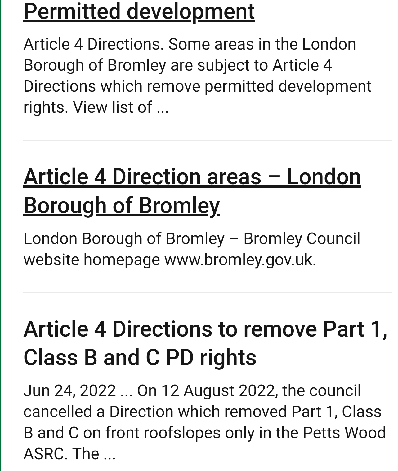

Bromley Council does not have an article 4 map
I searched "Article 4' from the home page and got
There's lots of conservation area guides too, and why they are .... ie the features they want to preseve .... which is the in keeping bit..
