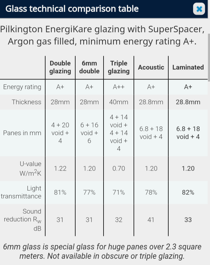

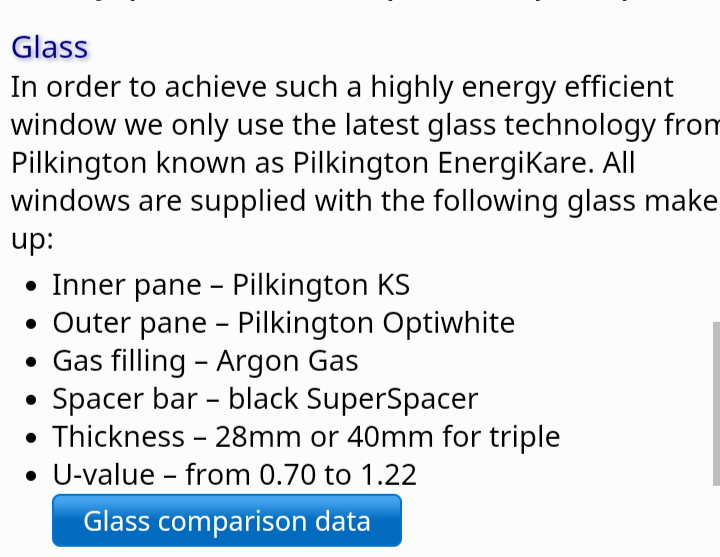

Hi Notch7,
This is the spec for their units and below their glass spec. Does it sound reasonable? I'm completely naive with glazing so just want to make sure I'm not ordering duds.

Yes a 40mm triple glazed unit with 14mm air spaces and a quote u value of 0.7 is going to provide you with the full benefits of triple glazing.
The industry doesn’t push triple glazing and it’s not terrible popular because the argument is that it hardly any gain over double. However it has a greater improvement to how a room feels because the temperature on the face of the inner pane is significantly warmer compared to DG. The warmer pane makes the room feel more cosy because you don’t feel the coldness coming from the window.
I have triple glazing in the sidelights of my from door, even on bitter cold days the glass doesn’t feel really cold.
