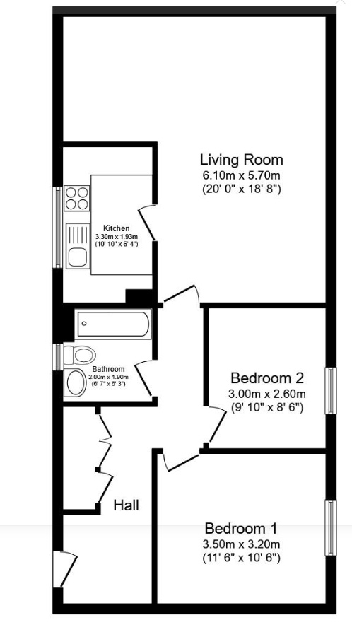

hi I've read alot of threads about kitchen doors. I'm planning to rent out my flat - do I need to keep my kitchen door here is my floor plan :
Yes, Put a door closer on it. As woody comments - a fire door; in fact fit a fire a fire door along with the door closer. That will keep down your redecorating costs - particularly if a single bloke rents it. (I know as a tenant I had seemed to only use a frying pan to cook. The clean up was prolonged.)
How do I know if its a fire door without any certification?
Thickness, smoke strips, hinges, closer?, thicker stops on the lining.

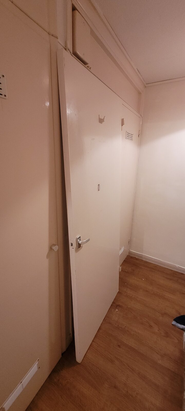

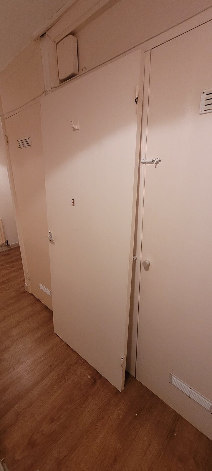

I don't think it is a fire door, here is a photo what do you think?

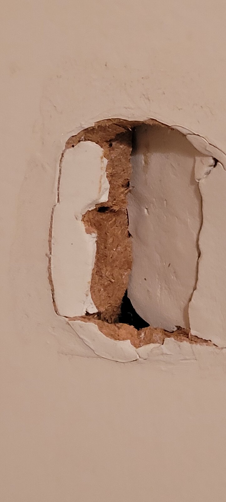

Here is a hole that shows the material its made from.
I do not think that it is a fire rated door. It has rising butt hinges rather than a door closer.
I would however be very surprised if you did not have to have a fire check door on a kitchen in a rented property (possibly with intumescent strips) and an automatic door closer.

@opps Eh? with regards to a flat you don't need FR doors just because it's a rental.
woody is saying if the property was built with a fire door on the kitchen originally then it should be maintained. That's it.
The door that is currently fitted is clearly not a fire door. If that is the original door then it's safe to assume that a fire door is not required.
Back in the day, rising butt hinges were the self closing devices fitted to fire doors, and common in all flats.
