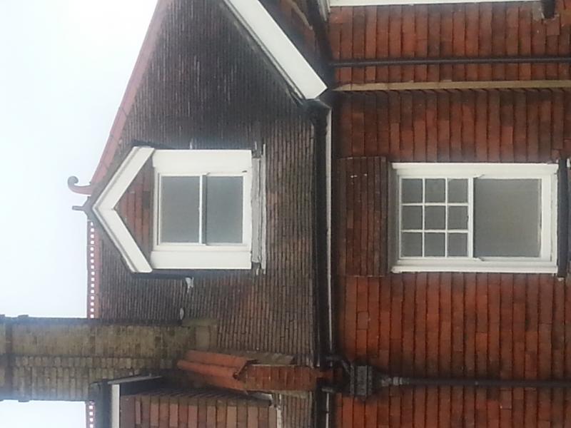

:cry: my problem started during this horrible weather. Water dripping in thru ceiling on 1st floor of 3 storey old house due to wind n rain. Roofers identified problem with valley. Cost £1600 for replacement with lead. However I went in the loft and to my horror I discovered that roof timber work is damp. Never had that problem b4. I believe that roof is original. We have Bn here 20 yrs. When we first bought the house my husband got someone to check the roof and put right things incl missing, loose tiles etc. I had last Bn in loft spring summer last year. Didn't see any thing. I hold on to timber as I walk so would hv felt dampness. Bcause of attic rooms it is not possible to access the whole of roof from within. I was able to s see light coming thru in one place. I do feel that the wind had made water come in. But I'm worried.
Don't know what to do so have asked roofers to quote for roof replacement. See pics. The area that I can access from loft are some parts of front of house n some side. That's all. Every thing I touched was damp.
Also given the weather is this the right time to do work? In the meantime I've to decide now wether I get the Valley repaired as that's making water come in the house.
My impression is that the roof does not look that bad. However you do have a serious issue in that valley as there are quite a few tiles missing. What is the valley made of at the moment? I would have expected it to have been lead originally. The trimming of tiles to the valley is not as neat as I would expect to see. Perhaps the work of a bad roofer?
I don't think the valley material itself is likely to be the problem. The missing tiles are enough to make it leak there.

Thank you for that. Much appreciated. I don't know what's Valley made up of now. I'm led to believe that b4 we moved in some one had done bad job.

However if it's just the front Valley how come my roof timbers are all damp? Any idea?
The entrance to loft faces the side elevation in the 2nd pic.
If the roof space is not properly ventilated, a possibility with the alterations, then it could be condensation.

One thing to check is that the loft insulation does not block the eaves as on an old roof it is the flow of air from one side eaves to the other that keeps it ventilated.
If an attic room is added, (its not clear to me if it was an original feature or not) that can also interrupt the flow of air if not done properly.
With a tiled roof the only time you really need to think about reroofing is when the old tiles start to perish in such numbers that regular replacement becomes necessary.
Out of interest I wonder if the roof has any underlay like roofing felt. If not you will be able to see the underside of all the roof tiles. An old tiled roof with no underlay would not usually be a ventilation problem
Much better pics of that valley, and I completely agree with Blagard - get the tiles sorted over the valley and that problem will go.
Now - the dampness within.....certainly not trying to be patronising here, but are the timbers damp, and not just cold?
Is there a layer of felt between the rafters and the roof tiles, looking from within?
You'll get plenty of people jumping at the chance to do the entire roof, but although quite elderly I've seen much worse!
Re your extra insulation......its only the ceilings of the rooms that should be covered. That doesn't include a great wedge of the stuff in the soffit (overhang) area which may impede ventilation. Old properties like these didn't have the soffit ventilation thats required now - the more air blowing round in there the better!

No there is no felt.i can see the tiles from inside.
Yes,at first i thought that may b it was the cold making me think timber was wet. I'll hv to go 2moro n check again. I know for sure that where the valley is, it is wet. Right along the length of Valley.

Expect to find the insulation soaked below the valley, sure enough - but that will take care of itself once the valley is sorted. If its really soaked its probably best to chuck it out and put new stuff in. The timbers will be wet too - but don't fret about that.....it will take take care of itself.
If there's no felt in the loft, ventilation is usually adequate - thousands of roofs are like this still......thats why I suggested the timbers may be just cold rather than wet.
Now, chin up!! This will all get sorted in due course, and the rot doesn't set in overnight!
