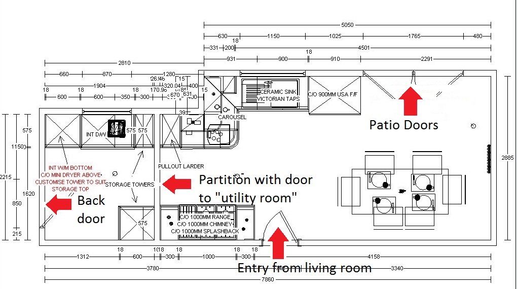

Hi all
(See drawing below).
We're just planning a new kitchen and one of the ideas we've had is to put a partition wall in the kitchen to create a small section that will be a "utility room". This small section will also contain the existing back door and so I wondered if I could brick this up to give me more wall space in the utility room?
I would still have access outside via a patio door (which is just of type of two glass doors where one door slides sideways across the fixed door - not the swing door type as shown in the drawing).
I just wondered if this was allowed under the building regulations or if there was some rule that would put the kybosh on this?
Thanks for any help you can give me. :)
Thanks Tony. I assume it wouldn't be acceptable if it was going to be a bedroom or something? Is that correct?
It would only potentially be an issue if the property was a house three storeys or higher, or a flat.
Ok, that's great. Do I need to tell anyone I'm doing it? Request permission from anyone etc??
We own the house but didn't know if I needed planning permission etc?
You would be forming an 'inner room' (ie one only accessible from another room). This is only acceptable if the inner room is a bathroom or utility or suchlike, or - if a habitable room such as a lounge or bedroom - it has an escape window.
Planning permission not needed (assuming it is a normal house and not a flat).
That's brilliant Tony. Yes, it's just a normal house (upstairs and downstairs).
Thanks Tony/Woody for all your help on this. It is very much appreciated :)
