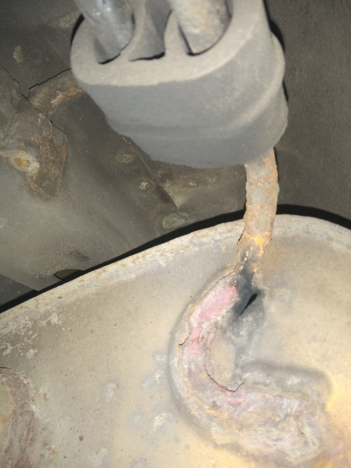

Do these hangars on this exhaust backbox look corroded enough to be a problem on the MOT ? Pics incl

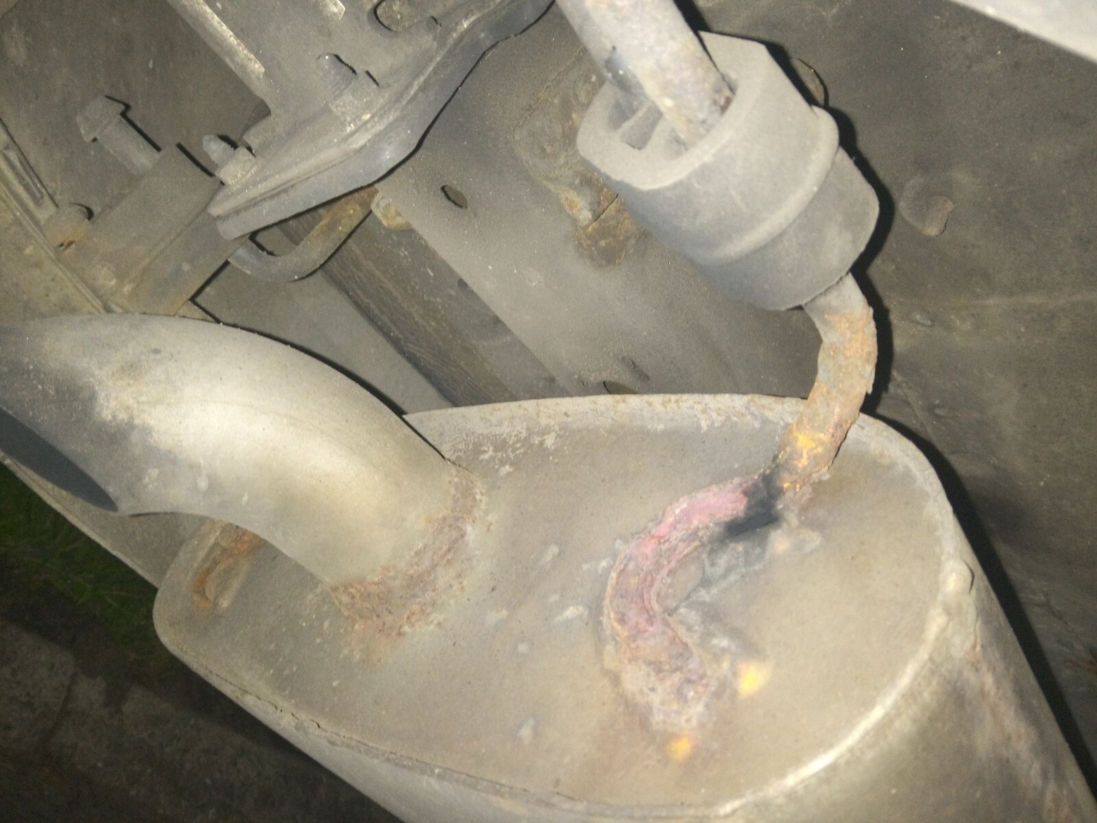

I noticed tonight that the back box hangars look corroded but I'm no Mechanic , this is only my opinion from what I see.
Do you think the hangars on the back box look corroded and so you think this may be a concern for its upcoming MOT test ?

The corrosion is not a problem but that hole in the silencer will be.

I didn't even notice that hole maybe because I took the photo in the dark.
Do the hangars not look corroded to you ? They look thinned out and crumbling imo
Is it a repair or replace job for backbox ? Thanks
As above, fill the hole with Gun Gum or whatever.

Corrosion is not a problem if they are sound. As John says, get a bit of Gun Gum into it.

The hangars look thinner at the bottom, bit of rusty flaky metal come off if I scrape it with screwdriver.
I could probably get a replacement back box for £15, is it worth just replacing it do you think ?
For £15 you might Just as well fit a new one - a tin of Gun Gum will probably cost a fiver!

Does it make more sense to just change it as the hangars are rusty and narrowing or would you just repair it with that stuff you mentioned if it was your car ?

If it was mine, I’d definately replace it unless I was getting rid of it!
I've seen much worse systems than that go through the MOT - just bung the hole and wait for it to drop :mrgreen:

I might repair it for now or I may just replace the silencer as the hangars are narrowing and look as though they will not last too much longer in my own opinion, I don't want to get caught out far from home with a dropped silencer.
