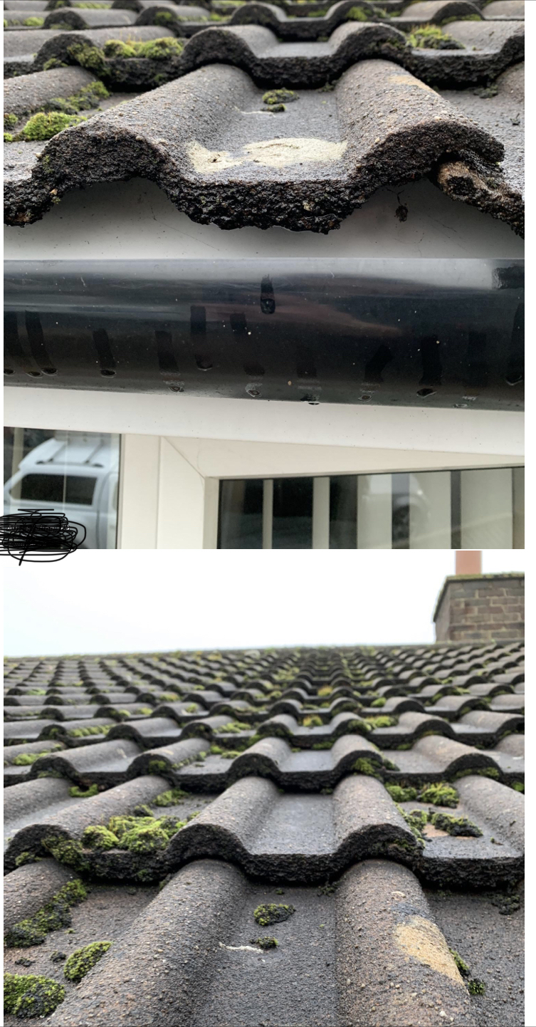

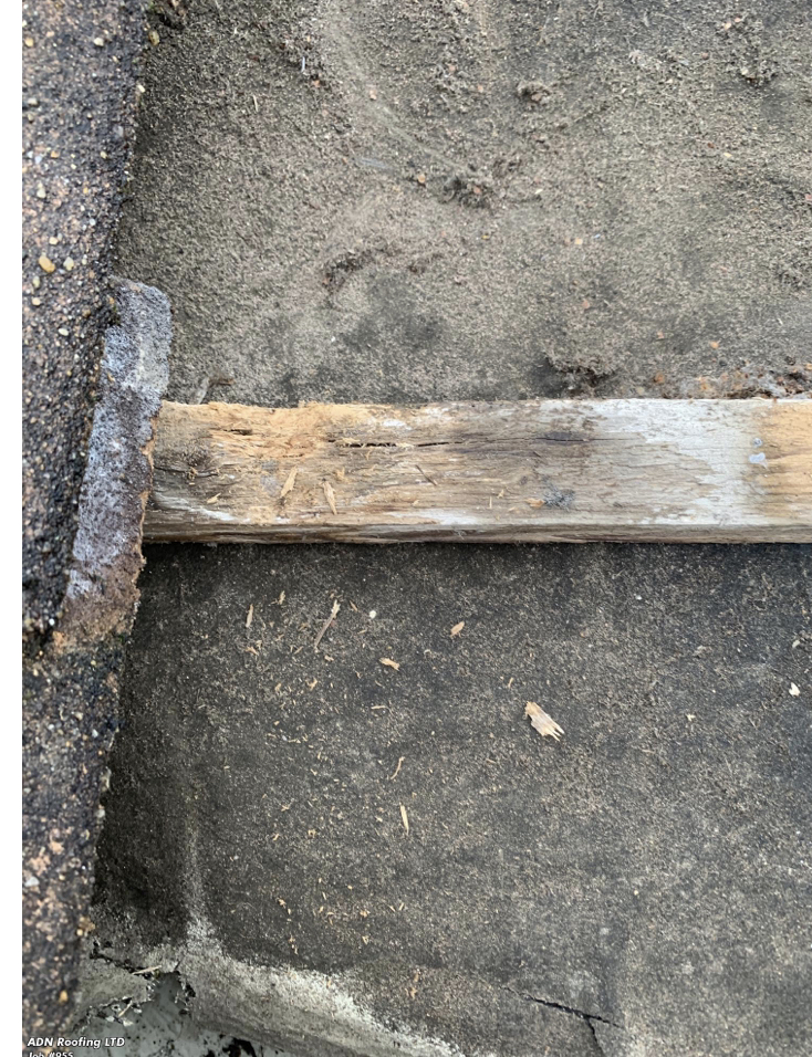

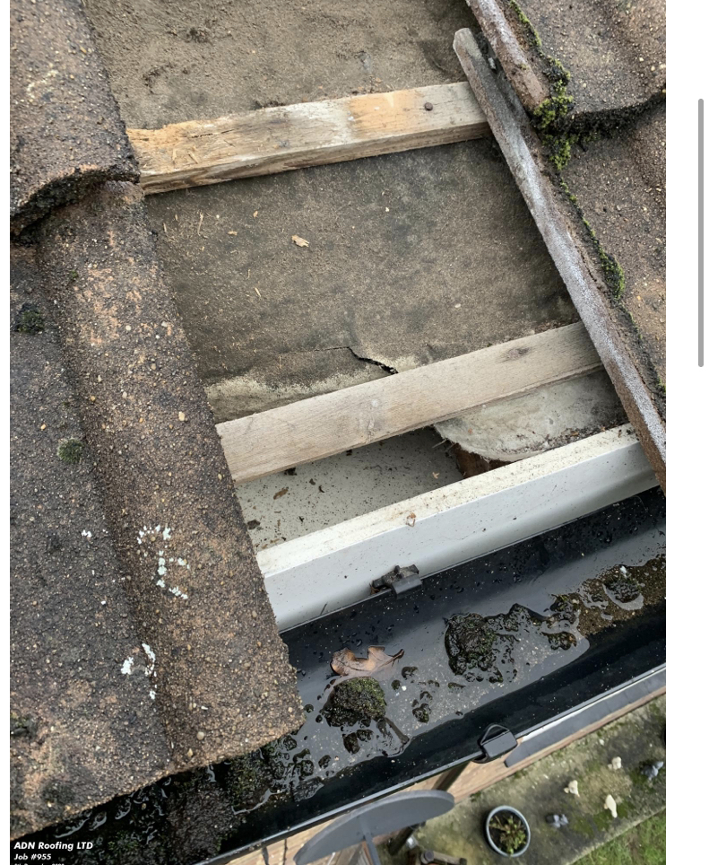

We have a leak coming into our bedroom along the line of the eaves of the house. We’ve been told by two different companies that this is caused by the sarking felt receding behind the fascia of the house (see pics).
To resolve this we’ve been told by some companies that we can just have the felt/ a few rotten battens replaced, or have eaves trays installed, in order to divert the water to the gutters.
Others have said this alone will not solve our problem, and have recommended a full reroof, as they say the problem is caused by gaps in the tiles due to degradation.
Our roof seems to be the same as most other houses on the street. Suggesting we would be among the first to need a full reroof. Are we being hustled? It’s so hard to tell who is telling the truth!

60s or 70s build then yes concrete roof tiles coming to the end of their life.
Just change the first layer of felt and fit a plastic eaves tray and use new battens.
The felt in other parts of the roof does not degrade as fast, so will last as long as the tiles.
Those tiles will have many years left in them.
Don't believe firms that tell you you need a re-roof based on a defect only in one part of the roof.

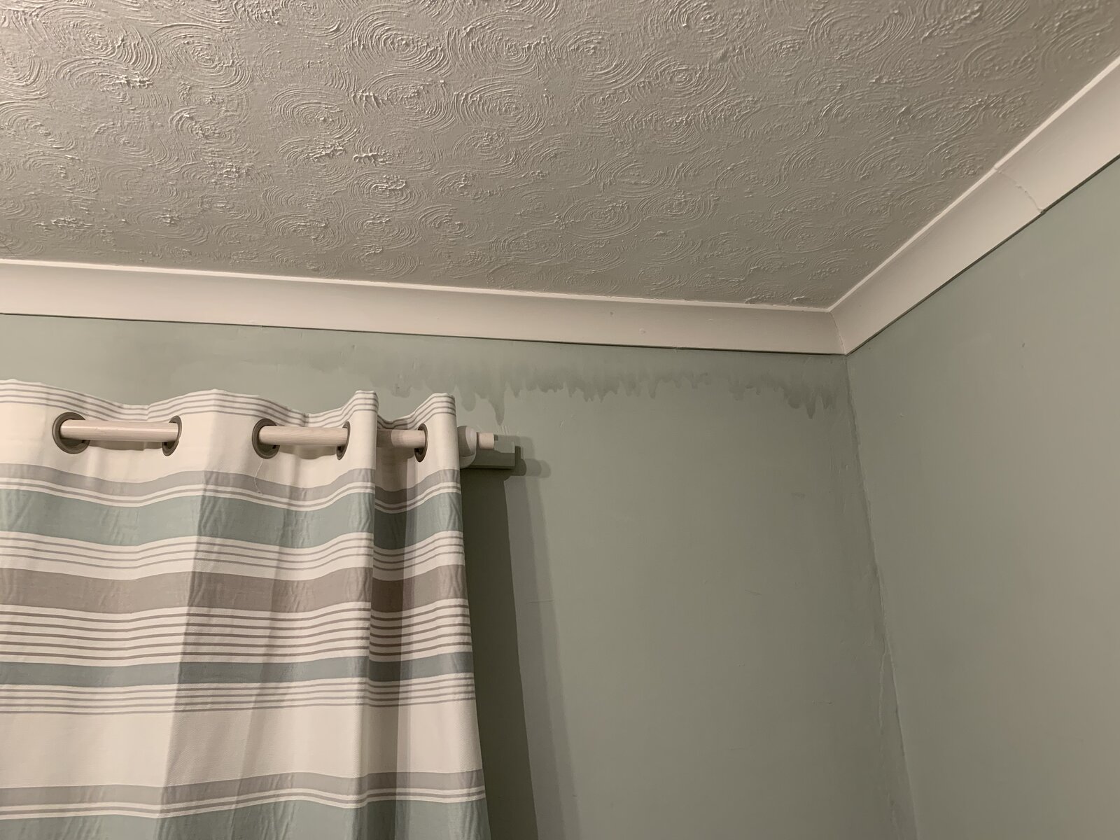

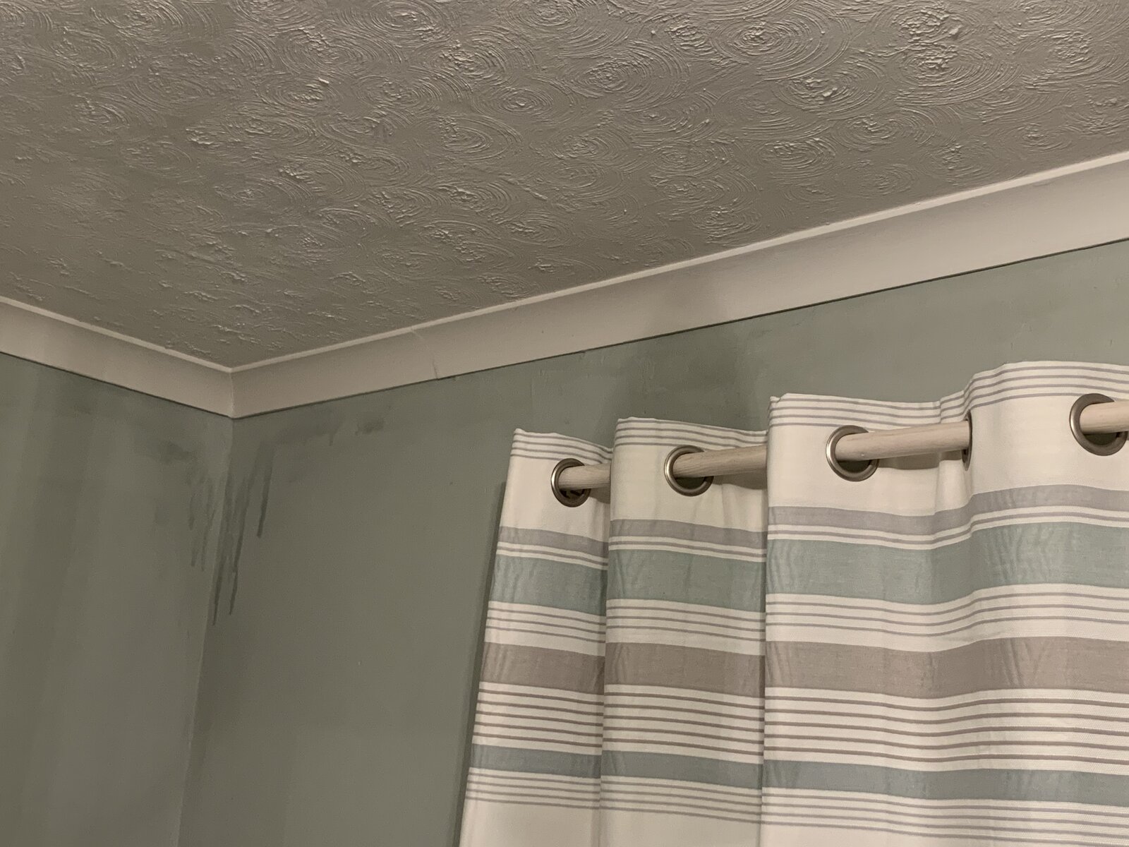

I’ve attached some further pictures of the damage in the bedroom for anyone who is curious.
Any photos of the insulated area inside the loft?
I think this is probably a bad case of condensation. Bedrooms can be bad.
make sure your insulation is up to scratch and increase loft ventilation. which it sounds like you have none
and importantly open/ventilate your bedroom windows/trickle vents make sure the bathroom / kitchen extractor is working properly
Underlay support trays are cheap and easy to fit. but i doubt it will solve this. Worth having though
