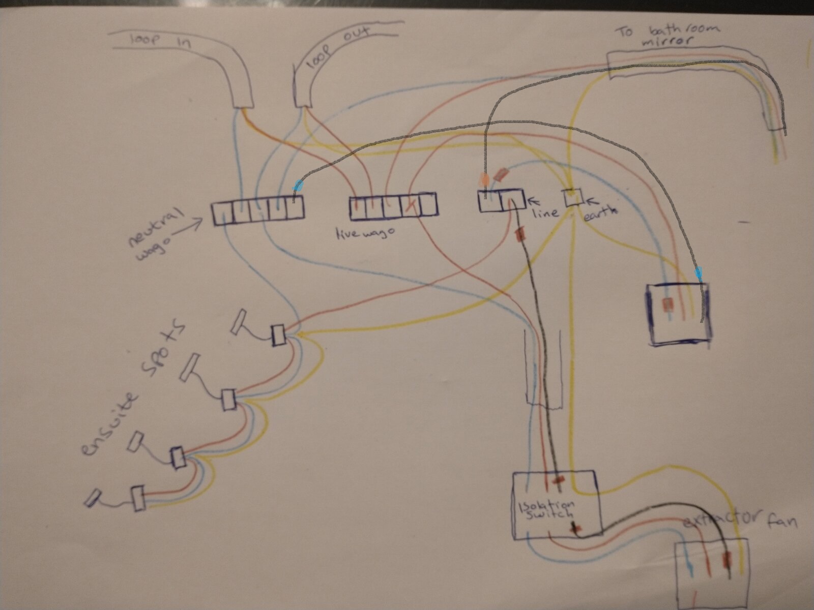

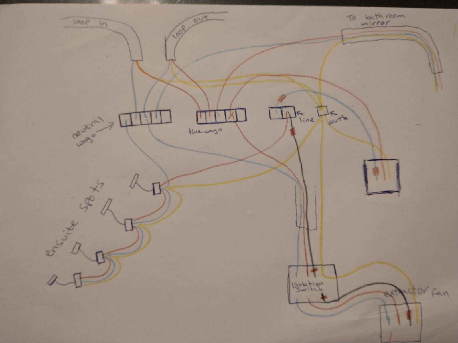

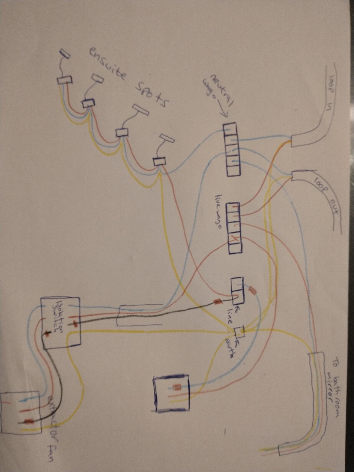

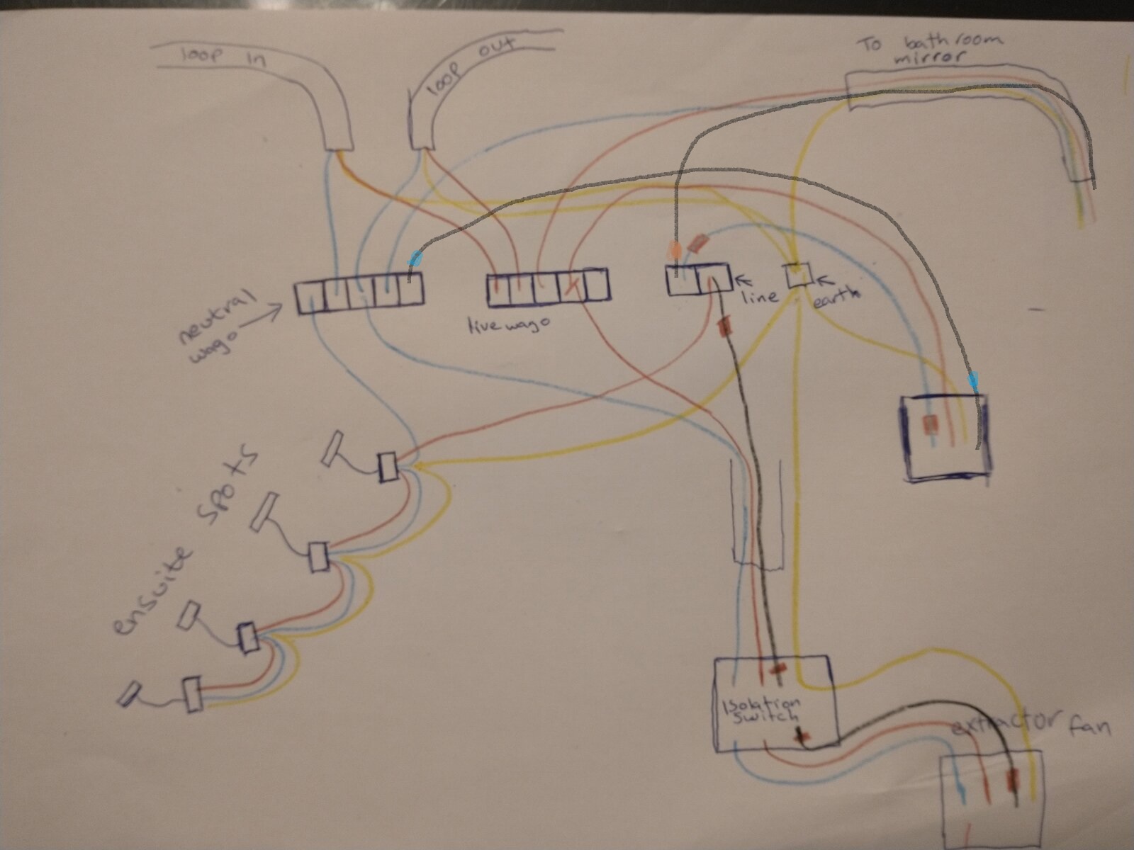

Do you see anything wrong with this.
19 Feb 2020
261
10
This is for 4 new spots in an ensuite and adding a mirror light and an extractor fan with isolation switch in an ensuite revab.
Is it possible to use a pull cord isolation inside on the ceiling in the ensuite rather than a switch on the outside.
Forgot to write switch on the square box on the diagram.
Will be using wago connectors.
Not an electrician!
Yes, if you must.
Is everything fine in the diagram.
The rest is ok.
Would suggest having a 3core& earth to the mirror, so you have both a permanent and a switched line there. Will allow the use of a mirror without it's own switch if one is wanted now or in the future.
Also 3core&earth to the light switch so you can have a neutral there, as a smart switch or similar device may be required in the future.
1.0mm² is fine. You can use 1.5mm² if you want, it will just cost more and be more difficult to terminate.
A mirror does not require an isolator of any kind, and the RCBO in the consumer unit provides the RCD protection. Adding another RCD achieves nothing other than the inconvenience of not knowing which of them or both would trip if a fault occurred.

I think I will keep it simple and have it done as it's on the diagram. I think I know what you mean but I need to see it as a diagram before I'd even consider doing it your way.
Fully agree with also having a permanent live to mirror. Very useful if needed in future.
My side suggestions.
- you could also consider adding a shaver socket.
- I did like the idea of being able to isolate the fan, mirror and shaver socket (noting that this does not have to be done). So I put them all after the fan switch so I have one switch to isolate all the axillary items.
- I did like the idea of be able to isolate the mirror and shaver socket (noting that it does not have to be done). So I put them all after fan switch so I have one switch to isolate all the axillary items.

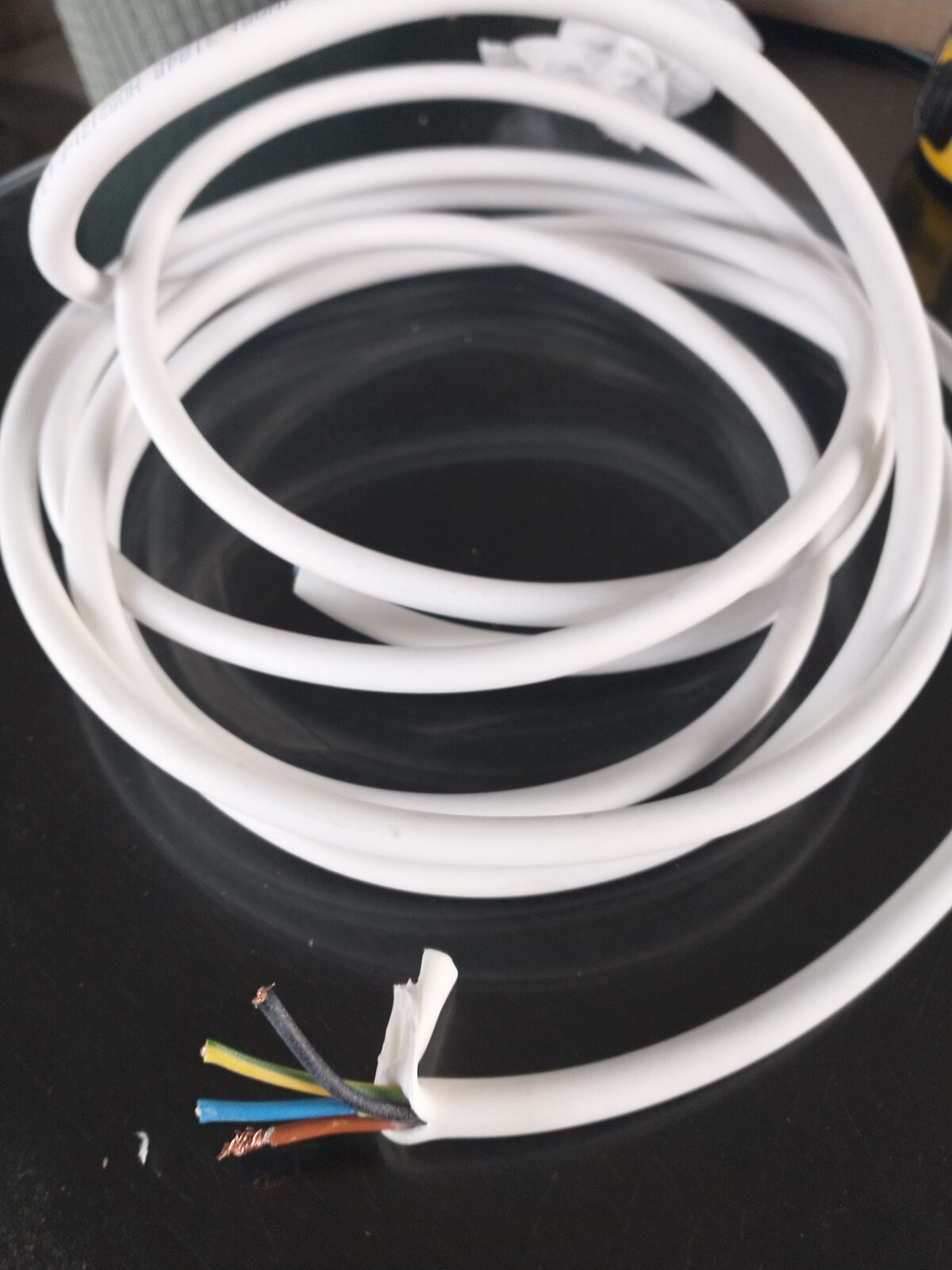

I have a few meters of this cable. It's not black, grey, brown and earth. It's round cable rather than flat. Would I still be able to use this for the isolater pull cord then onto the extractor fan.
