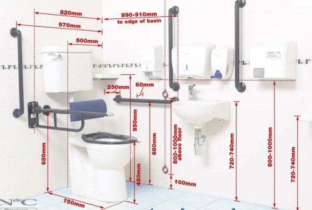

On a doc m pack is the measurement for the distance the disable toilet is from the wall 750mm to the bottom/ base off the toilet, or 750mm to the front lip?
Just follow the dimensions which come with the building control certificate with the kit you have bought.
Jeff
Download approved document M from the planning portal.gov
