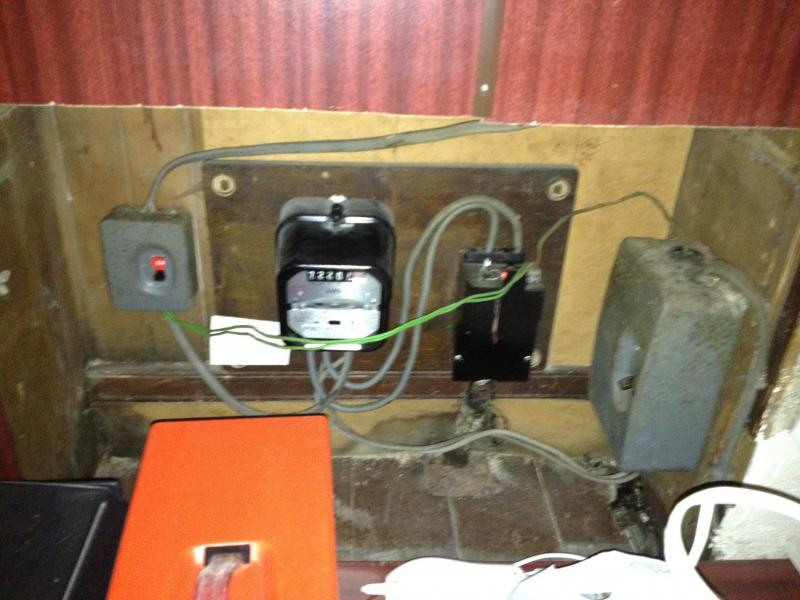

hey all, just bought a new house, was in for a peek last night (dont key keys for few weeks yet)
The electrics would appear to be ancient, which I was aware of anyway, but looked at the meter, and the board its attached to, and meter seems to be leaning forward, gave it a push and it will wobble back and forward as if its only a fixing at the bottom holding it on.
Question is who do i phone to mount it a bit more sturdy? and would I be charged for that?
Also, being that the house will need rewired, If I had say a 100A dp isolator, do you think they would fit that on the tails off the meter so the spark wouldnt need to call them in and out to turn power on and off for them changing over fuse box/rewiring etc?

just got a peek in house again for a few measurments

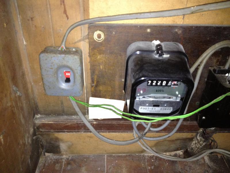

just got few on phone, so not great light, I think regardless of whats there, I need the man to refix the meter and ideally fit some new tails to a New 80/100A Fused Switch so I can look at getting fuse box renewed aswell as just about every other bit of wiring.
Got an electrician mate thats living in OZ the now, so hes meant to be coming back at new year for a bit, so Im going to rag the walls and run the cables etc to new consumer unit in different location then get him to test it and connect it up to meter/supply. worked with electrician before on a rewire so quite happy for the most part of it, but may post up for some other advice as I get on with it.
I would condemn most of that.
There are two switchfuses. One (I guess) will go to the manky flush fuseboard.
The one on the left is lethal with twin & earth not properly terminated. Also it looks like twin & earth going into the bottom of the meter. I can't see proper like because those two weedy green earth cables are in teh way.
Yikes, you need that sorting out pronto. Don't wait for the Fosters fella. Get a good local registered electrician to do it for you.
Don't know about Scottish regs, check out what's allowed without a Building Warrant here http://www.scotland.gov.uk/Resource/Doc/217736/0092252.pdf
Why can't the new fusebox go in that cupboard where the meter is?
You've got to rewire the house anyway.
Does that look like a PME compatible service fuse block you have there?
If yes, it will be handy to get a good earth connection off it. :LOL: :LOL: :LOL:
