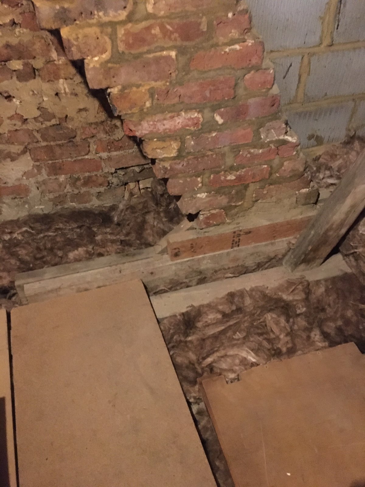

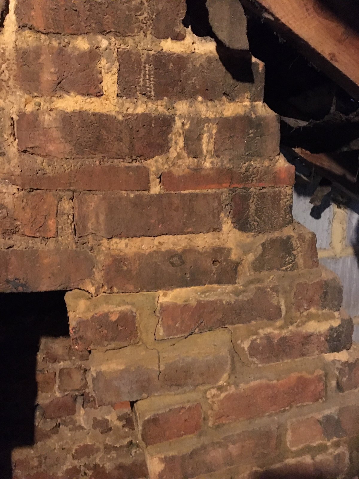

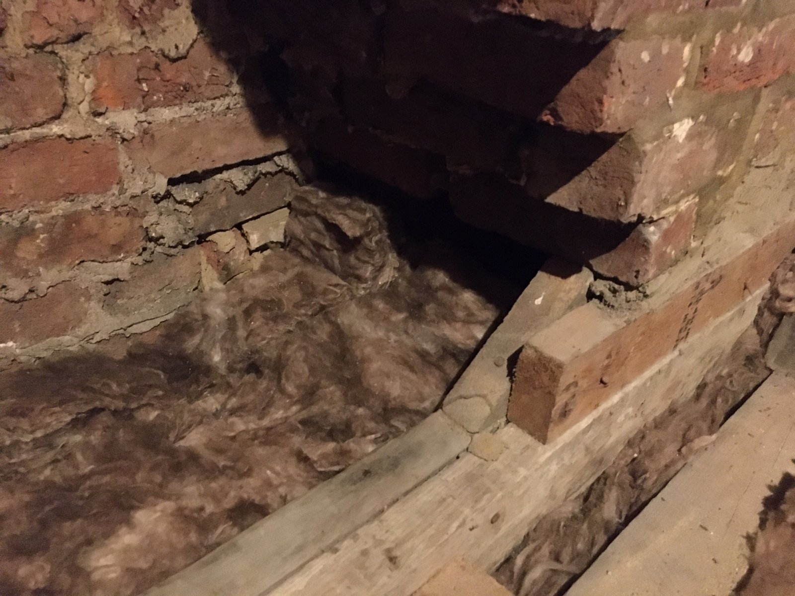

Previous owners removed one of the chimney breasts (RHS) and supported the chimney stack with a few timbers. The timbers don't even appear to support the whole depth of the stack...
How safe is this and what options do I have in case it needs to be made safer? Thanks

We moved in 2 months ago. I suspect it has been like that for a decade at least
Well, that's how many are done and if its been like it for years then it probably will be for years to come.
Otherwise, you will need to fit a couple of gallows brackets and and a plate by removing about 5 courses.

We have called a structural engineer for a separate matter, I might ask him about installing gallows brackets...

I had the same issue when i moved into my house back in 2004, whatever was left of the chimney was resting on timbers placed on the joists in the loft, i used to get cracks on the ceiling below this. Within a few months i called someone in to fit in gallows brackets with a iron plate to support the stack, problem solved.
Years later i did a dormer and had whole stack removed and now have the iron plate in the garden with a fine coat of rust.
Your pic shows no serious cracks/movement on the brickwork but does show recent mortar between bricks.

Did you have to consult a structural engineer before fitting the gallows brackets?
Tbh I wouldn't mind having the whole bloody thing removed, then I could get rid of the chimney breast in the bedroom to free up some space. It's a shared stack but the neighbour says he's not interested in having it. I suppose it wouldn't be cheap to remove though.

No, with hindsight i should have but i just called a number i had for a builder, he turned up, saw it and sent his sons on a sunday to do it one afternoon for about £200.
