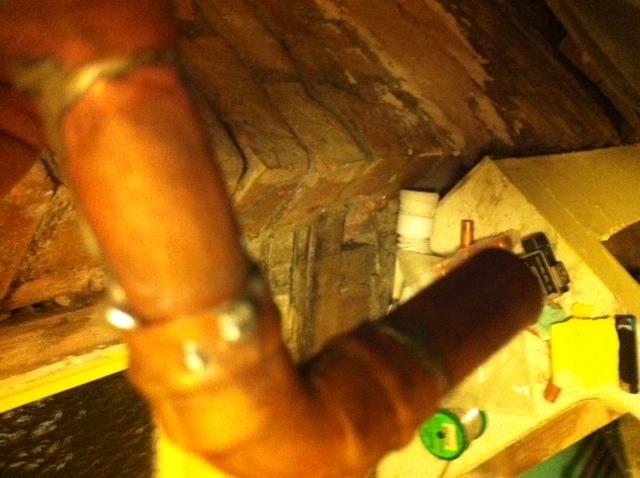

I did a number of solder joints over the weekend and non of them are leaking and I am happy with all of them except for 1.
I used yorkshire rings as well as extra solder around all my joints however after inspection the solder around one joint doesnt appear to have gone all the way around. It isnt leaking but I am worried about the future.
Its also not the neatest of joints so what do you guys think? Would I be able to reheat the joint of course after draining the water out?
Thank you
You didn't get that one hot enough for the extra solder to run. If you clean and flux and heat correctly there is no need for the extra solder. Waste of time for no added strength to the joint. Only you can see the solder ring in the joint. If it appears all the way round then the joint is sound.
It is not leaking, so the integral solder ring has probably done its job.
You should not need extra solder for solder ring fittings.
It may not leaking but not fully secured, if left like that in future, it will come loose and start leaking.
I would redo it and ensure it got a full ring of solder around.

Thanks for your replies
Can I drain the water reheat the joint and apply more solder?
Thank you
I would reheat, dismantle, clean, flux, reassemble then resolder.

if you have a drain point below it you may be able to sweat it apart, if not cut it.
ok just spent the last hour first trying to salvage the joint in the end reassembled all joints.
I guess theres no short cuts for peace of mind.
I didnt use any additional solder, its a bad habit ive picked up, trying to be extra cautious in the end messing things up unnecessarily.
