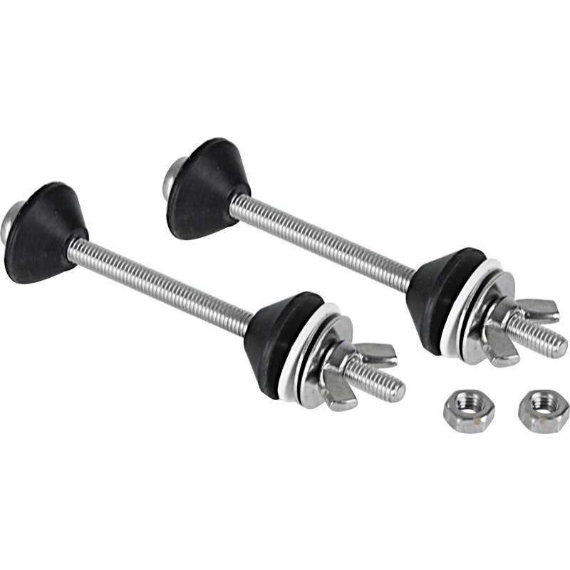

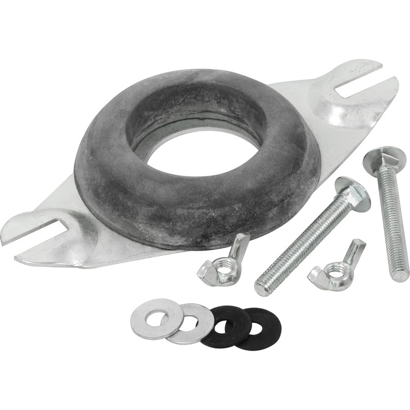

As what just pumps ^ mentioned also get a new sealing washer (doughnut) and if the securing wing nuts are seized/corroded hacksaw them off and replace with new ones,the bolts vary according to the cistern maker. a photo from below will id them. spray the wingnuts with wd40 or similar now ! :idea:
or just these wing nut bolts
toolstation sell these.
