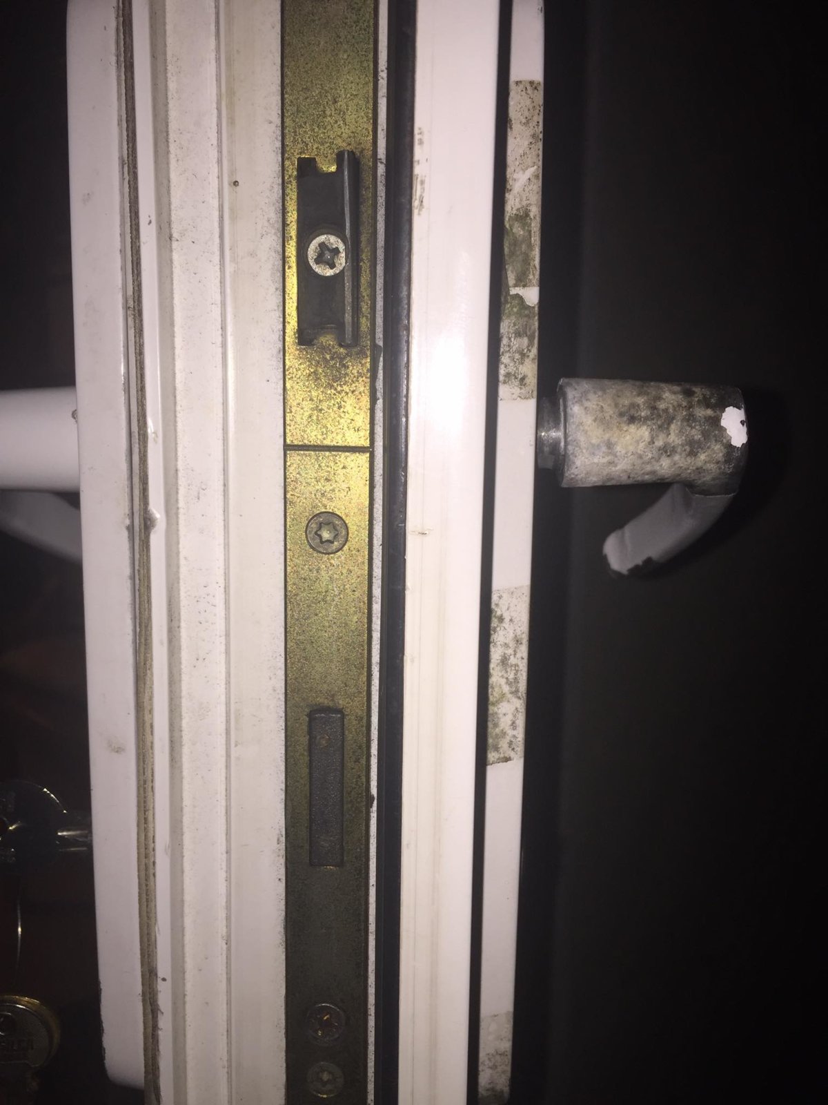

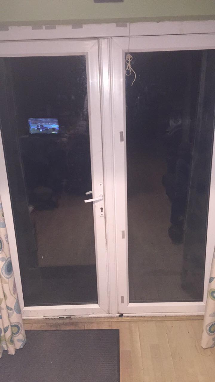

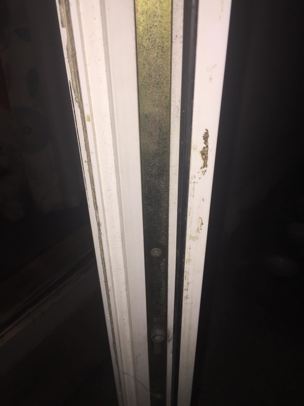

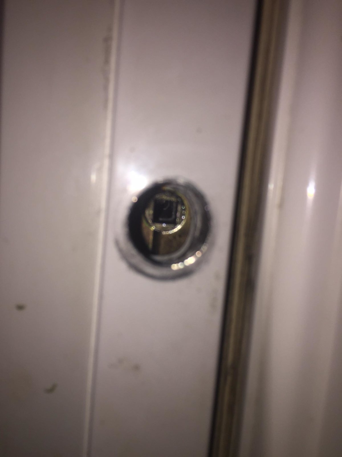

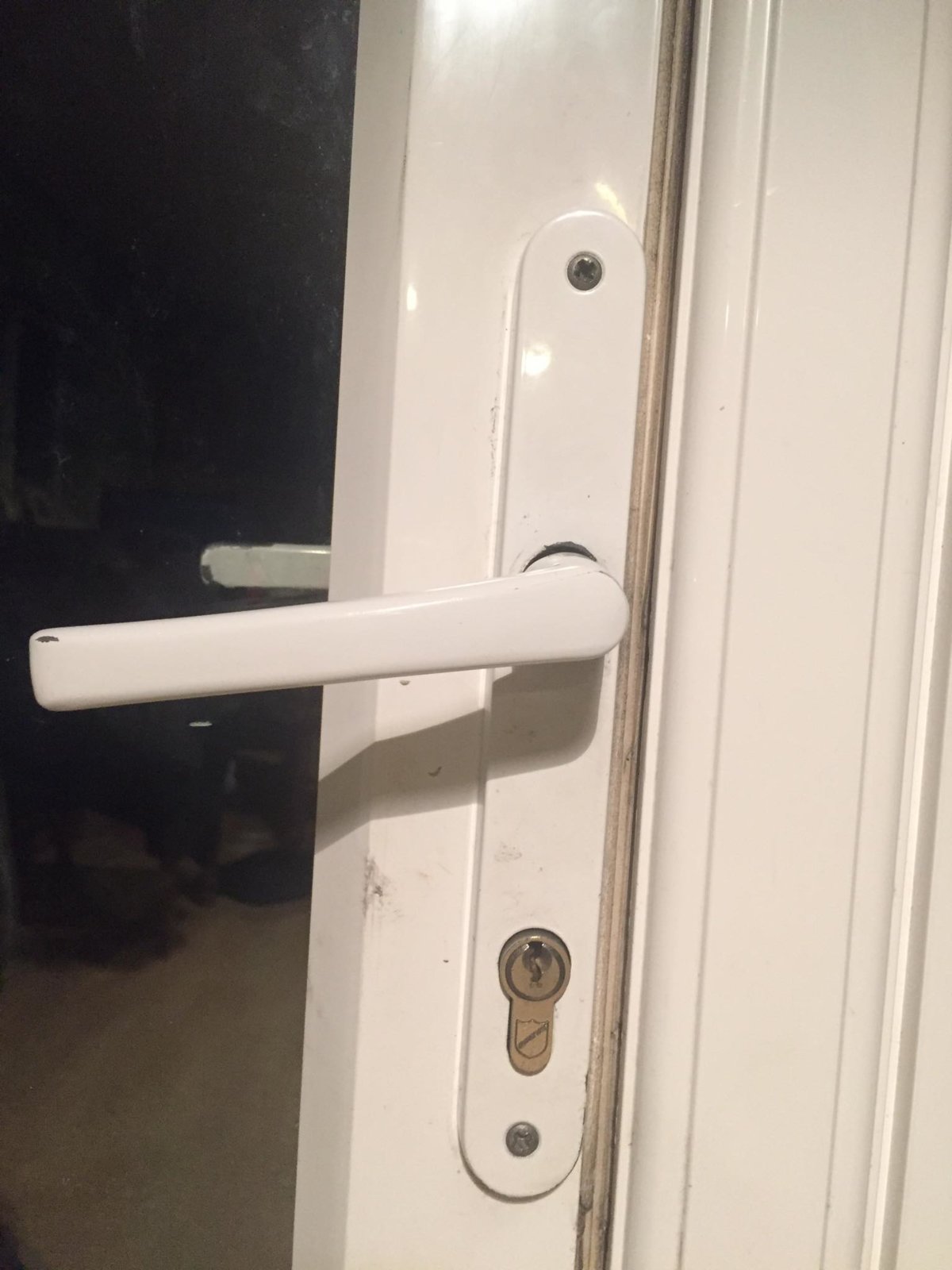

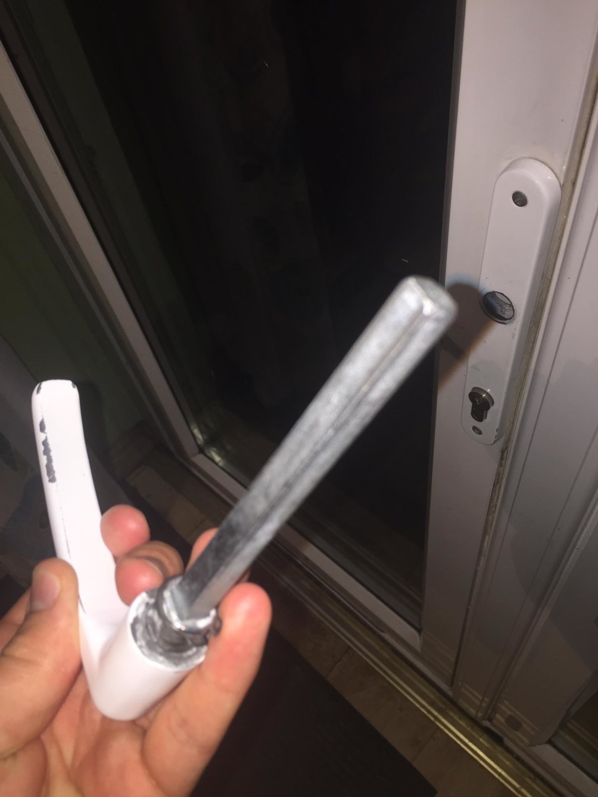

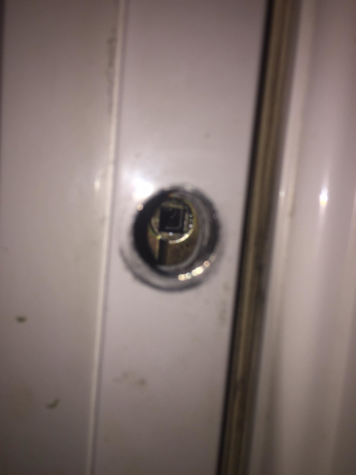

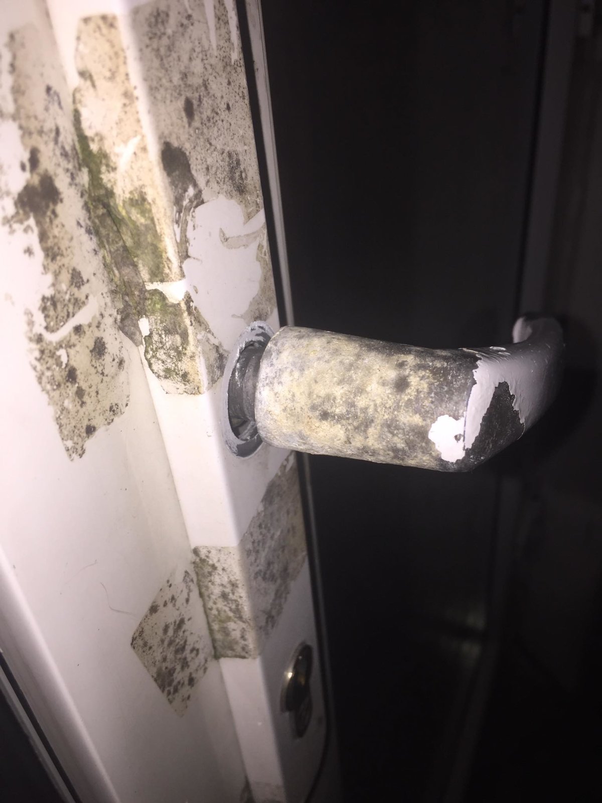

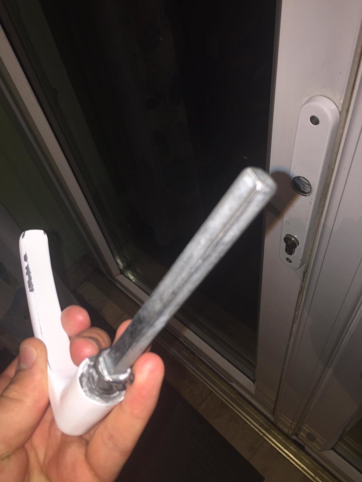

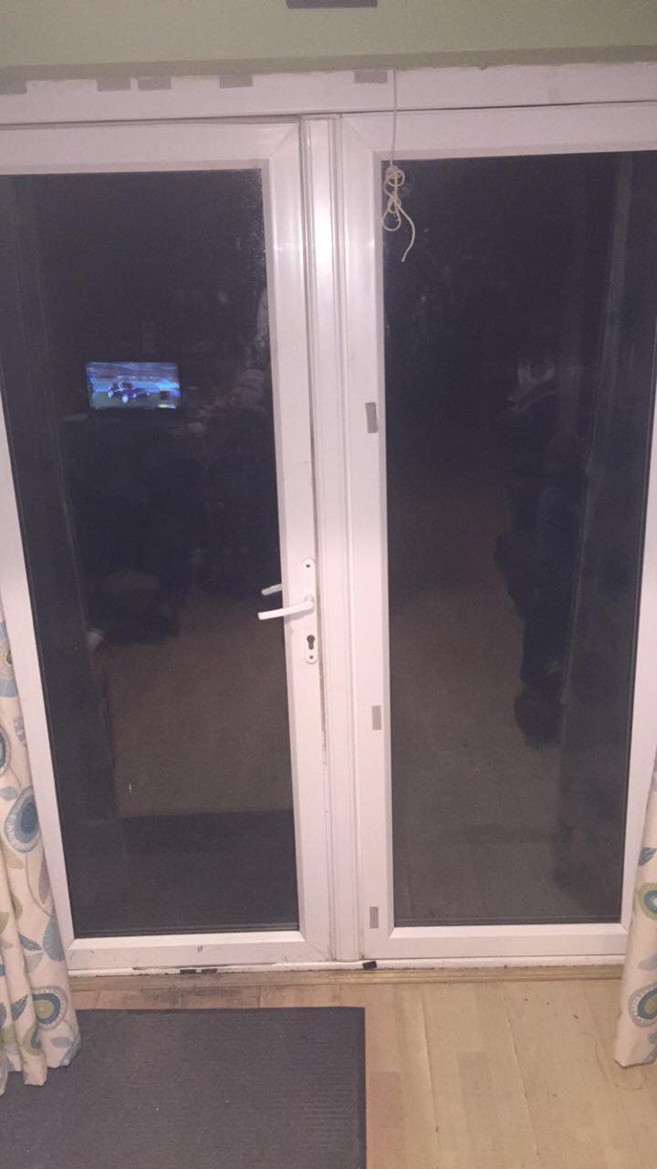

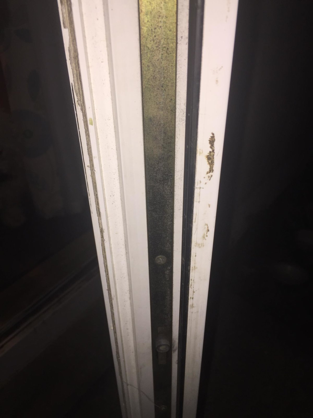

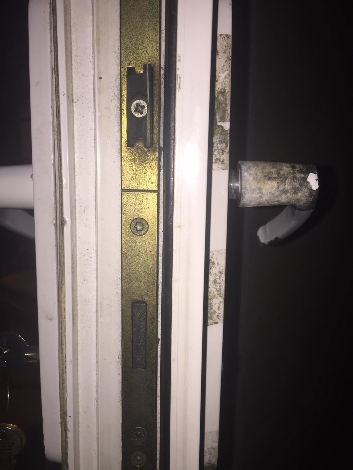

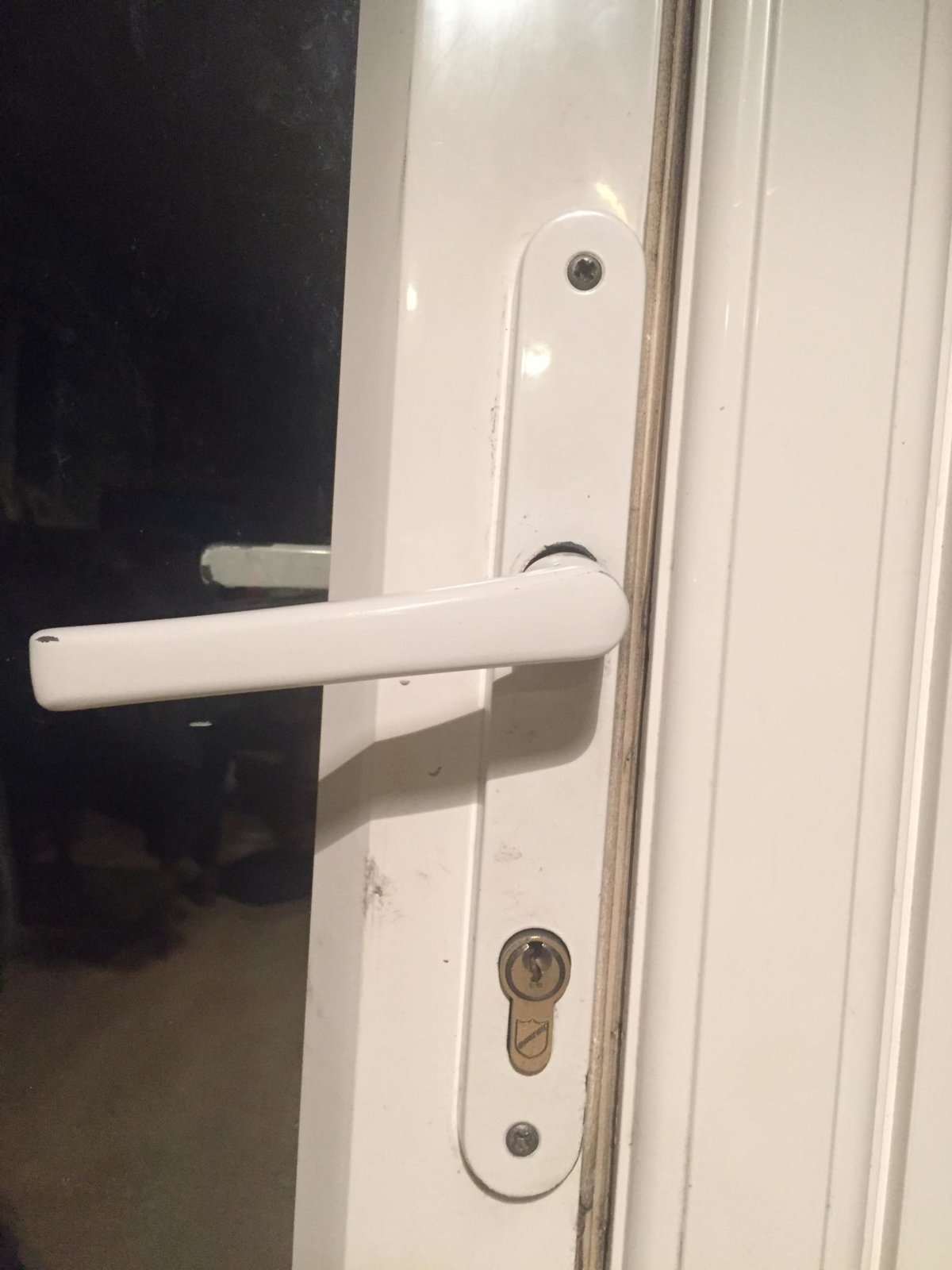

Hi guys,
Our backdoor patio (backdoor) handle has progressively been getting worse. anytime someone pulls in the door to close, the handle will come off (shown in one of the photos). All we can do right now is jiggle it back in. the door is either a double glazed or triple glazed glass panels. 91447544_3408846075798641_2210496388804902912_n.jpg
Is there any chance I can fix the handle?
If not, can anyone identify the handle for me and link me to any sites that would have the same one?.
any help is appreciated 90920821_225315275336182_3464279629785726976_n.jpg 90798454_885091705274331_4994177079751737344_n.jpg 91190851_849780888832160_7769420530783879168_n.jpg 91467912_514522755903083_2344177314612379648_n.jpg 90994951_223107448751651_5034594113576501248_n.jpg
Cheers,
Niall

Hi Niall, don’t bother trying to fix it. Get a replacement for £30.. fitting is very easy simply remove existing screws remove old handles and simple slide new ones back over the existing locking system and refit. To measure the handle size you require is the distance between the two holding screws. No need to change locks . Hope this helps.

So there is no problem with the locks or anything?
When we close the door, we have to push the handle up to ensure its closed properly. Is this normal? Will a new handle solve the problem?
