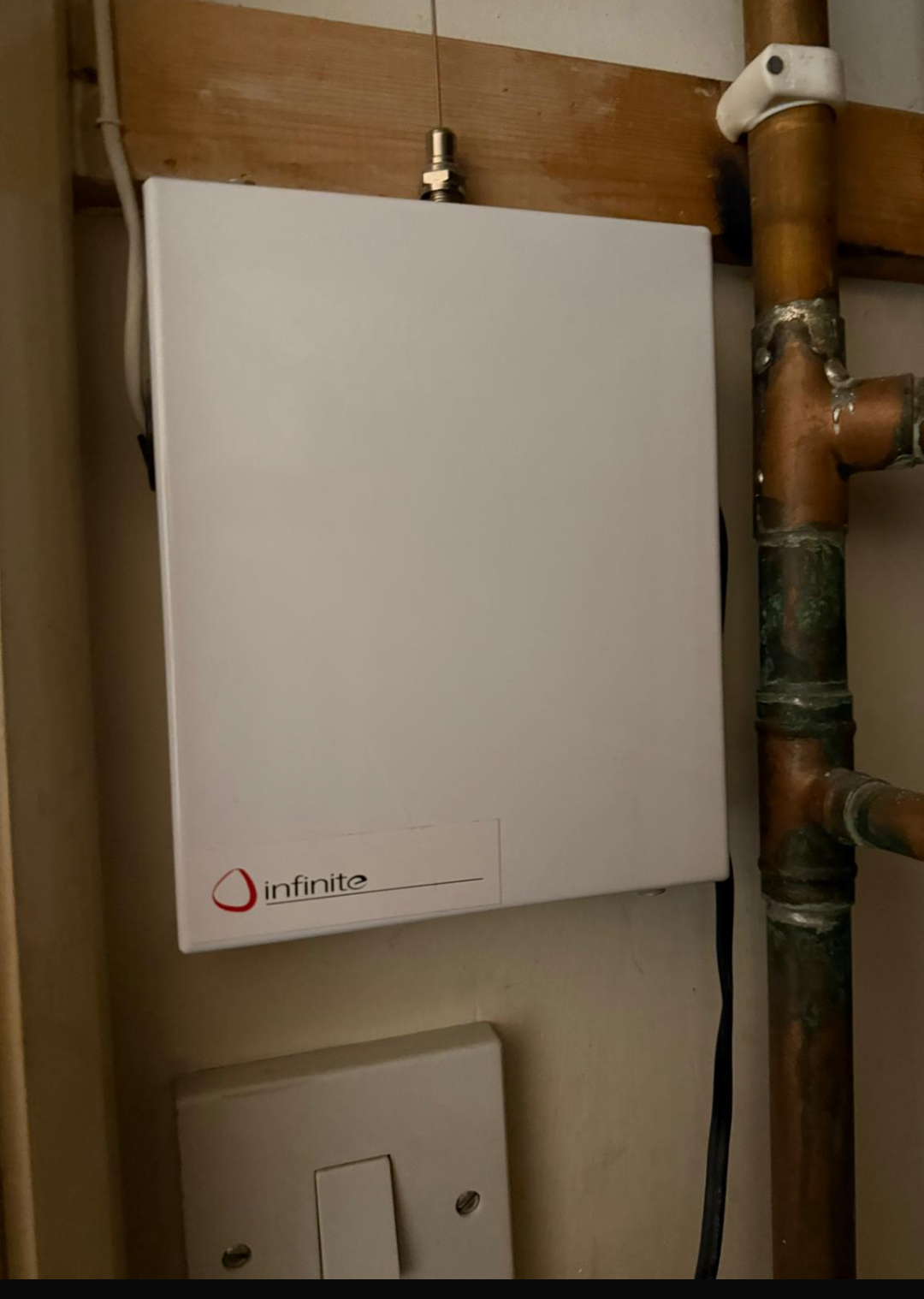

My daughter has just bought her first house and have the following box in the airing cupboard. I’m guessing it has something to do with the house alarm? Looks like alarm cable going into it and appears to be an aerial on top.

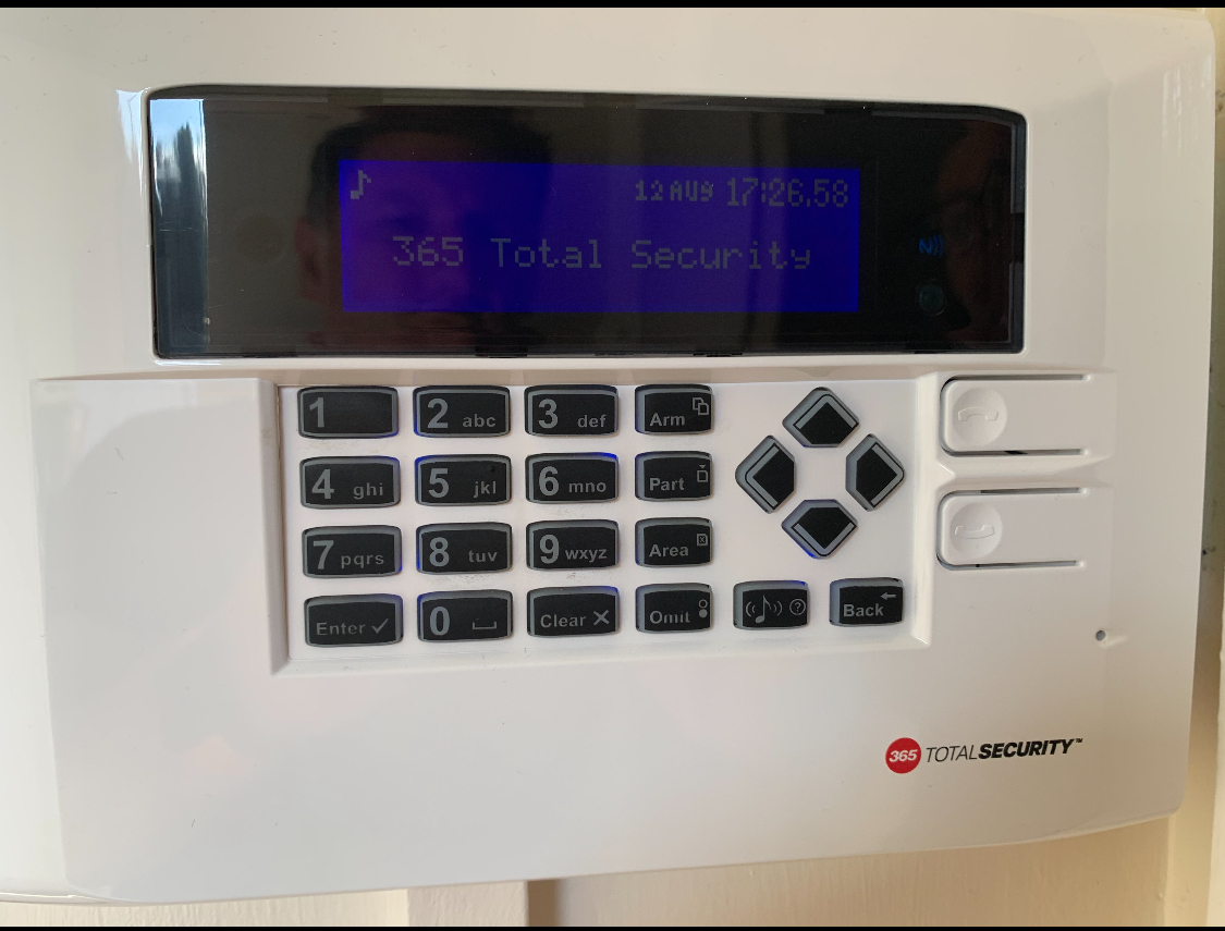

Photo below of the actual alarm panel

The first picture with the aerial is a wireless receiver for a bellbox ( infinite prime ) ….did it used to have a Telstar alarm ?
Thanks for the reply. No idea, she has only been in a couple of months. Current alarm looks to be a Total 365 system.

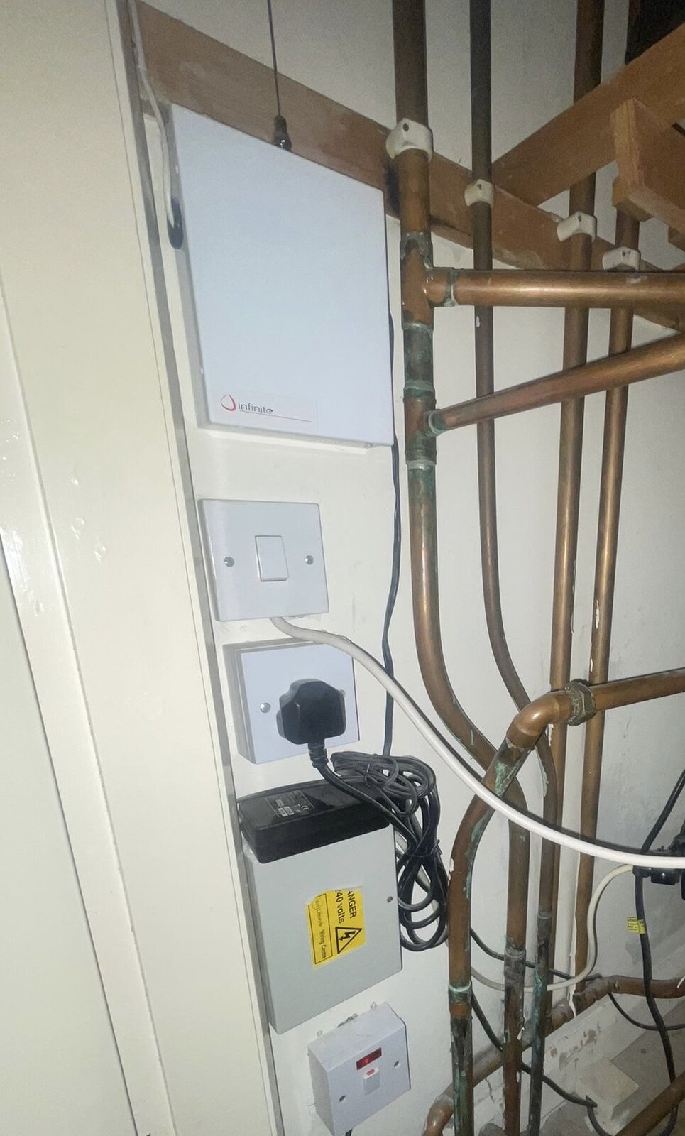

Looks like it’s been upgraded with an Orisec alarm…so I doubt if it’s in use ….But it may be using the power for the bell ? Post another picture with the black wire coming out at the bottom ( where it goes is it plugged into something ?)
