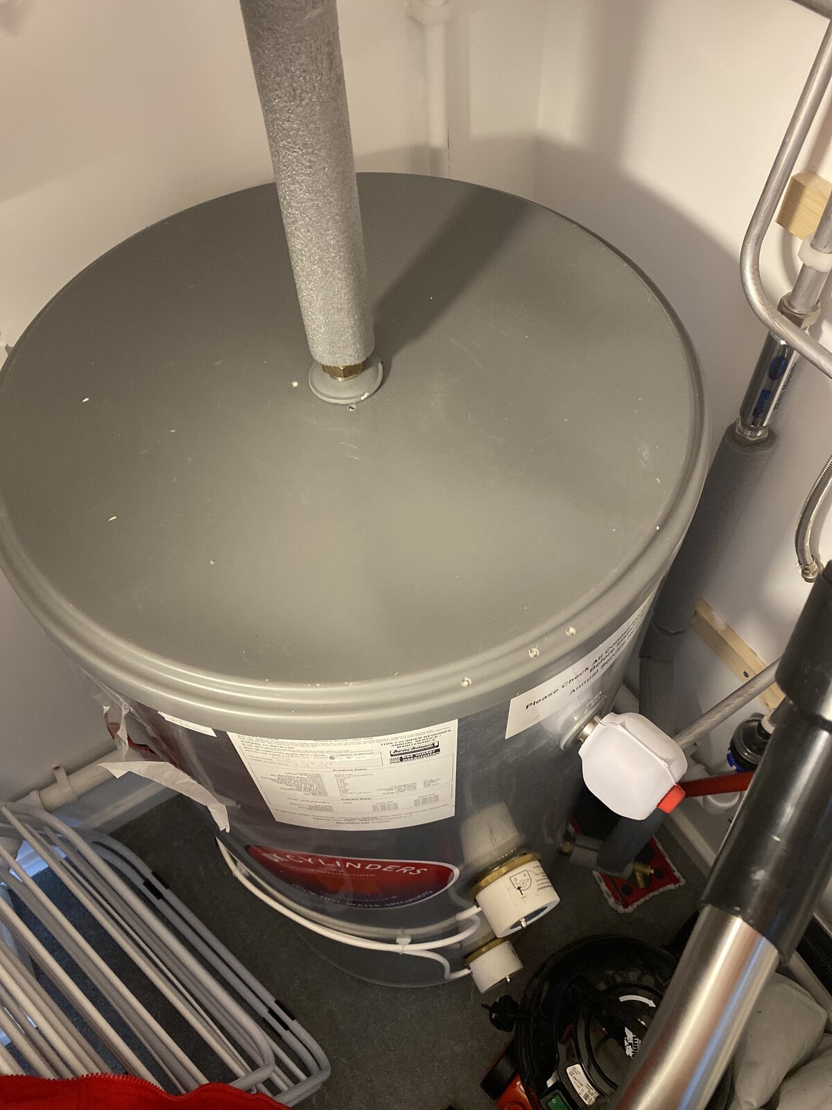

Does anyone know where I can locate the thermostat on this cylinder to reduce the heat?

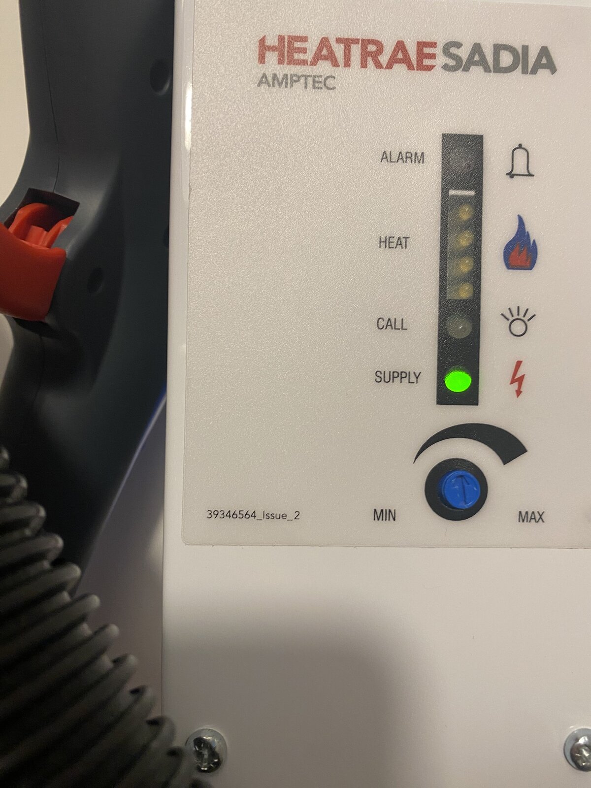

I’ve been trialing and error why my electricity is so expensive in this brand new build well insulated flat where I don’t use heating.
Bills still coming up to £157 pm.
Managed to reduce one area of heat where the installers had set it right to the max!!
I spoke with heatrae and they said the control panel blue dial was set too high and shouldn’t have been. This may help my bill slightly

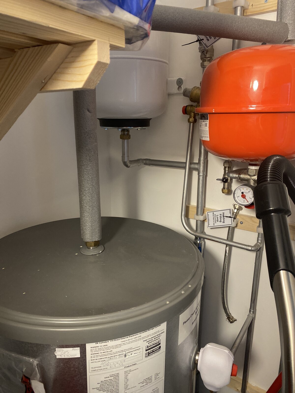

However, he said it sounds like I need to reduce the hot water in the cylinder by locating the thermostat.
I can’t seem to find it on the cylinder.

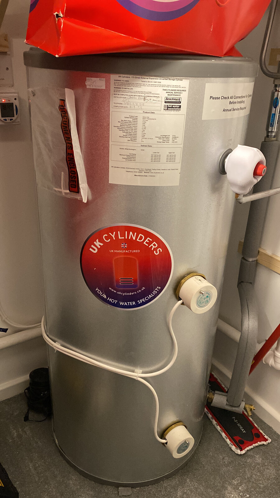

Isolate the supplies. Remove the white round covers on the heating element (dome nut). Thermostats are underneath each cover.

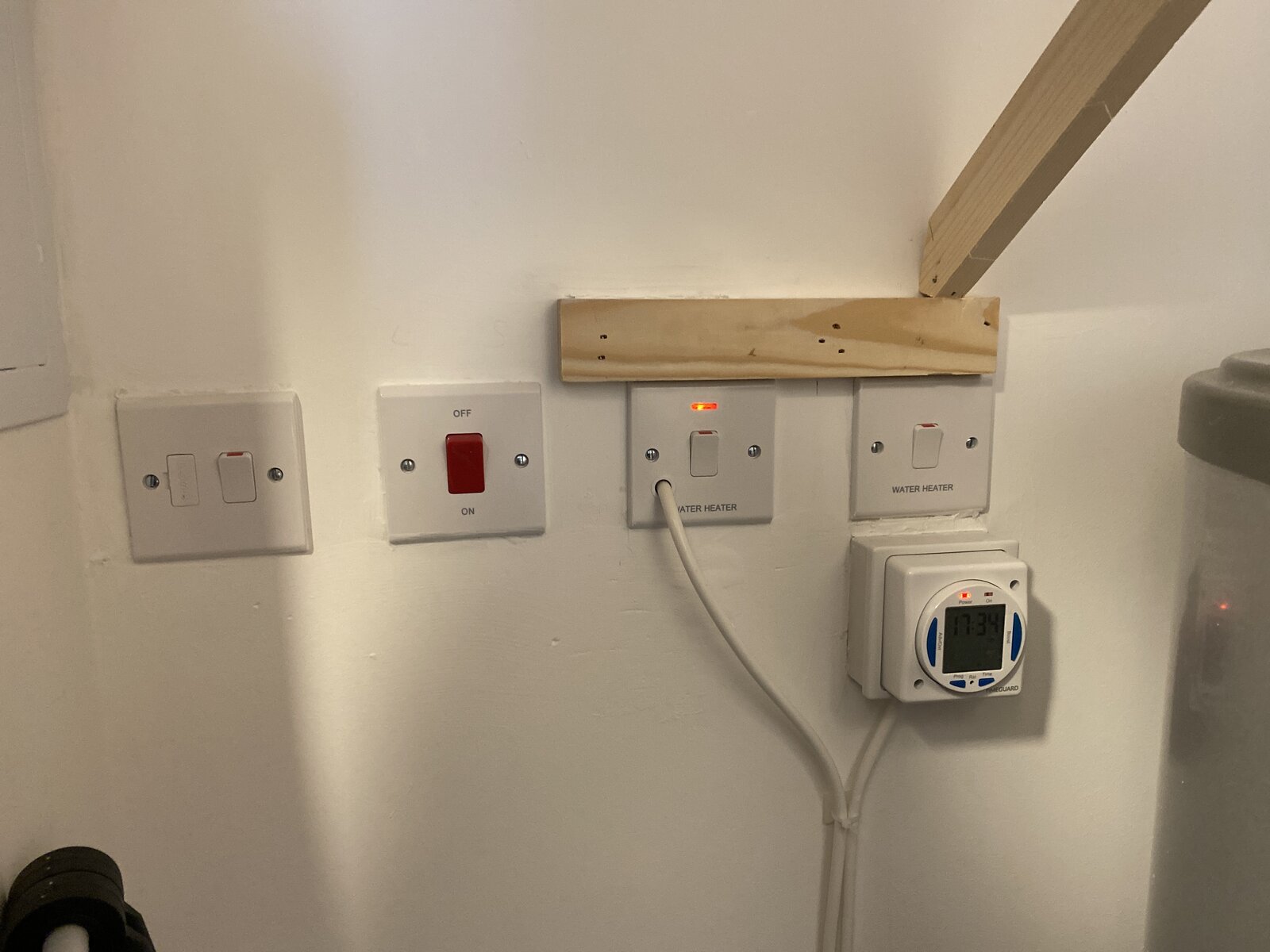

Oh okay thanks for that! I’ve never done this before do you advise I do it?
Isolating the supplies would be turning off these switches right? Sorry to sound so dim
1. It appears that your water is heated only by one or both of the immersion heaters.
2. As Rodders53 has said, the immersion heaters have the white circular covers held in place by a domed nut.
3. There will be mains electricity voltage inside these covers. Unless you are absolutely certain you know how to isolate the electricity and test that is is isolated, do NOT touch these covers.
4. It is usual (though not certain) that the lower immersion heater is connected to a cheap rate source of electricity (Economy 7 tariff or similar). This heats the entire cylinder full of water up on "cheap" electricity overnight.
5. The top immersion heater is normally connected to standard rate electricity, and is meant to offer a means of topping up the hot water should you run out.

7. I'd suggest you trace the cable from the top immersion heater to its switch, and turn it off.
8. See how you then get on for hot water. If there is none, or very little after a day, the lower immersion heater may be switched off, may have tripped its overheat thermostat and need resetting, or may be faulty.
9. You shouldn't reduce the immersion thermostat settings below 60 degrees, as you would then run the risk of legionnella.

The top immersion I heater I take it to mean it’s the heatrae one with blue dial?

Top immersion = white cover domed nut halfway up the tank
Bottom immersion = white cover domed nut near the err bottom of tank.
BOTH switches labelled water heater should be turned off before removing the covers. You don't sound confident enough to be removing the covers, though.
