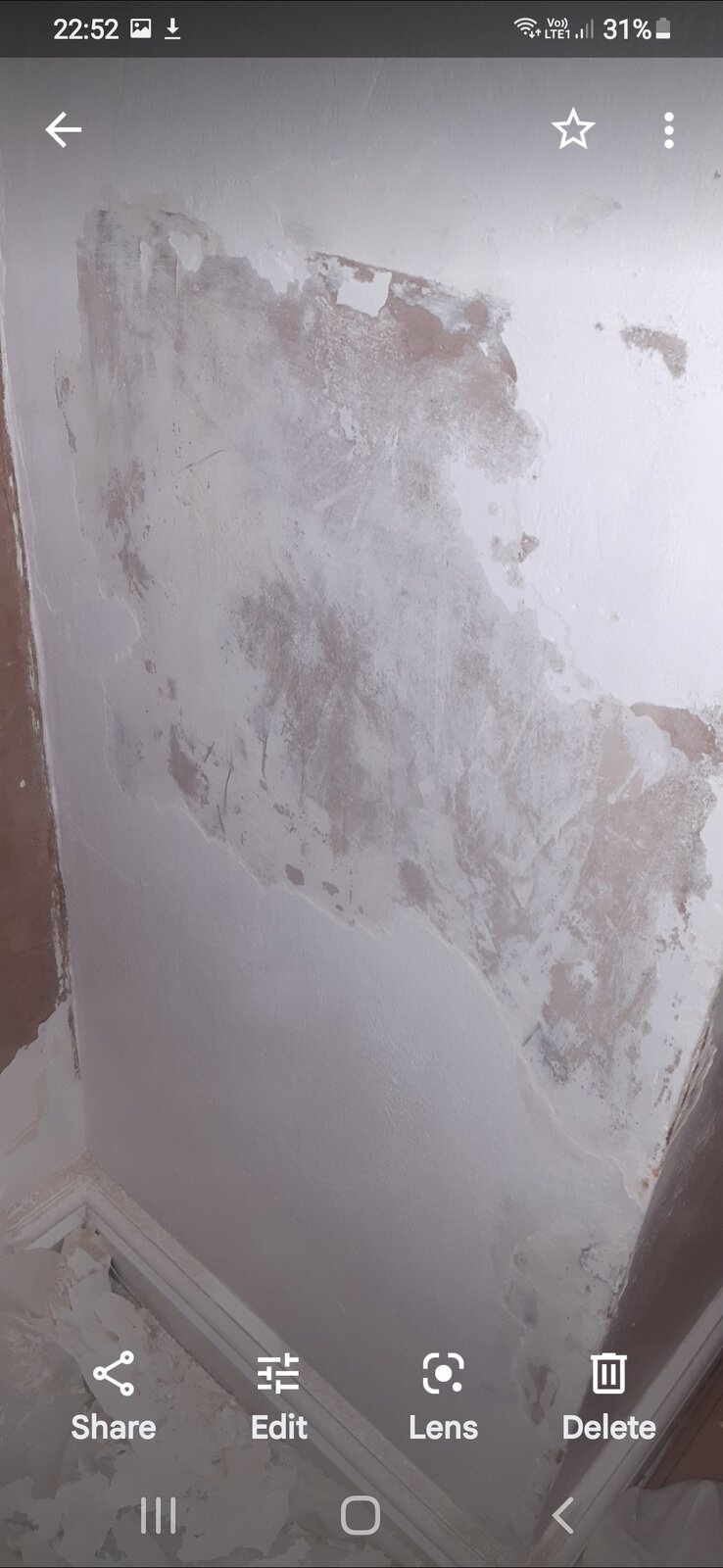

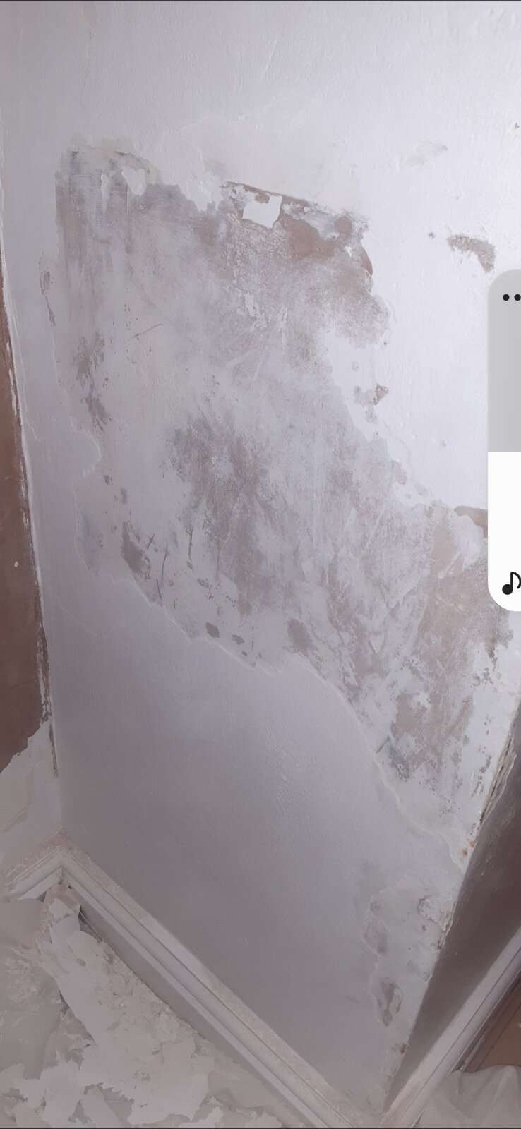

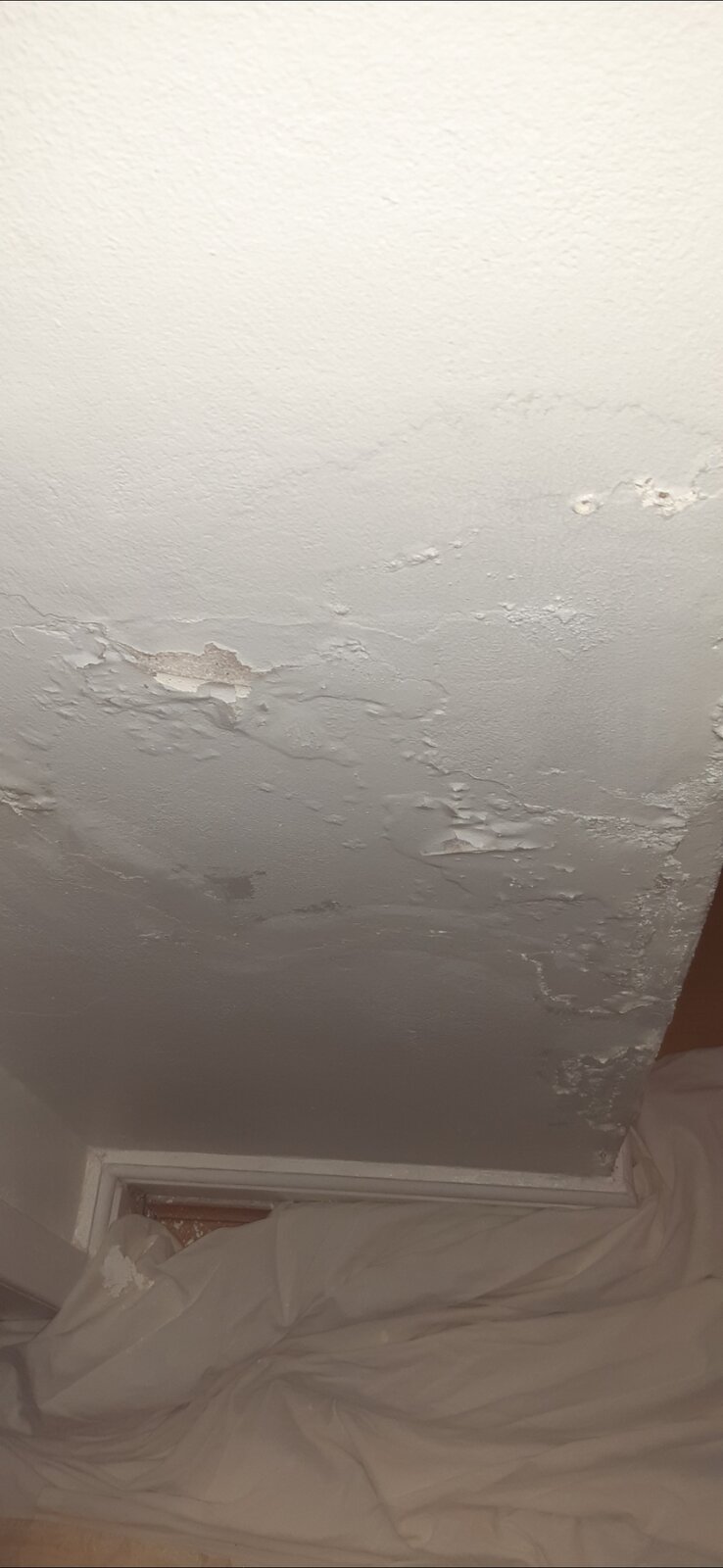

The last one shows the paint bubbling, the second after I scraped it off.
It seems to be on the corners, which makes me wonder if it's condensation on the metal corner under the plaster.
But also part way up the side of the disused fireplace.
I am wondering about the chemical dpc as I had a damp company quote me for that.

You show the LH side of a chimney breast - can you show pics of the front face and the RH side?
If you have similar damage elsewhere in the flat can you post pics of it?
The metal corner bead is rusting, indicating the presence of some kind of damp.
The skim finish plaster looks to have been applied over existing damp damage - maybe to conceal it?
Is the back of the c/breast an outside wall?
Has anyone been under the floor to examine the condition of the joists - or if you still have a hearth
below the FFL?
