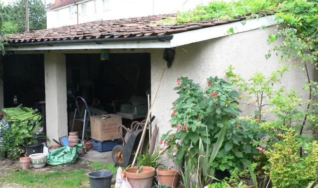

I need to put a new roof on a large outbuilding in our garden - we call it "the garage" but it isn't actually big enough for cars: it is about 4.5m x 8.5m. The roof has a pitch of about 10 degrees. It is currently tiled and leaks terribly (not surprisingly for such a shallow slope).
I am planning to cover the roof with WBP plywood and a couple of layers of felt. The question is: can I get away with 12mm ply? The main reason to avoid 18mm is just the difficulty of getting the panels up there and moving them around.
If I have to use 18mm ply, is there any disadvantage in using smaller panels so I can handle them?
the existing rafters are probably too thin to support 18mm ply, which is quite heavy.

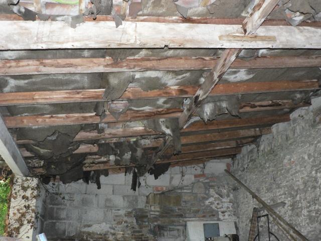

Tell us the size, spacing and span.
Some photos of the underside would be nice.
I applaud your use of WBP rather than chipboard or other inferior boards that are not strong or water-resistant
12mm may be OK on joists at 400 centres. But it depends on what felt system you are having - some layer systems may be relatively heavy per m2.

The joists are 50x100mm (2x4) spaced at about 530mm (21") and about 4m long. There is also a supporting beam going across but I am not convinced it add a lot of value.
Here are a couple of pics:
The joists are pretty marked by water but seem to be sound still - but maybe this is a good reason not to put too much weight on them...

Hi The weight of the existing roof covering far exceeds the new proposal. 18 mm ply has a mass of approx 10kg/M sq. The tiles you have at present are nearer 8 times that.
