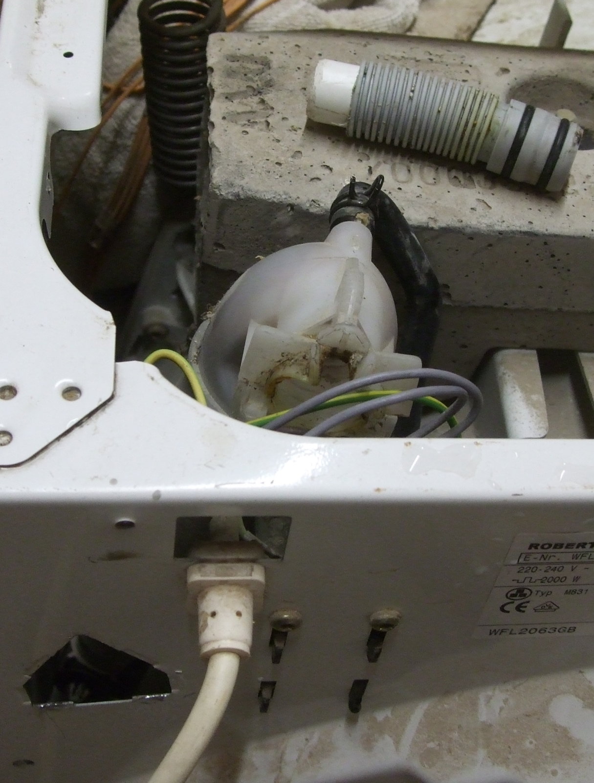

My washer is Bosch WFL2063GB/12. It's 22 years old. Fixed it twice. I now have a feeling that the local council will put me through hoops if I myself replace the hose (that's assuming I can get one). So, I think it likely it's less hassle to just buy another washer. But, I attach a picture of what I've got. The picture shows the part of the hose that was left in the washer before I managed to extract it. Not sure how easy it would be to replace a new hose - my luck, possibly a nightmare. :) Wonder if a washing m/c repair person replacing the hose would satisfy the council. Or get washer from Ebay for next to nothin'. :) Probably my best option when I think about it.

If I buy a new hose & I have a washing machine guy fit it, how much should the charge be for fitting, do you think? (Although I guess it's not likely fixing would be economical having a washer guy fit the part).
OK, so if a washer guy fitted it (just to satisfy the landlord/council) and charged £15, my total costs would be £15+ £26.48 = £41.48
