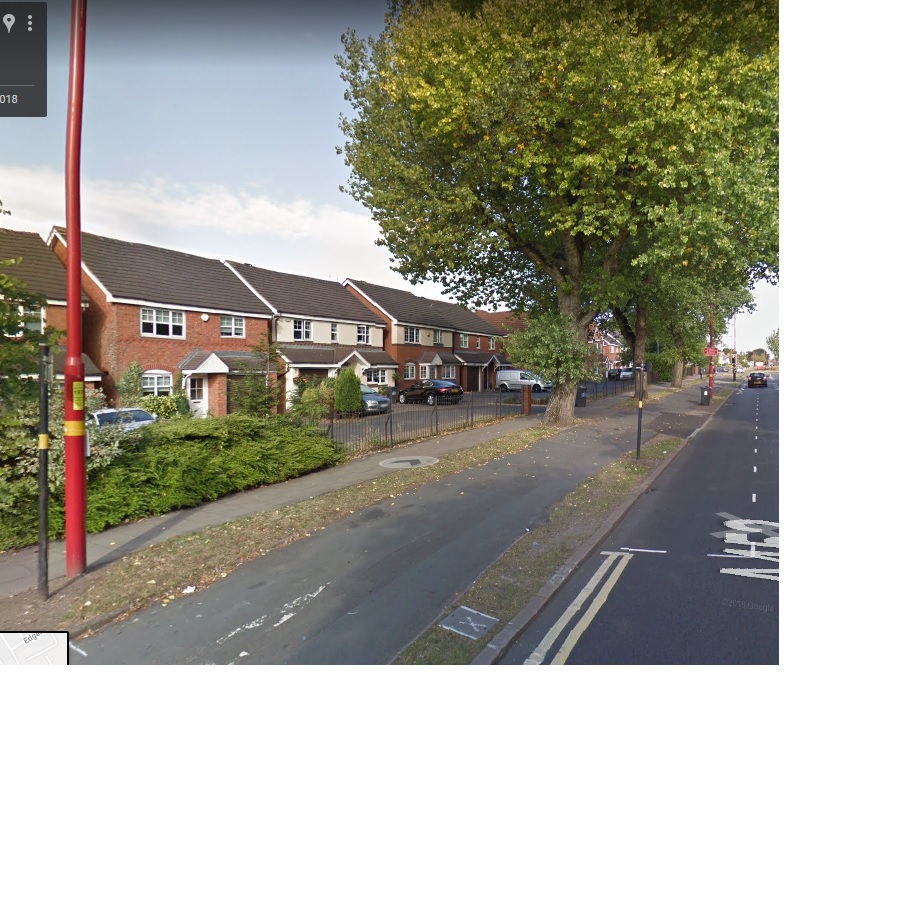

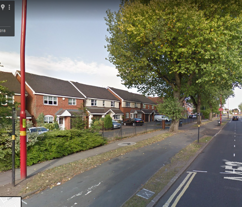

My own little anecdote about "street scene". Birmingham's policy of not allowing extensions to the boundary to avoid "terracing" is defended to the death - and yet they manage to acheive this quite sucessfully with their new builds. You will struggle to get a ladder up vertically between two houses without scraping your spine.
