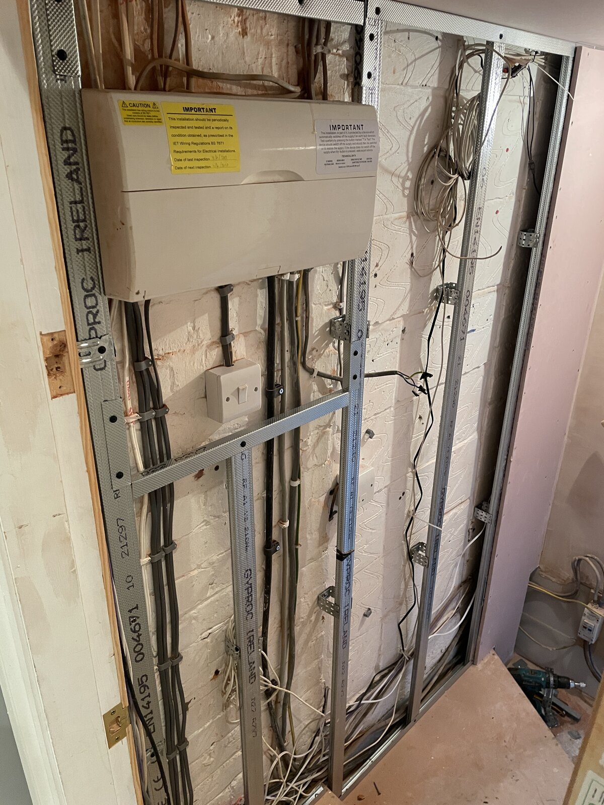

i'm sorting some plastering in our cellar using metal stud so that we can pass cables etc behind without issue.
As an afterthought i wondered if there is any issue in having metal stud right next to the consumer unit- does it pose any interference with the electrics (im talking the power, electricity rather than physical interferance)
on the side closest the edge there just physically isn't the room to move it further away, its not touching the conusmer unit- but is only about 15mm away
N.b i'm not touching any of the electrics and the stud is well away from all wires and connections.

There are rules about hiding wires less than 50 mm and safe zones, but with cables, not singles, what your doing above and below consumer unit would comply, but some of the cable to left will not be in safe zones.
AFAIK the studwork needs earthing too? (someone will confirm)
The regulations I viewed advised you were ok as long as cables were 50mm below the surface- if not then you had to cover it with some protection.
is that not the case- I made sure there’s a min of 5cm between surface and cables
Not quite. The regulations are very specific on what is required for cables that are ruin out of the recognised zones.
"Cover with some protection" doth not butter any parsnips. The cable must be of a specific type. ie with an earthed screen, such as steel wire armoured cable, or run in earthed steel conduit. A bit of flimsy aluminium, or even metal cable capping does not comply.

yeah ok, my comment on 'cover with protections' was a bit flippant- i meant proper earthed steel covering.
here is the summary of guidance i found form this page - Electrical Safe Zones for Running Cables Through Walls and Under Floors | DIY Doctor
Sometimes it is not possible to run cables in these zones. It is allowed so long as the following guidelines are followed:
  1. The cable must be over 50mm below the surface. If the wall is made from metal then it will need RCD protection, or
  2. The cable should be armoured with an earthed armour or metal sheath, or
  3. The cable should be in metal trunking or conduit which is earthed or,
  4. It should have protection from at least 3mm steel
all the cables i have look to be covered by these as they either:
1)fall under the safe zones- directly above, below or horizontally with the units
2)fall into safety zones of within 150 mm of corners
3) are a min of 5cm below the surface- these will all be 60-70 below the finished wall.
if someone believes this not to be the case- can you confirm why from the pic.

The problem with that is; the cables were run safely (visible on the surface), now you are hiding them.
Imagine in n number of years all that lot covered over, would you expect a cable just there where you want to drill a hole ?
How does that CU get replaced (for one that is ½" wider, one 3" narrower (will be pants) or one with a different cover design) ?

Im lost as to your need to post, i completely agree that the issue is they weren't hidden now they will be- hence the point i've made all the way through that i don't know how many times i can say......
I WANT THIS TO BE COMPLIANT AND SAFE!!!!!!
ive never said anything different- and no one has advised of anything that is'nt safe that they can see.
how does the CU get replaced- same as any- you make the hole slightly bigger or cover up around it- thats all asthetics- but i'm really not worried about something that may or may not happen in 5-10,15 years time
