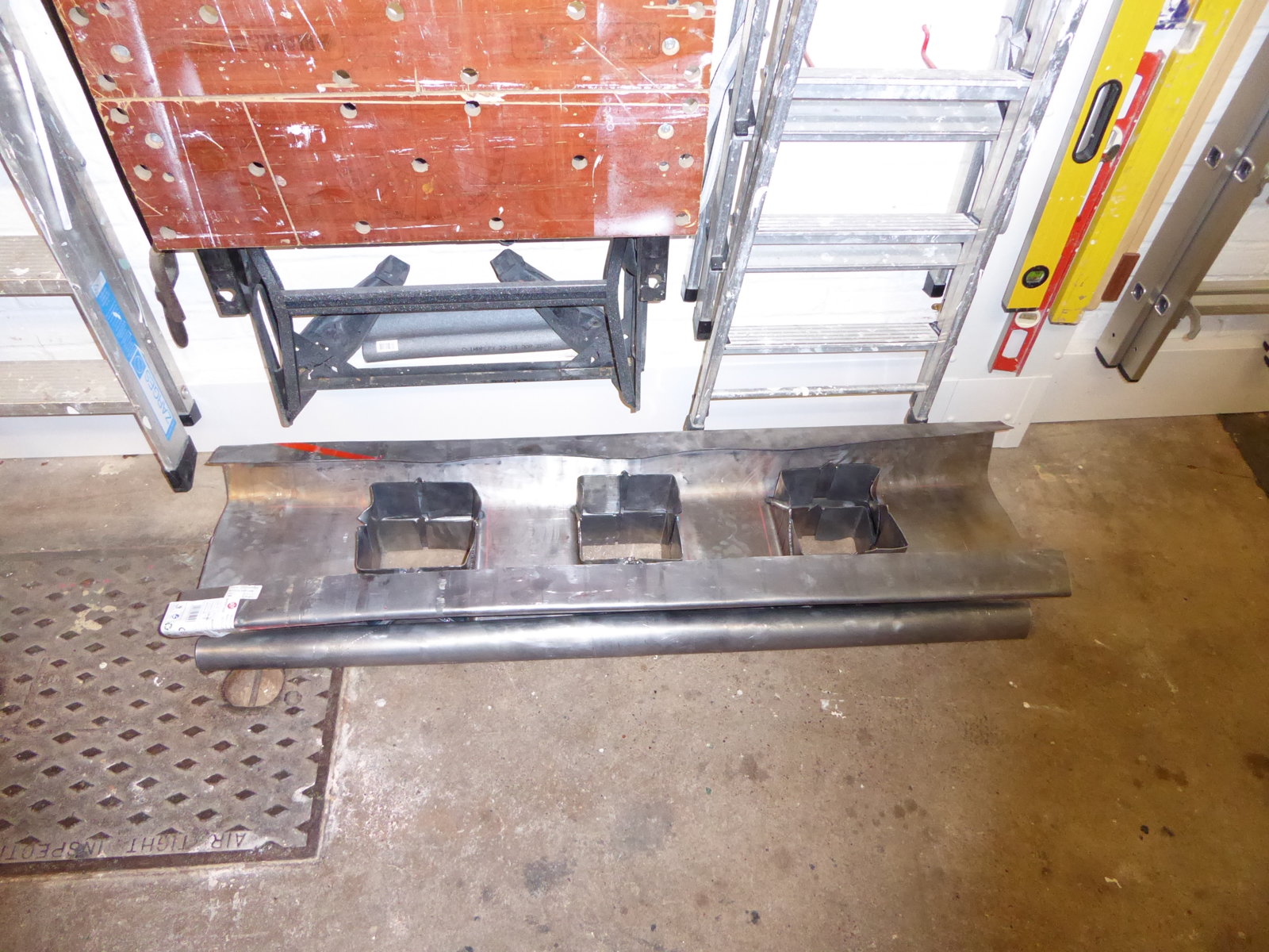

We have faffed about with it for 10 years, tried everything and spent a fair bit of cash, that's why we decided to demolish and rebuild. It depends on what you have tried so far and whether you want to try a few cheaper options first. The bricks on our house are very porous and have lots of small cracks in them naturally the outer wall does get pretty soaked in heavy rain but the cavity keeps the inner skin dry (that's why cavity wall callers get short shrift at our house!) the old DPC in the chimney was felt and chances are not doing much.
The new one has two lead trays built in. Boy are they heavy B*****s:p Lead trays.JPG
