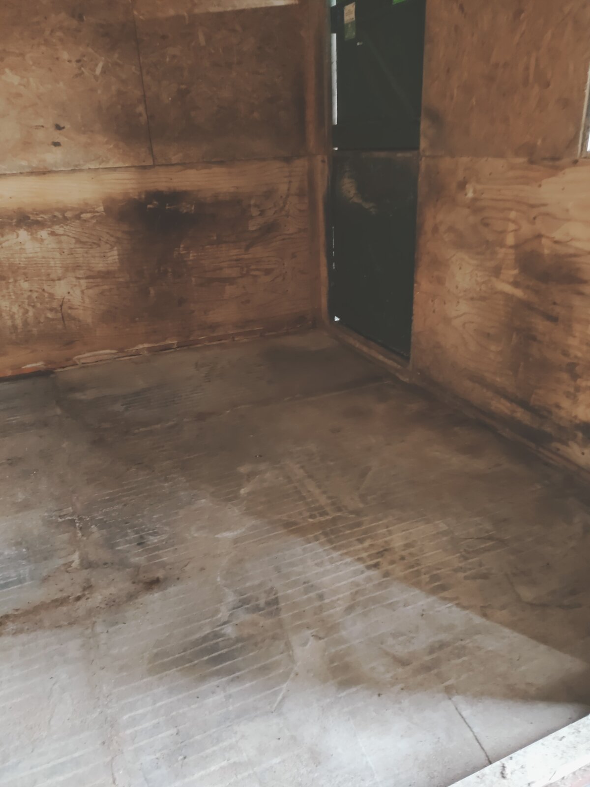

I have a stable that I would like to convert into a usable room. The floor is currently concrete, but I'd like a nice wooded floor.

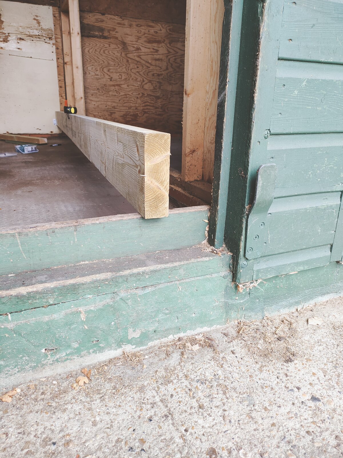

I'm looking at building regs etc, and it is saying a layer of DPM, then a gap of 150mm, then 6x2 joists (the span is about 3.2m)... All told this is making the floor so high off the current concrete. Do much so that a step will have to be build to enter.
Am I reading all this right?
I've attached some pics showing the rough height and how impractical it is.
Any thoughts greatly appreciated.
Many thanks,
Matthew
Could you fit the joist ends on joist hangars fixed to the wall, with an intermediate sleeper wall suitably protected from damp by a length of dpc underneath. That might reduce the thickness of joist you need as well. Don't know about building regs but it would seem to achieve the same outcome in terms of resisting damp ingress.
Blup
Can’t you float a floor?
granted it was a while ago, but a mate and I converted a detached garage to a recording studio. We applied a liquid dpm to the floor and then used a plastic membrane as well for backup. Then we used a rock wool insulation and floated a chipboard floor.
because of the studio’s requirements we glued the boards together but nothing was fixed down or was in contact to the sides.
Then we used carpet.
The studio is not classed as “habitable” I don’t know if you need “habitable”
The studio has been trouble free for the entire time and no issues with damp etc. it’s incredibly soundproof as we did all sorts to the walls and roof.

The floating floor options does sound like a good way forward.
