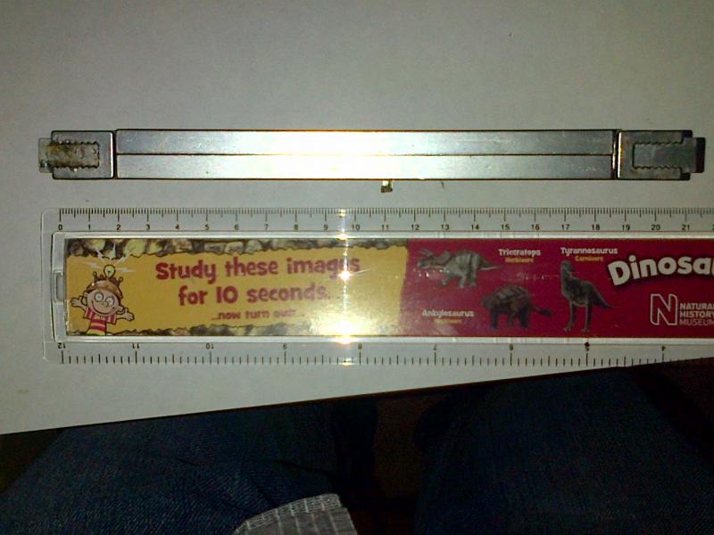

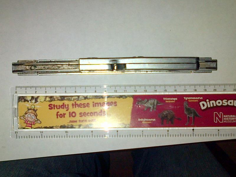

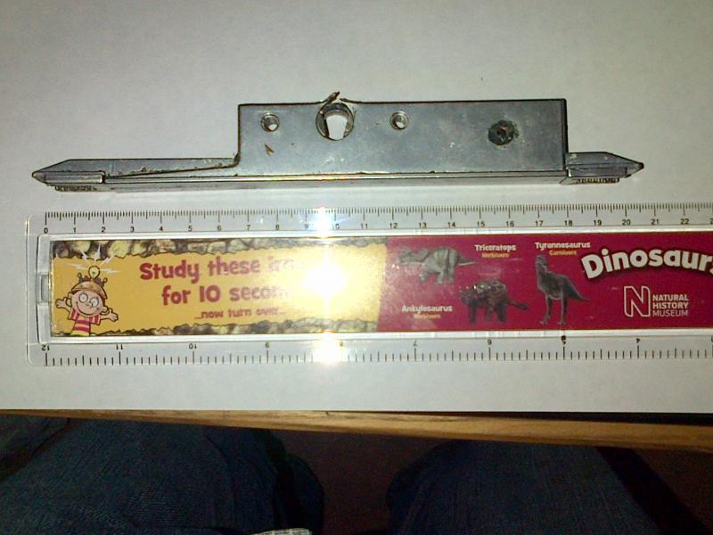

Had a broken window lock (window will not lock), took out the gearbox, its broken and it has been identified as a frameware gearbox, now obsolete. What can I do, will another gearbox fit/be made to fit, or do I have to replace the sash, or the whole window ??

Picture of the gearbox and what it operates would be good but yes generally you can Retro fit a different make
D'oh i know it operates a window :LOL: but i meant what does to gearbox connect to and operate, i'm assuming with the serated teeth (female) at each end it connects to some other sort of mechanism (male) most likely shoot bolts
Sorry, you are absolutely right. You can see from one of the photos the saw teeth female end that connects to a male rod on each side that pushes a bolt on either side of the lock into stops on the bottom side of the window

D G supplyline are spot on for parts, if you email them these photos I'm sure they'll have a gearbox that would work
just an update to close off this thread. First many thanks for all the advice. I found both dsgsupplyline ('[email protected]') and handlesandhinges ('[email protected]') most helpful.
to answer my question, you can fit a standard new mechanism by removing all the old ones parts and basically starting again. In the end I did not need to do anything as I looked in my lease agreement and the freeholder is responsible for fixing window bits, but I am a little more educated than before I started.
