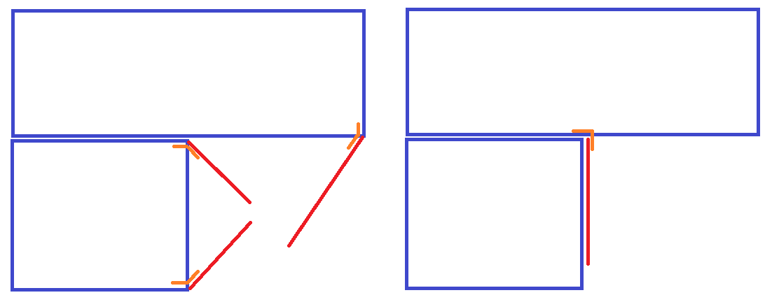

Corner wardrobe... left pic is current, right pic is intended.

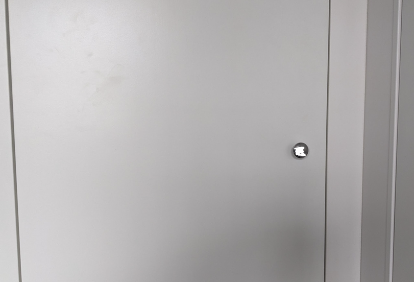

Currently the hinge opens on the right side of the unit, but I'm looking to try and swing it the other way because there's a bed so you have manoeuvre around the door once it's opened.

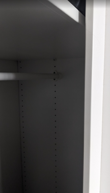

It's a DIY corner wardrobe made of IKEA PAX, so no corner post to mount a typical 110 cabinet hinge. Because of the way the wardrobe is done to have a wrap-around finish, I'd need the opposite pivot direction of a 110 hinge if that makes sense.
I've thought about a corner post but I can only visualise it looking bad, and possibly interfering with hangers.
Ah you mean swap the existing hinges in the same place with 165s so the door swings open more. Didn't think of that, thanks!
IKEA do their own 'corner hinge' so will save me likely drilling new holes in carcass.
