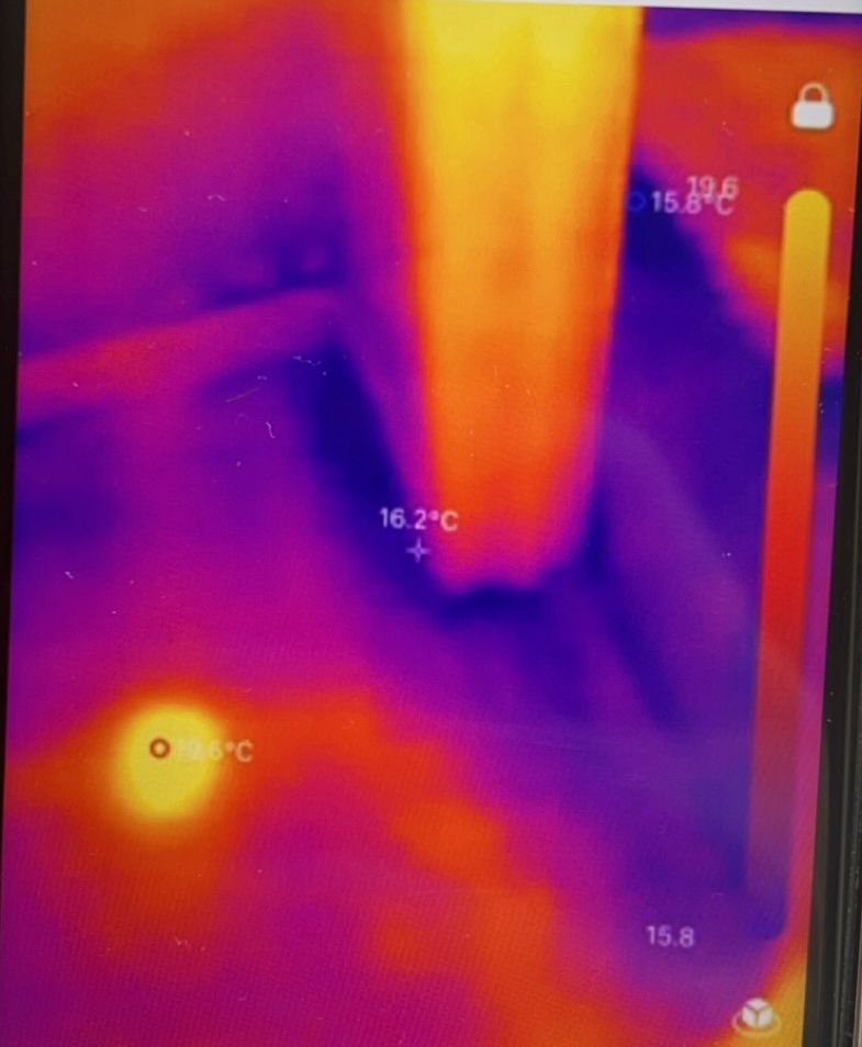

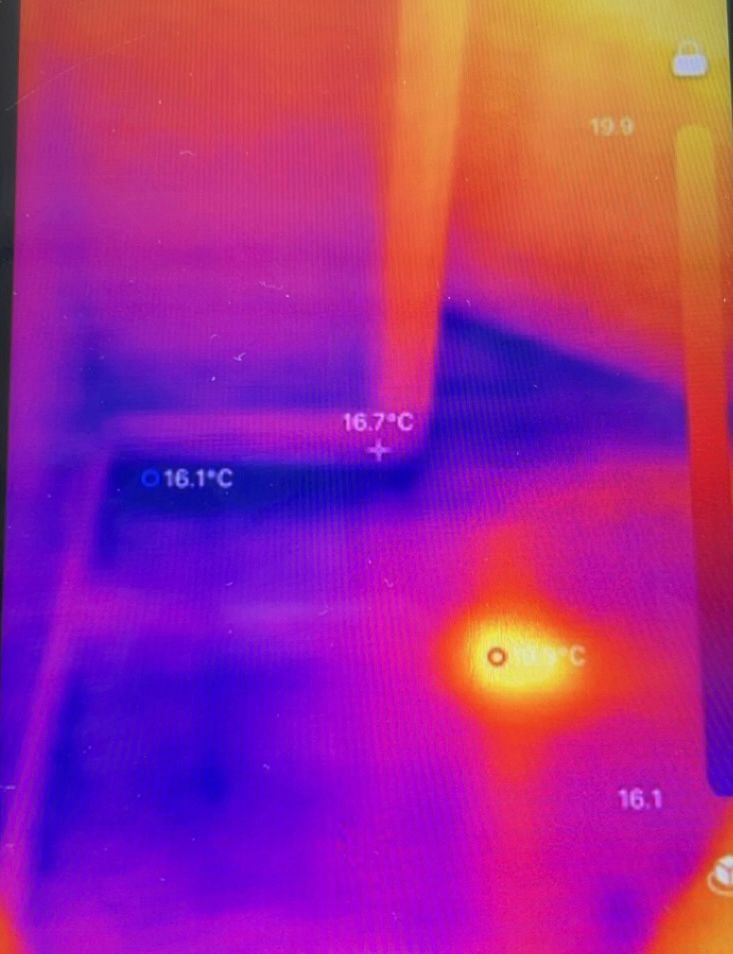

Does this look like a heating pipe leak?
15 Jan 2021
4
Hi,
I have some damp moving up the walls and the floor is risen in one place also.
I got someone to take a couple of pics with a thermal camera.
Does the brightly glowing circle look like it's a leaking heating pipe?
The blue circle is where the glow is on the thermal image and the red circle is where the floor is risen. The blocks behind the removed board are very damp.
certainly looks like it - heating pipes running through the doorway
