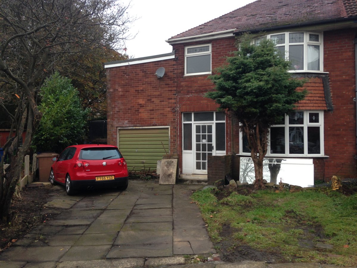

This is the house:
It's ugly, it looks like it has a super tall garage. We just want to make it look better with the roof extension and be plenty big enough for the 6 of us by doing the loft/dormer.

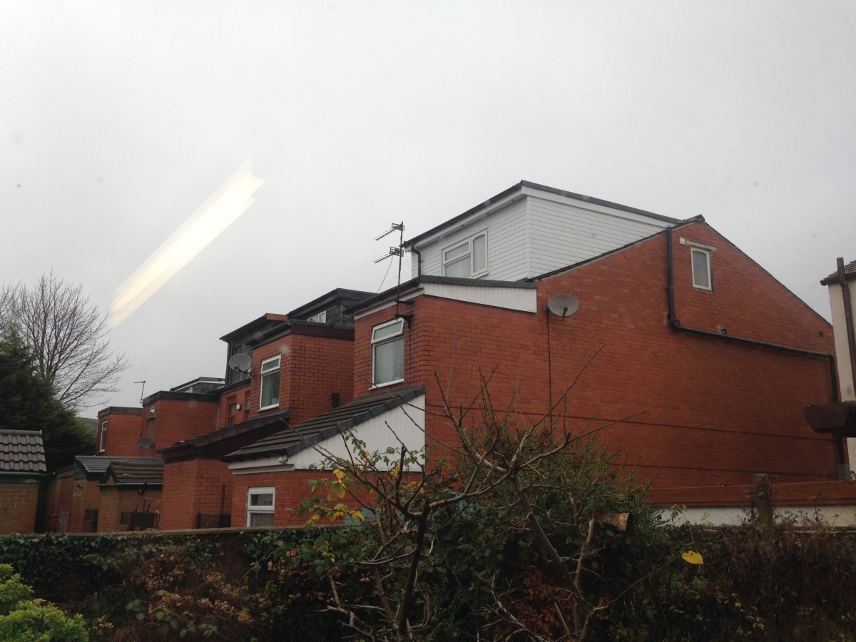

At the moment we have permission for the roof extension and I'm cracking on with the loft floor/bedroom ceilings. I feel like building 2 identical dormers with pitched roof's, one for the bedroom and one for the onsuite, making sure they are well within the 17.6sqm and then arguing about it later. There are so many dormers in the area its unreal.
From my grandmas house I can see 4 flat roof dormers, all different sizes, different materials, some level with the ridges, some very close to the eaves. Seems one rule for me, something different for everyone else.
