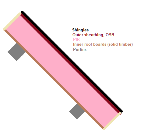

Our building has a solid wooden boarded roof (spruce planks).
We'd initially planned to nail shingles through 50mm PIR directly onto the roof boards, and had been advised this wouldn't need a DPM since the roof is warm?
But we are now leaning towards a 'sandwich' design with a frame and outer OSB layer on top.
Probably 75-100mm PIR, potentially more. Roof boards are 19mm, OSB specced at 18mm I think.
No air gap planned.
I am trying to figure out of we need DPM - is there going to be a condensation risk? Have had conflicting advice. If so, where should it go in my diagram? I thought the point of the insulation is it prevents an abrupt temperature gradient leading to condensation.
