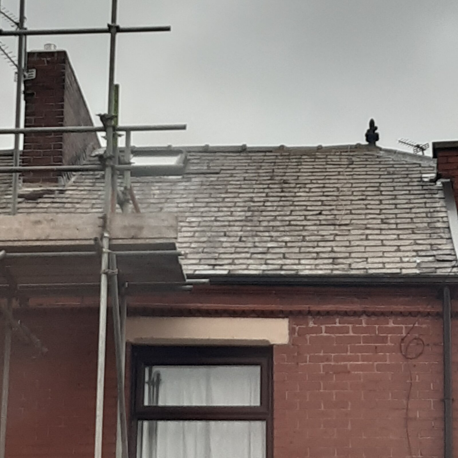

Hi, next door has some scaffolding up, been for around a year, they have just removed the upper section that went over the actual roof.
It looks like they have been working on the chimney on the left.
Just below it there's a dark area I can't make out what it is but looks unusual?
Also to the right of my roof window something looks a bit gappy, like it has lifted a bit?
Can anyone who knows about roofs have a quick look at the pic please?
Water is pouring off the end of my gutter to the right but I need to getup there and have a look at that.
If you don't draw on the photo, nobody will know what you are talking about. This is like playing spot the ball. Back in the days, neither me nor my gambling class mates could work out where it was.

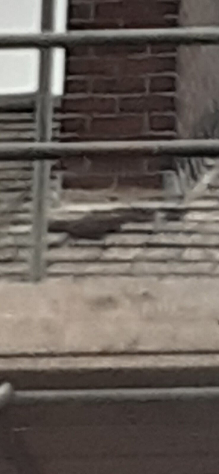

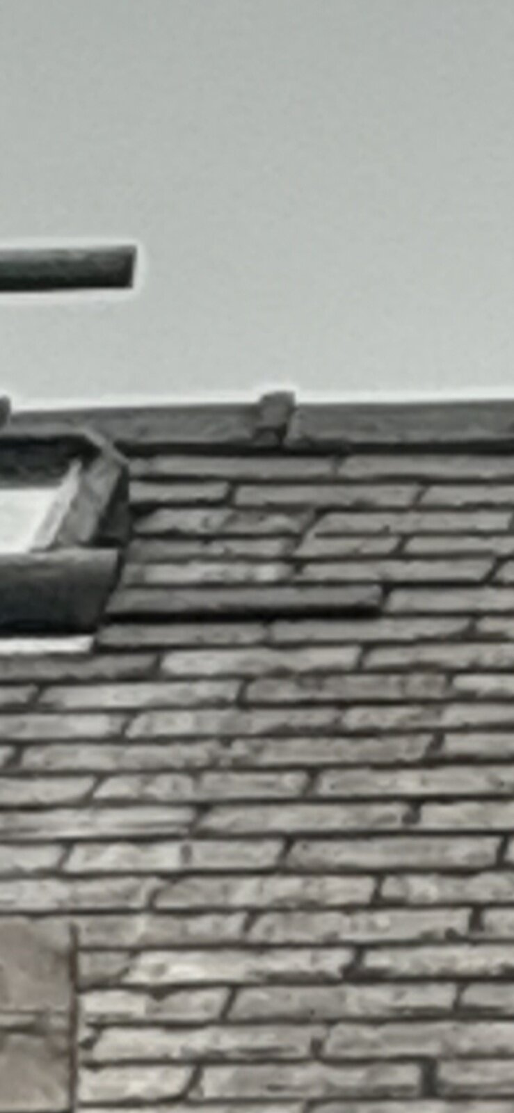

Thanks not sure how to do that but these are the parts zoomed in on.

Below chimney looks like just some debris.
The pictures are not sharp enough to look at the chimney area.
The skylight has a cocked skate and a half fitted poorly . And totally out of character of the original slate.
There are no other slate and a halves.
Just above that s&h there appears to be a split slate creating a straight joint which would leak a bit
To the right side at low level there is an early repair and just above that is a skate with a big corner off . Close by is a skate that appears snapped.
Higher up the roof at the abutment there are a couple of missing cut slates . So, some work required.
