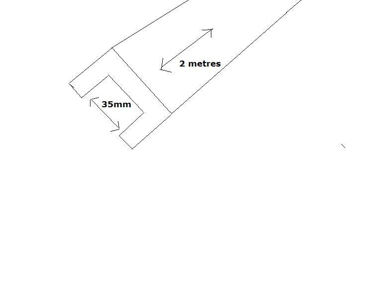

I am looking to fix a french door side panel to an internal wall. My idea was to have a wooden baton with a channel wide enough for the panel (which is the same size as a door) to simply slot into so it can then be screwed/glued.
Does such a thing exist? If so what is it called and would it be sold at the likes of B&Q or Wickes?
Here's a drawing to try and explain what I'm looking for
Thanks in advance for any input :)
You can get in a variety of materials, alumium, wood effect plastic etc or run a timber baton over a table saw to create channel.[Or use a router].

It's not going to be strong enough to hold the door sized panel by itself. it's going to need (at least) fixings of some sort top and bottom near the edge furthest from the wall to hold it solid. You don't give many details. What sort of frame is the rest of the door in? Could you fix the panel to that frame, seal down the gap, and run something like architrave down the wall joint, scribed if necessary to tidy up?
I've never seen any wood U section that big for sale, and if you have limited facilities it's going to be tricky to make up.
