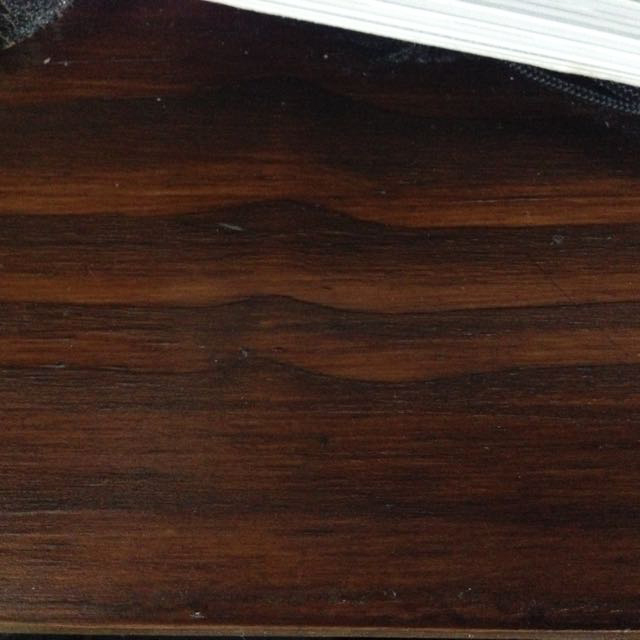

I have one other little thing that maybe you guys can help me with? I am staining English Oak, which is quite light wood, but I am looking to achieve deep brown colour with a slightly reddish undertone...something like on the photo attached (I used here Roslon 5 year wood stain - Dark Oak, which is no good if i want to print, so i cannot use it for my purpose)
I have tested so far:
Colron Wood Dye - Deep Mahogany
Mann's Oak wood stain - Jacobean
Mann's Oak wood stain - Dark Oak
Mann's Oak wood stain - Medium Oak
Mann's Oak wood stain - Rosewood
Mann's Oak wood stain - Chestnut
But none of them have given me this result...they are all either too greenish, yellowish, reddish or pinkinsh :)
So finally, my question is - would you know of a water based wood stain or dye that would give me similar result as on the photo - this deep brown with a tiny reddish, or warm undertone? You would save me a lot of testing ;)
