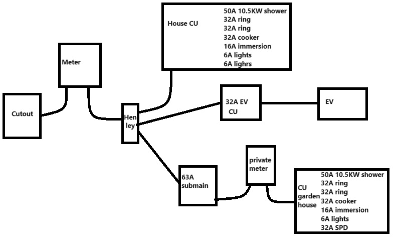

The question is simple: what minimum cutout fuse required for 2 family homes with solid fuel heating:
Does the EV charger have a grid limit function? and is there wiring in place to make use of it?
If as plugwash asks the EVSE has a grid limit function set to whatever the size of the supply fuse is, then that becomes irrelevant as that cant contribute to pushing it over the limit because it'll scale back as far as required to avoid that, so the only real worry left is the showers, if you assume 15 min showers, and the use is somewhat randomised, then perhaps we will assume overlap of use of both of them is not likely to exceed 5mins. A look at the time current curves for BS88 suggests that a load of double its rating will not take it out in that time, so thats 87.5A for the showers and another 32.5A averaged for the domestic loads in both properties (It'll peak above this when the kettle boils - but never for long). I'd reckon the 60A fuse will probably survive for years without trouble, dispite seeing somewhat regular overloads. A 40A one would probably have a supprisingly long lifepan, but will probably get taken out on a cold winter's night when its most inconvieninet.

Like @JohnW2 I also have a large house with flat below it, with a 60 amp DNO fuse, two kitchens, all electric cooking instent electric showers two of them, and the fuse has not blown, but that does not say that's the way it should be done.
Customer in garden house, as in the house built for relatives in the garden was cooking lunch and put the kettle on which went bang, no other significant loads. Main house was unoccupied so minimal load. He checked all round with a voltstick and called for EDF then called for sparks in case it wasn't a supply issue.
Second house 20 years old, and power has been good since then, CU upgraded to all RCBO last year due to a tripping issue. EV added couple of years ago and SM couple of months ago.
This was the first time the 40A cutout fuse blew, I'm assuming it was not downrated when SM fitted. Now been upgraded to 60A and waiting to be unlooped.
Because the future of homes is electric and 1 x 100A isn’t enough for 2 homes AND it avoids the eternal issues of one home billing for both and having to collect money
As it happens these 2 homes (being owned by the same family) appear to have worked in perfect harmony on a 40A fuse for 20 years and it was only a broken kettle lead that did the deed.
As to costs involved, sharing a meter saves circa £100 per year. As to cost of getting a new supply laid on was £6K when the house was built
