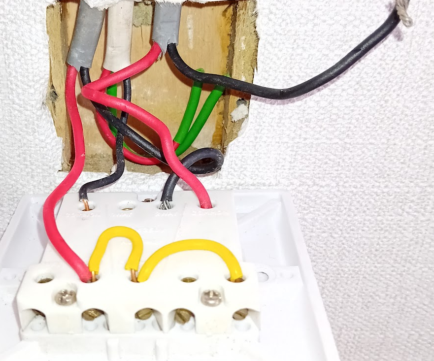

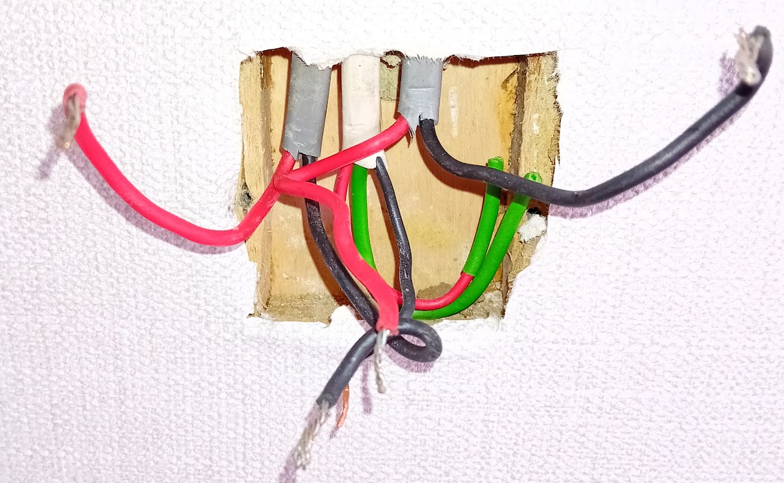

With the power on I didn't expect to find this by the other hall door:
Nor did I expect to be told this switch has the same functionality as the other 2.
Nor did I expect to be told the black on the right was tucked behind the 3 sheathes.
"I did get it so the middle switch also controlled the other 2."
LED screwdriver soon found the left red was showing as live and from there the 3 at the bottom showed 240V without any variation as other switches altered.
I have sorted it but what would others do next?
So the other two switches have their desired functionality with everything open at this point, only four conductors in use, one shows as being live and it reads 240v to each of the three others as if there is some sort of path back to neutral through a load.... Well I'm guessing then that its going to be something like theres a live feed comming in, and three switch wires out to changeover relays acting as one end of the two way arrangement. Which are probably not installed in a suitable manner for fixed installations because they were likely soldered in a haphazard way and glued inside a tobbaco tin in the far end of the loft circa 1982 by some model railway enthusist. There will probably be some hieroglyphics on how he has wired it along with a good few stubbed out fag ends

I looked at one switch and it had 2x T&E, one wire connected as a common to all 3 gangs.
This worked, but I did tidy the exposed copper:
The yellow links were retained from the original switch and matched those in the other switch.
Close enough. It is a CU containing DIN rail mounted low profile relays, Way up high in one of the kitchen wall cupboards. I didn't investigate but I suspect the relay contacts were wired like 2 way switching. What I could see of the wiring through the front open slot and clear flap it looked a bit 'thrown in' but I don't think any worse than many CU's. It's a wide plastic unit about half full which I suspect had been their mains CU.
