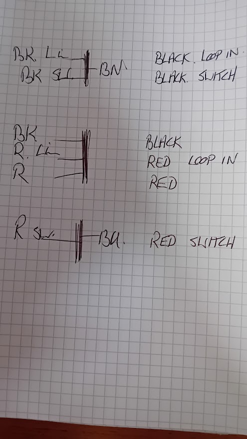

Tenant demonstrated instant tripping when RCBO reset, test label on CU and copy of EICR dated Feb 2024. Very standard loopin at rose wiring by 3x 3/0.029 twin (no E) except the last with only 2. 2 fittings had; 2x red + 1x black in 'loop', rest had all red in 'loop'.
We started on the living room as closest to CU and found this;
the scrawl on left being my notes the capitals on right being legible. Assuming it was first on the system it didn't explain the tripping.
We changed tack and identified the 5 switch drops and were going to reconfigure to suit but decided to identify every wire to ensure against the unexpected; All 5 fittings were incorrectly wired.
We were there for under 2 hours, I hate to think how long it would have taken a DIYer coming on here for help to resolve.
